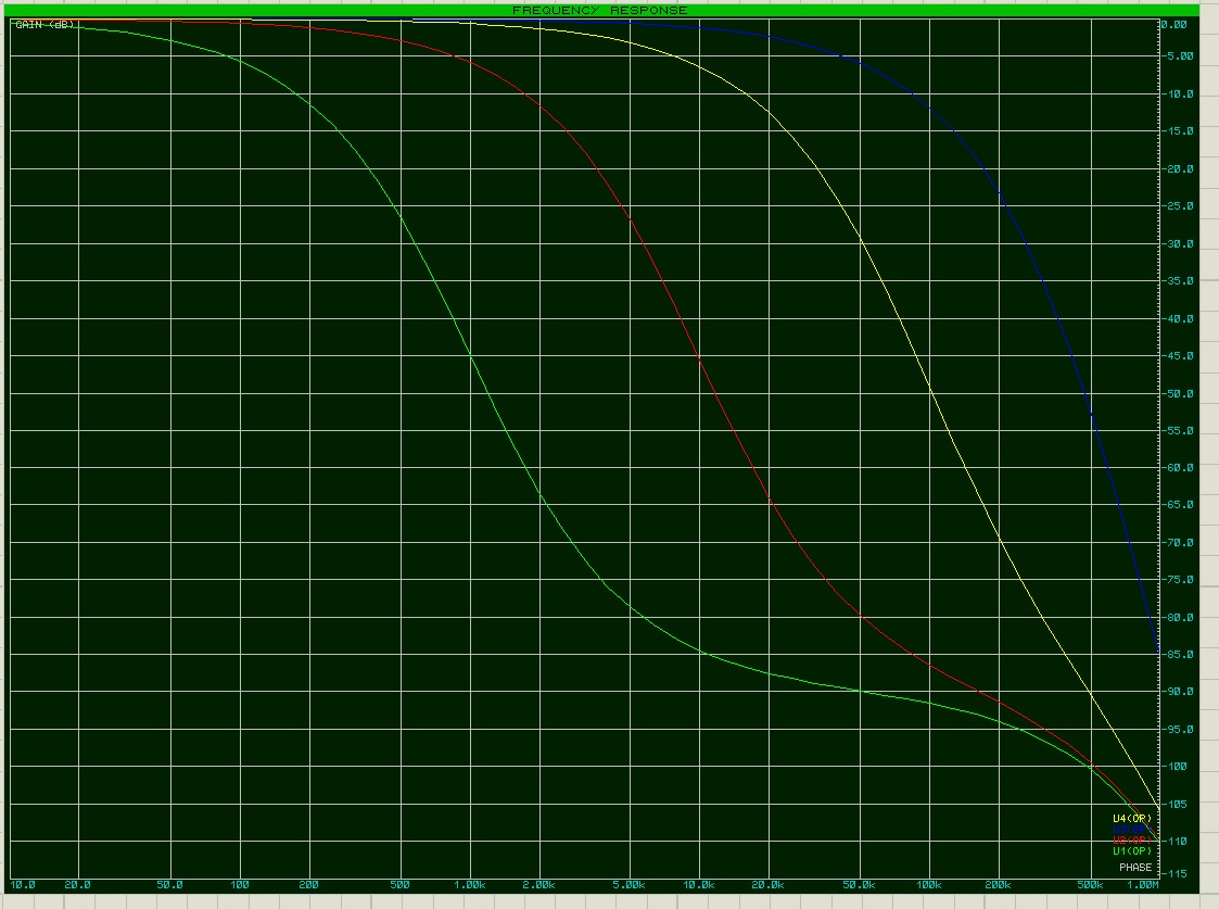

JimL Posted July 23, 2016 Report Posted July 23, 2016 1 hour ago, kevin gilmore said: I posted this over there, will post here. if I had time I would find to do a way to do the graph that shows frequency response relative to output voltage, maybe in a few days if people don't get it so here is how this works Required Slew Rate = 2 x π x Frequency x Peak Voltage x K we can argue about K later, different people have different ideas about the value.The load is a capacitor and it takes a particular amount of current to charge/discharge the capacitor at a particular frequency and voltage. Lets reference the maximum peak to peak output voltage of the amplifier at 1khz as 0db. Now lets calculate what amount of current is needed to do 20khz at 0db at the same peak to peak voltage into one standard headphone load, 120pf Now lets figure out (and this part gets complicated) how much more current is needed to guarantee .01% thd at 20khz at 0db. taking into account the open loop gain. Its clear that some of my earlier amplifiers with output currents in the range of 5ma to 10ma cannot do full voltage swing at 20khz. But will do a full flat frequency response at less than full voltage swing. So the question is how loud do you listen and how much actual audio content is at 20khz relative to 1khz. It is my opinion that 20ma however is enough to do full voltage swing even with 500V power supplies. There is no free lunch. Absolutely agree as a technical matter that being able to swing full voltage at 20 kHz is better than not being able to. The SRX Plus, for example, is not able to do so, and in fact, as I posted in that thread, actually measurably rolls off at lower frequencies as the output voltage increases (it's flat at 100 VRMS to over 20 kHz which is pretty loud, though). BTW, KG's calculation is actually a minimum estimate of the current required, because a stat headphone is not a capacitor - it makes NOISE, e.g. music, which means it has to consume ADDITIONAL current over what a capacitor requires. However, as Dr. Gilmore points out, the question is, how loudly do you listen and how much actual audio content is there at 20 kHz. There is actually some data on the latter point. A number of years ago, Peter Baxandall and Nelson Pass both measured slew rates in recorded music and both came to similar conclusions, namely that an amplifier capable of reproducing a 6 kHz sine wave (yes, 6 kHz, that is not a misprint) with low distortion is adequate for music signal, because of the natural roll-off of musical instruments. Note that this was equivalent to the fastest music signal they found, and that everything else they measured was SLOWER than that. More recently, Baxandall published that he had found a recorded music signal that required an amp to be capable of reproducing a 15 kHz sine wave with low distortion. That is significantly faster, and in fact is within striking distance of the 20 kHz signal at full output voltage requirement - however, it must be noted that this is a unique event, and for almost all music the lower requirement is adequate. Is it appropriate for a state of the art amplifier to aim for the more stringent requirement? Absolutely! Will the lower requirement suit the needs of most? Probably. Of course, extra headroom is always nice - but there is a cost. For Stereophile Class A, the cost is always worth it, almost by definition. For Stereophile Class B, the question is, how much can you cut back for as little sonic cost as possible. Finally, if you listen at lower levels, the requirements decrease accordingly. This is why spritzer suggested to Tyll that he listen to electrostatic headphone amps at high levels to differentiate between them - because this stresses the amp the most. 8 Quote

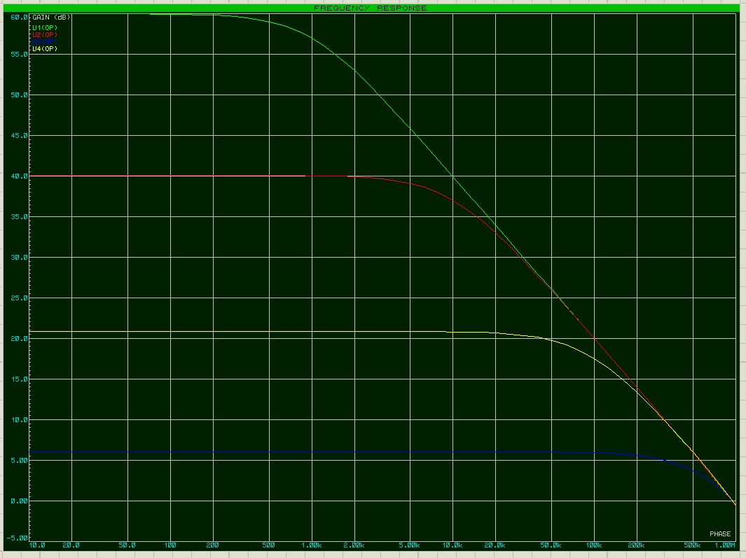

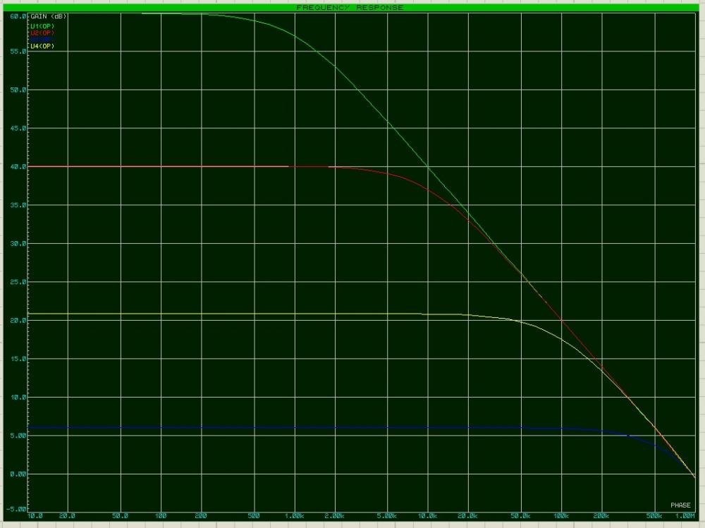

kevin gilmore Posted July 23, 2016 Report Posted July 23, 2016 (edited) are you completely out of your mind, that would take me a week. ok, here is something quick that gives you the idea 4 x lm741 at different gain levels why it looks like crap and the background is not black, not sure and resulting phase Edited July 23, 2016 by kevin gilmore 2 Quote
spritzer Posted July 23, 2016 Report Posted July 23, 2016 This shows just why some of these amps sound like shit. A combination of low current, low voltage and bad current sources will change how they sound quite dramatically. Quote
PretentiousFood Posted July 23, 2016 Report Posted July 23, 2016 (edited) Is that the FR of with different amounts of feedback? If you keep feedback constant, I think it just clips, rather than rolls off gracefully. Here's a sim of an ES-X sort of deal. I stepped the source amplitude at 100mV, 1V, and 10V (some people have silly DACs). The EL34 (6CA7 in sim) is at 6mA and rails are +/- 400V, 120pF load. Happy to try different parameters. FR does not seem to change in the magical ideal world of Spice? http://imgur.com/a/2uglC Of course, the current requirement into the load increases with frequency and signal level. The blue line crosses at 10mA, and shows the frequency at which current limiting would occur for different amounts of voltage swing. http://imgur.com/qh0esa3 However, output distortion gets gross well before clipping. At 1 kHz: http://imgur.com/vJAiMyW This shows clipping into the rails. And at 10 kHz: http://imgur.com/u1sD8ze Waveforms: http://imgur.com/UYLhk9W This one shows current limiting. Edited July 23, 2016 by PretentiousFood whoops, wrong graph 2 Quote

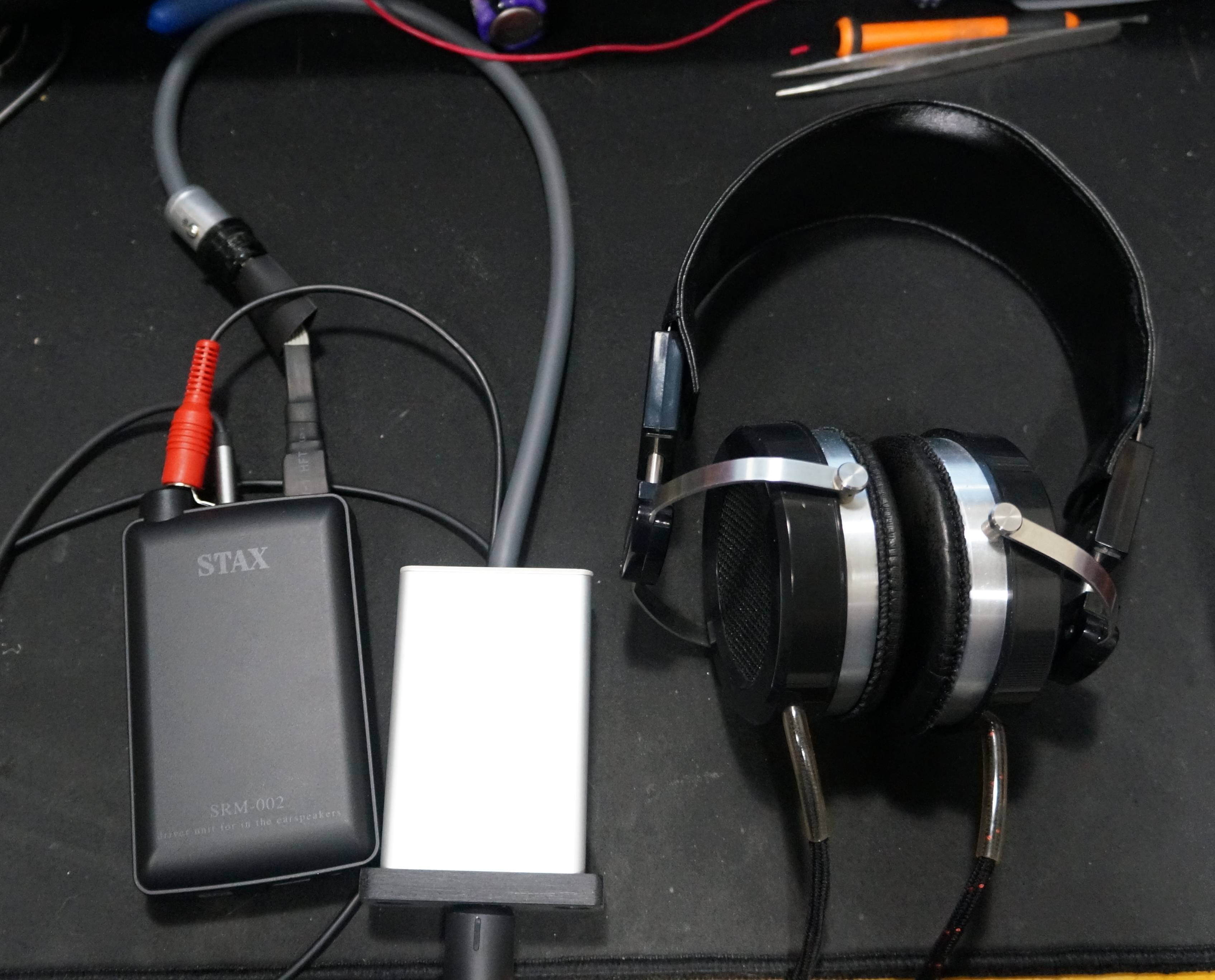

Arthrimus Posted July 25, 2016 Report Posted July 25, 2016 (edited) I've been listening to my SRS-002 system these past few days (thanks @justin ) and I have to say these little things rock! I've put probably 20 hours of listening time in at work and I am digging them for sure. This is the best portable setup I've heard, and at the price I can't imagine you could do much better. Fit is not an issue for me thankfully! Now for something stupid. I couldn't leave well enough alone so I made a full size Stax adapter and sampled some of my other phones on the SRM-002. It doesn't have the guts to properly drive any of my Lambdas (obviously) but it actually does surprisingly well with my SR-X Mk3. What you see there is my SR-X Mk3 -> Pro Bias to Normal Bias adapter -> 5 pin Stax to mini Stax adapter -> SRM-002. This was done for kicks of course and is not to be taken seriously. In a few days I will be building the much more useful reverse of this adapter so I can use my SR-002 on my SRM-727. Edited July 25, 2016 by Arthrimus 1 Quote
