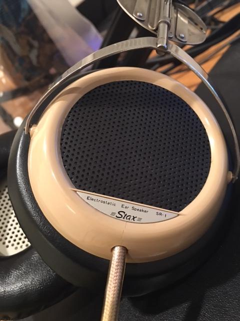

ALSO Posted July 16, 2016 Report Posted July 16, 2016 Just picked up a set of SR-1s and was curious to know what the experts think of them. To me, they sound as I expected, not as developed as more modern STAX but remarkable nonetheless. Wanted to post pictures but am limited on my account. Quote
spritzer Posted July 16, 2016 Report Posted July 16, 2016 Just post the pics somewhere and link to them, imgur for example. I have three different SR-1's and I like them all but Stax has certainly made better. It's remarkable how long they do last and two of mine fire up instantly. The third one needs some work but it shows how electrostatics do last. I spent a few hours yesterday listening to my Quad ESL57's which were made in 1968 and are 100% original except the PSU and crossover parts were refreshed a couple of years ago. Keep them out of the sun and they will outlast any cone speaker... 1 Quote
ALSO Posted July 16, 2016 Report Posted July 16, 2016 Thank you Spritzer, I am also amazed by how well they hold up, and how good they sound, in spite of everything. Haven't seen too many available, so was happy to have this chance to hear them. Will post photos soon. Quote

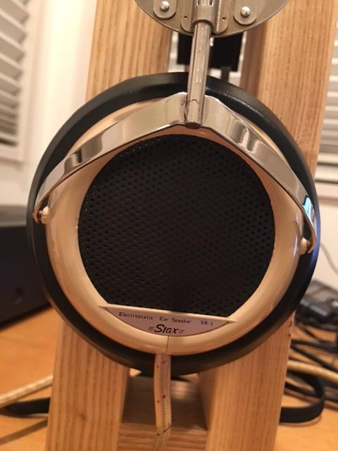

ALSO Posted July 16, 2016 Report Posted July 16, 2016 Thank you for this information, what features signal the particular version? Quote
spritzer Posted July 16, 2016 Report Posted July 16, 2016 This one has most of the parts of the SR-2 and SR-3 so a late one. The early ones are very different, quite a bit smaller and made from very different materials. Quote
ALSO Posted July 16, 2016 Report Posted July 16, 2016 Thank you Spritzer. A big difference in sound between the earlier and later versions? To me the SR-1 sounds like a more primitive version of but very similar to the SR-3. Quote
spritzer Posted July 16, 2016 Report Posted July 16, 2016 There is a difference in the sound but also in what earpads should be used with them. I would also recommend refurbishing them as there are some things in the cups that might require attention. Quote
ALSO Posted July 17, 2016 Report Posted July 17, 2016 The ear pads on my set look relatively new, so they may not be original. Best to refurbish regardless? Quote
DefQon Posted July 17, 2016 Report Posted July 17, 2016 That one looks quite clean. Most SR-1's I've seen including my own are darkened yellow due to exposure to UV. Though I do have one of the earlier versions. 1 Quote
spritzer Posted July 17, 2016 Report Posted July 17, 2016 One of mine actually shipped in that yellow color as they are like that on the inside as well. The baffle on the other hand is the SR-3/5 color and shows no discoloration. As for the earpads, the first SR-1's had earpads similar to the HE90/HE60. High and thin 1 Quote
