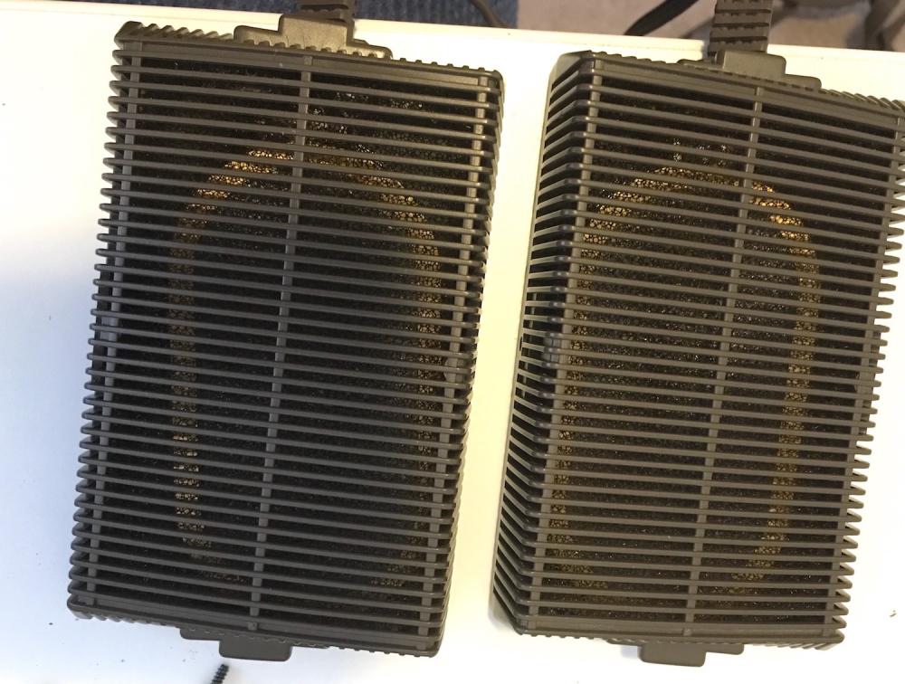

oogabooga Posted April 25, 2016 Report Posted April 25, 2016 How normal is it for LNS drivers to be off-kilter? I just received a pair and the left driver looks fucked up. I removed the four screws on the driver to try and get a closer look, but I wasn't able to pull the driver/back plastic apart (didn't want to use too much force) - not sure if a previous owner glued em on. FWIW google turns up other LNS's that look like this: http://www.ebay.co.uk/itm/RARE-STAX-LAmbda-NOVA-Signature-/141886669059 Quote
spritzer Posted April 25, 2016 Report Posted April 25, 2016 The glue that either holds the drivers to the baffle or the protective mesh to the drivers has failed. Only way to fix that is to take it all apart very gently, clean off the nasty glue and reglue it all. The glue they used back in those days is just horrible so the baffle is just stuck to the case due to that. Use some force and they will break apart. I did this exact thing last week when I fixed a really old SR-404. 1 Quote
catscratch Posted April 25, 2016 Report Posted April 25, 2016 (edited) Just be careful when doing this, because I had a pair that had the same issue, and when I tried to take it apart, the dust cover came off one of the drivers, and when that happens, they'll probably squeal from then on, unless you do it in a dust-proof cleanroom. Edited April 25, 2016 by catscratch 1 Quote
