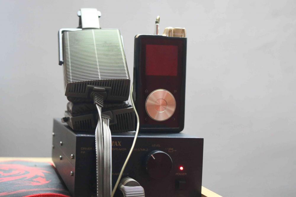

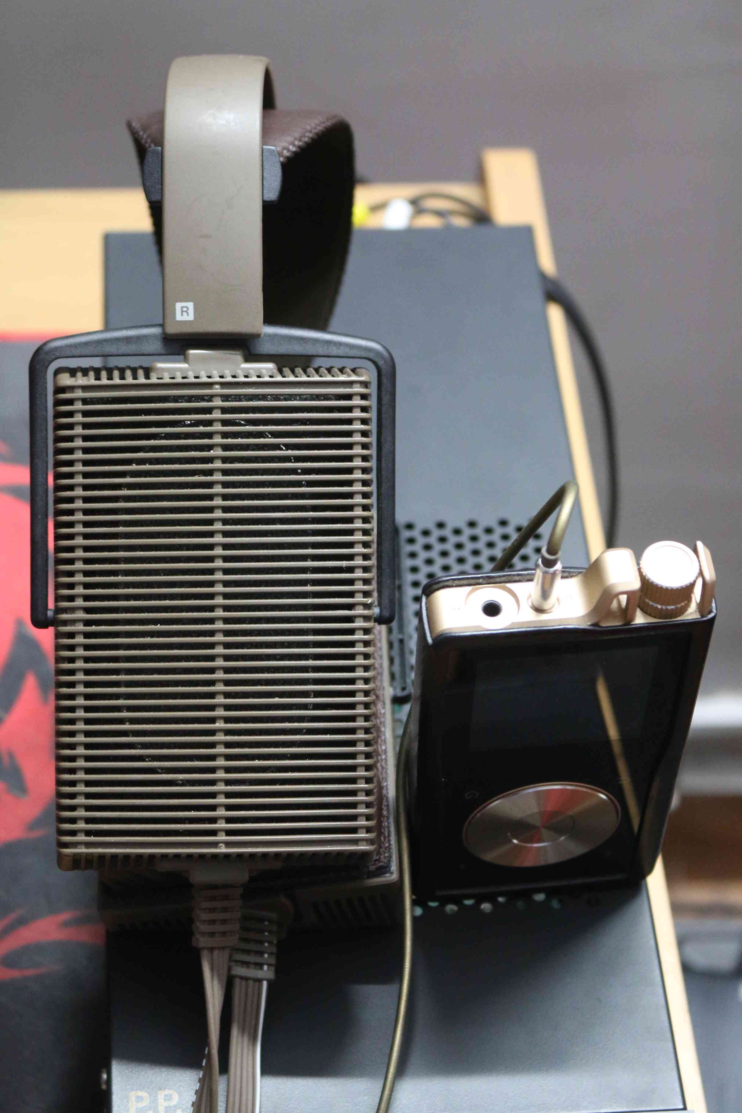

xEcuToR Posted April 11, 2016 Report Posted April 11, 2016 Got my first Electrostatic setup (Stax SRM 1/MK 2 [Spritzer Mod] + Stax SR 407) and I've got to say Stax SR 407 has quite a bit of bass (More than I was expecting to be precise), in fact it has more bass than the AKG K340. Jazz, Western Classical, Folk, Indian Classical, Blue Grass seem to have a good pairing with this combo. Currently setup 3 is my favorite which is closely followed by setup 2. Setup 1- PC +J River 21 + Resonessance Labs Concero HP Setup 2- Macbook Air Haswell + Amarra Symphony + Resonessance Labs Concero HP Setup 3- Questyle QP1R 1
