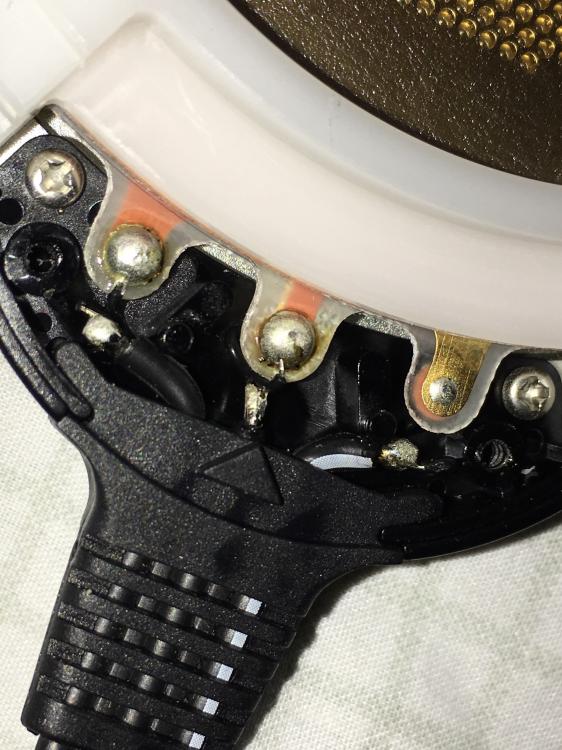

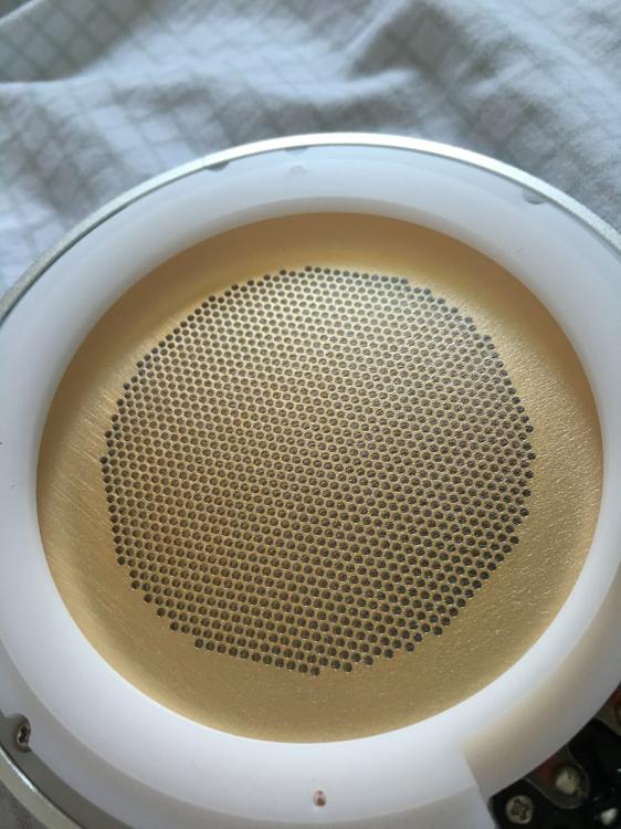

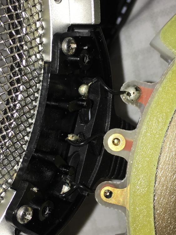

kugino Posted November 7, 2015 Report Posted November 7, 2015 (edited) opened up the left earcup, looked fine, put everything back together and imbalance still there. some pics:i'm assuming if the connections were bad no sound would be coming out, right? Edited November 7, 2015 by kugino Quote
chinsettawong Posted November 7, 2015 Report Posted November 7, 2015 Use a miltimeter to check the solder points with the pins to comfirm the cable too.Sent from my SM-N9005 using Tapatalk Quote
spritzer Posted November 7, 2015 Report Posted November 7, 2015 Yeah, you need to measure it as there is no way to tell from the outside if those tiny wires are intact. Quote
