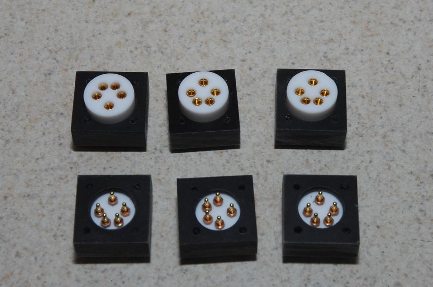

Les_Garten Posted February 5, 2010 Report Posted February 5, 2010 I feel like Newman hoarding Victoria's secret Catalogs! Quote
mypasswordis Posted February 5, 2010 Report Posted February 5, 2010 Sexy Although you oriented the top left and the bottom middle one wrong. [/pedantry] Quote
Les_Garten Posted February 5, 2010 Report Posted February 5, 2010 Sexy Although you oriented the top left and the bottom middle one wrong. [/pedantry] Wait till you see me build something! Quote
spritzer Posted February 5, 2010 Report Posted February 5, 2010 Great connectors but make extra sure you don't short out the wires with a stray strand. The R- and bias pins are pretty close together... Quote
mypasswordis Posted February 5, 2010 Report Posted February 5, 2010 About plugs and jacks. I'm a bit annoyed that the tolerances aren't better on Stax-made Stax stuff. The older model headphones fit great on my SRD-7SB but are loose on the SRD-7, and the Lambda Sig plug is slightly too big for the 7/SB and good on the 7. Whatever, it's not too much of a big deal. Quote
Les_Garten Posted February 5, 2010 Report Posted February 5, 2010 Great connectors but make extra sure you don't short out the wires with a stray strand. The R- and bias pins are pretty close together... Good point. You could use heat shrink, but that would cover up the pretty pins. Quote
spritzer Posted February 5, 2010 Report Posted February 5, 2010 I'd recommend heatshrink but it was hard for me to use since I had two wires on each pin, the wire from the tubes and then a loop out to the Fischer socket. Solid core wires would also be a good choice here... Quote
Beefy Posted February 5, 2010 Report Posted February 5, 2010 Great connectors but make extra sure you don't short out the wires with a stray strand. The R- and bias pins are pretty close together... The 6-pin variant is even more fun I removed all of the outer pins, did the centre pin first, and made sure for the outside pins that all the wires were actually towards the outside. I used 22AWG Belden wire and a decent length of heatshrink, and it ended up a nice clean job, and very secure. Quote
Les_Garten Posted February 5, 2010 Report Posted February 5, 2010 I'd recommend heatshrink but it was hard for me to use since I had two wires on each pin, the wire from the tubes and then a loop out to the Fischer socket. Solid core wires would also be a good choice here... The 6-pin variant is even more fun I removed all of the outer pins, did the centre pin first, and made sure for the outside pins that all the wires were actually towards the outside. I used 22AWG Belden wire and a decent length of heatshrink, and it ended up a nice clean job, and very secure. Through my powers of inductive reasoning here, it looks like it is best to solder the Jack first, then install in the chassis. Solid core does sound attractive here. Quote
Beefy Posted February 6, 2010 Report Posted February 6, 2010 Through my powers of inductive reasoning here, it looks like it is best to solder the Jack first, then install in the chassis. Solid core does sound attractive here. Yes, absolutely before it goes in the chassis I can't imagine solid core being that much better. I twisted tightly and tinned, and had no problems at all. Quote
spritzer Posted February 6, 2010 Report Posted February 6, 2010 Solid core has the advantages of being a single strand so easy to spiral onto the pins and make a very secure connection. Ohh and you are wusses for not doing this all with the socket mounted in the chassis with no real access to it... Quote
