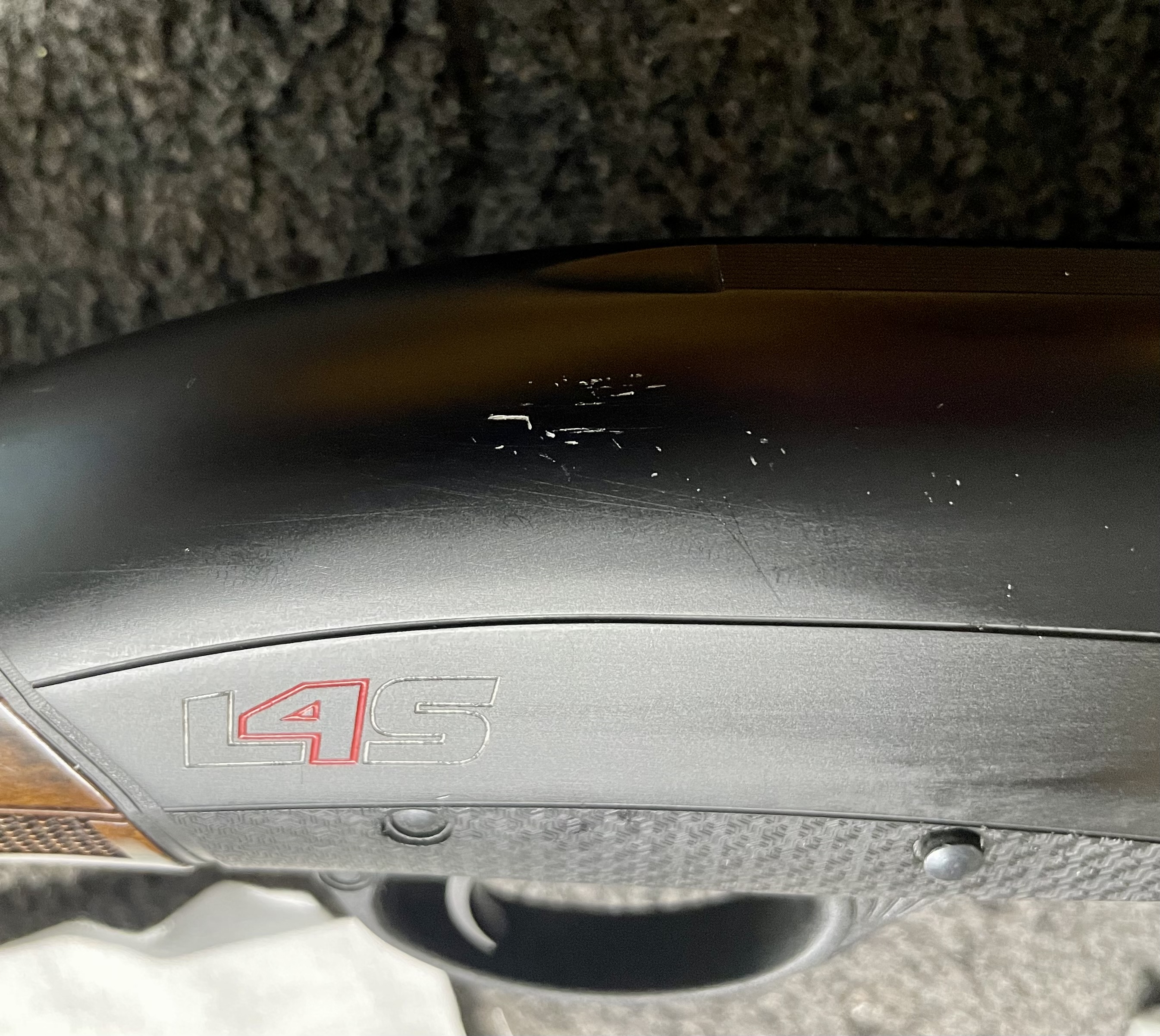

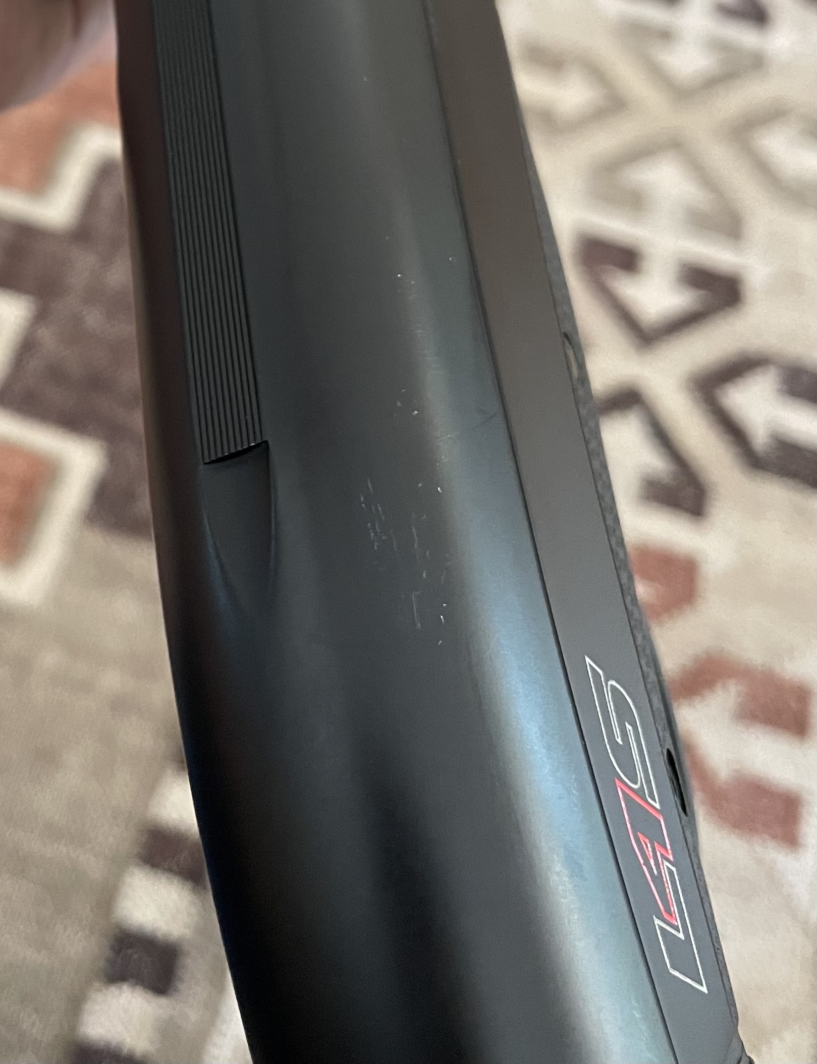

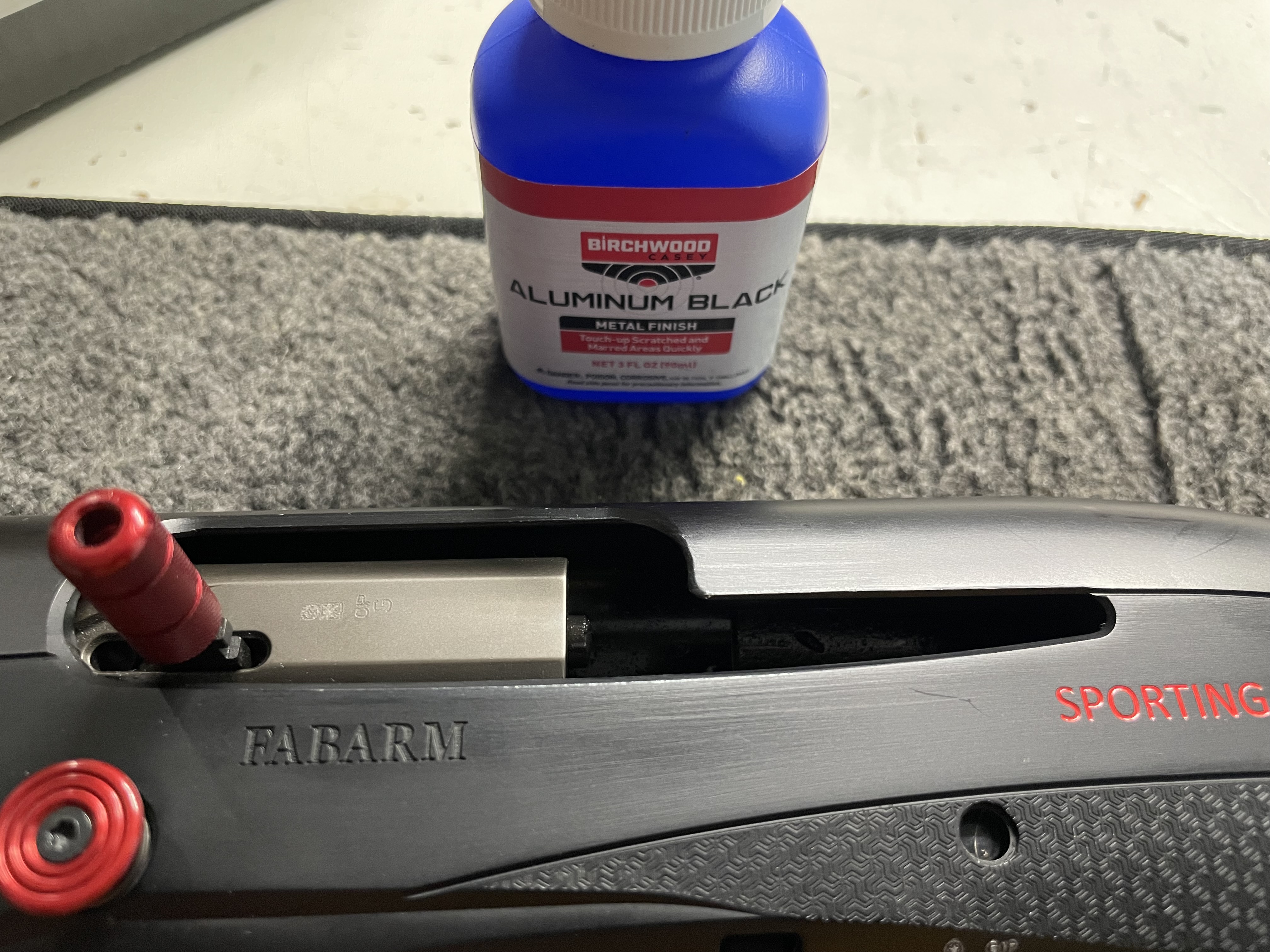

Not sure if anyone has used this stuff to touch up the inevitable scratch during DIY or perhaps to infill, but it seems to work pretty well! No before pictures from all the loading port area, but a tough area on the top where there is a matte finish..

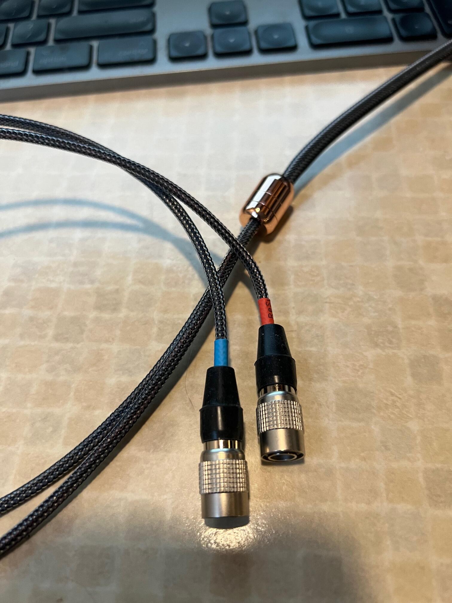

I am looking for about 50’ of a really nice wire covering for use in some speaker cables I am building. Maybe a white color in a nice cotton or similar texture. Any suggestions?
I liked the sleeving I bought from a place called Titan Rig. Can't recall where I found them recommended, but it is softer than any of the parachute cord, etc. that I have gotten before.
Thanks! How would you describe the covering, is it more like techflex or more like a fiberglass cloth covering?
It's more like tech flex. This is what I used what I ordered on.

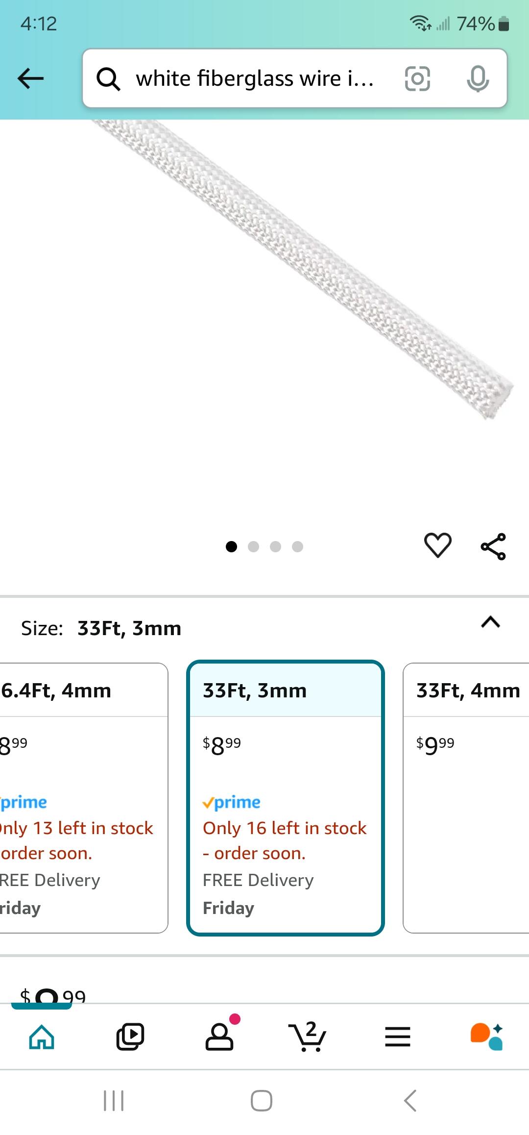

Diameter?  I might have a spool in a closet at home.
Thanks!
Pars, I'm looking for something more like a fiberglass covering. I'd even consider sort of a cool vintage look / pattern.
