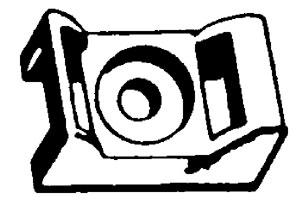

Looser101 Posted October 19, 2010 Report Posted October 19, 2010 How about using a nut and bolt on one of these? [ATTACH=CONFIG]3784[/ATTACH] Spectro Wire and Cable: Mounts for Cable Ties

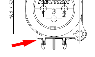

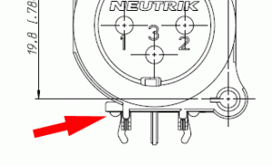

luvdunhill Posted December 9, 2010 Report Posted December 9, 2010 and one more question... how the hell do you know how far off the PCB the center of the large mounting hole is for these? Neutrik - Audio - A Series - NC3MAH-0 I suppose you have to load the DXF file? bah. I don't have a way to do that...

dsavitsk Posted December 9, 2010 Report Posted December 9, 2010 sure. seriously though, I cannot believe that dimension isn't on the PDF. how lame. It looks like 12.5mm to me ...
luvdunhill Posted December 9, 2010 Report Posted December 9, 2010 It looks like 12.5mm to me ... I'm pretty sure that dimension is just the distance from the center to the outer edge of the mounting hole. If you then look at the far left diagram, the PCB seating plane looks higher than that.
dsavitsk Posted December 9, 2010 Report Posted December 9, 2010 The mounting hole has depth, so unless you are cutting a gouge in the PCB to accommodate it, then the board can't be any higher. Also there are some little feet on the other side that are at the same level as the edge of the mounting hole.
studeb Posted December 10, 2010 Report Posted December 10, 2010 those feet run the whole way front to back on both sides the lower mounting hole overlaps the PCB by a bit If you print it you could measure it, wouldnt have to be 1:1 either, plently of dimensions there
studeb Posted December 10, 2010 Report Posted December 10, 2010 got up off my ass and did it my guess is 8.26mm to pin 3 2.32mm from the pcb top to the lower mounting hole and 9.80 from the lower hole to the middle of the 22mm cut out so 12.1mm from the PCB to the middle of the 22mm cutout how precise do you need it?
