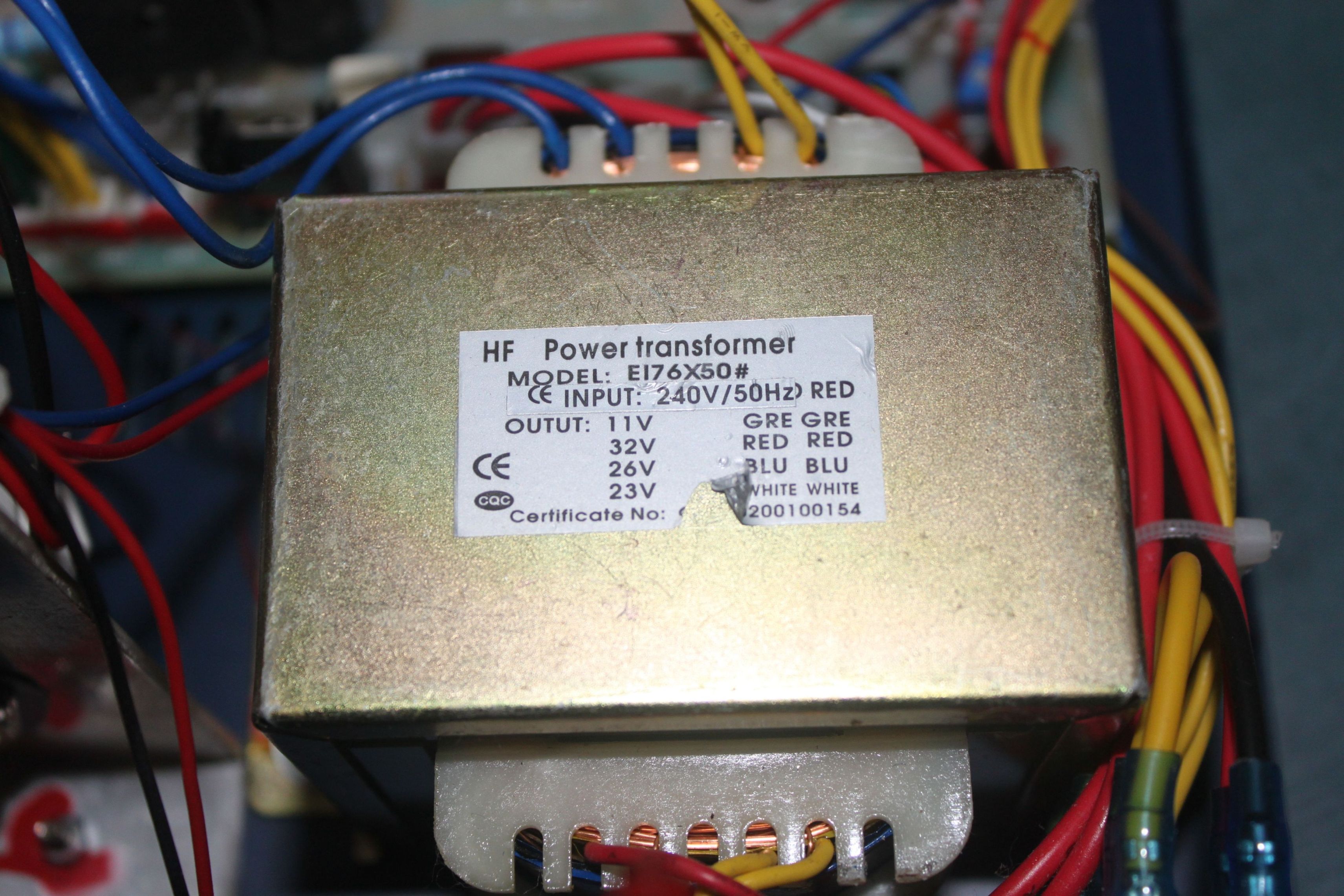

mypasswordis Posted August 5, 2017 Report Posted August 5, 2017 Midway through heat gunning some SMD components the station straight up died. No lights or anything. I opened it up and am measuring nothing across the transformer primaries even though I checked the power switch and fuse are working. Never had this happen before. Wut do? Quote
spritzer Posted August 6, 2017 Report Posted August 6, 2017 Never seen that happen. Was it one of those cheapo hot air systems? Quote
kevin gilmore Posted August 6, 2017 Report Posted August 6, 2017 who made the thing, and inside pictures please. likely the thermal fuse inside the transformer went open, may be able to short it out. Quote
mypasswordis Posted August 7, 2017 Report Posted August 7, 2017 I got this cheap junk: http://www.ebay.com/itm/3-in-1-853D-SMD-DC-Power-Supply-Hot-Air-Iron-Gun-Rework-Soldering-Station-Welder-/381253195679?hash=item58c476179f:g:XAcAAOSwImRYWK8A It actually looks fairly okay on the inside (see pics below) but I tried locating a thermal fuse on the transformer and wasn't sure where to look. There does seem to be a PLUS version with a case fan, which does seem indicative. Can't use camera right now (long story) but here are some pics which are basically what mine looks like on the inside: http://voltaicforge.com/electronics/wep-853d-clone-soldering-station/ and the transformer looks like this: Quote
