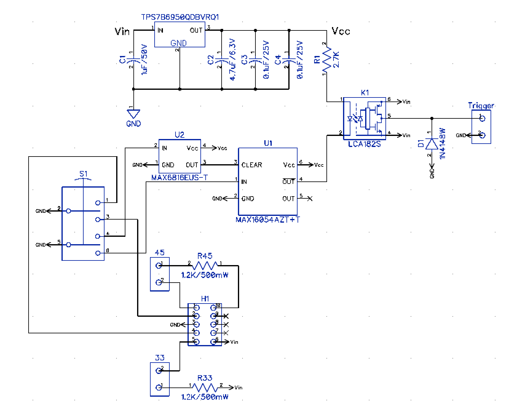

luvdunhill Posted February 28, 2017 Report Posted February 28, 2017 Just curious, has anyone ever used any hardware switch debouncing before? I realize this is 100% unnecessary / overkill in this situation, on all kinds of levels, but I am going to play around with a few of the Maxim chips in this rube-goldberg-esque circuit
Pars Posted February 28, 2017 Report Posted February 28, 2017 Many (many) years ago... I'd have to dig out one of my books to even remember how.
luvdunhill Posted February 28, 2017 Report Posted February 28, 2017 It's easy enough to do in software, but I wanted to control the optoisolated switch directly. I think these chips are perfect for the job.
luvdunhill Posted March 24, 2017 Report Posted March 24, 2017 [emoji20] that circuit doesn't work. The first switch debounce output (U2) is high and then transitions to low when the momentary switch is pressed. This means U1 clear is always being asserted. What is the easy way to invert this logic? I still need half that switch to be NO for the logic that happens on the other side of H1. I suppose it's possible a half NO and half NC momentary switch might exist, but seems unlikely in the switch form factor I am using and commited to. I need to find a way to jumper U2 pin 1 and 3 and then test the other part of the circuit. Testing tiny SMD components on a dense board is hard [emoji20]
wink Posted March 25, 2017 Report Posted March 25, 2017 (edited) http://datasheets.maximintegrated.com/en/ds/MAX811-MAX812T.pdf MAX811 is non-inverting Edited March 25, 2017 by wink
luvdunhill Posted March 25, 2017 Report Posted March 25, 2017 http://datasheets.maximintegrated.com/en/ds/MAX811-MAX812T.pdf MAX811 is non-invertingSadly not pin compatible though

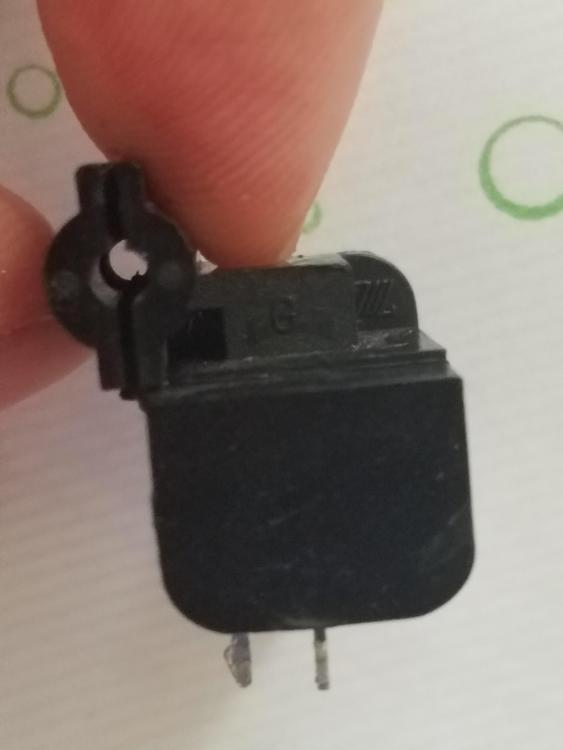

mypasswordis Posted April 10, 2017 Report Posted April 10, 2017 (edited) Anyone recognize this RCA socket and have the part number? Single channel and has that mounting hole on the top left. Also, what's the best way to remove neutral cure silicone rubber off pcbs? Edited April 10, 2017 by mypasswordis
Pars Posted April 11, 2017 Report Posted April 11, 2017 Damn, that's a tough one! https://www.aliexpress.com/item/Free-shipping-10pcs-lot-RCA-connector-female-audio-video-jack-one-hole-RCA-108B-4/1760793413.html?spm=2114.40010308.4.39.ZQZdNB Maybe?
DefQon Posted April 11, 2017 Report Posted April 11, 2017 Looks roughly the same, those 1 position mount type of RCA connectors are heavily used in cheap $20-40 DVD/Blu ray players.
mypasswordis Posted April 11, 2017 Report Posted April 11, 2017 2 hours ago, Pars said: Damn, that's a tough one! https://www.aliexpress.com/item/Free-shipping-10pcs-lot-RCA-connector-female-audio-video-jack-one-hole-RCA-108B-4/1760793413.html?spm=2114.40010308.4.39.ZQZdNB Maybe? Thanks! That's the closest thing I've seen so far, but then again I hadn't even found any PCB style jacks with chassis mounting hole in my search... Sadly the bottom pins aren't in the same place and there are no locking tabs like in your link. I'm not so sure about overall dimensions, either. Definitely tough. I emailed Emotiva, hopefully they will get back to me tomorrow with a part number.
Pars Posted April 11, 2017 Report Posted April 11, 2017 I'd see if emotiva would send you a couple of them. They are after all the ones who selected them Sent from my iPhone using Tapatalk
mypasswordis Posted April 11, 2017 Report Posted April 11, 2017 Good idea! I just called and they want to charge $12.50 for just one RCA jack. Dear lord. I guess they can charge whatever they want when no one can find whatever part they're using. Gonna try to see what can be done under warranty.
