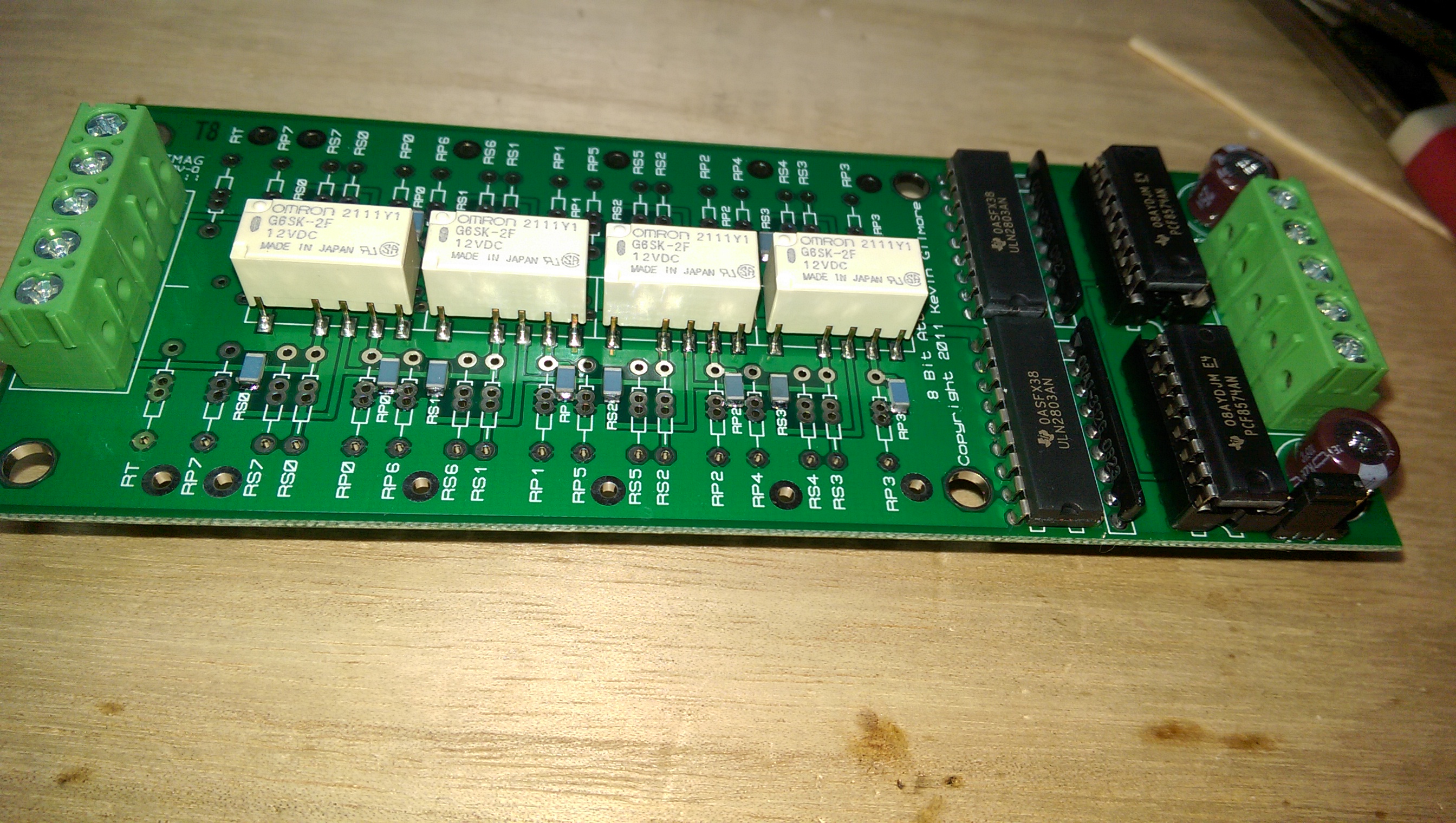

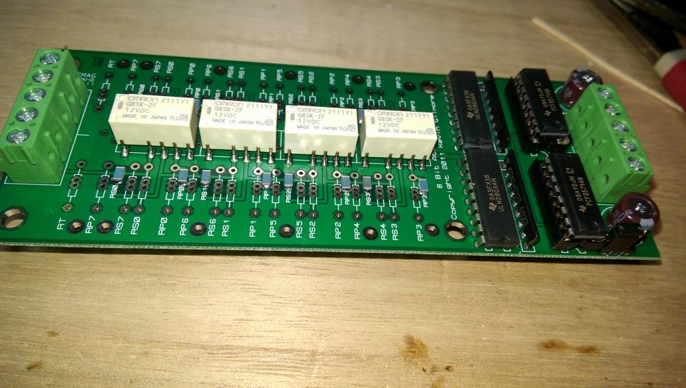

Kerry Posted April 29, 2016 Report Posted April 29, 2016 Does anyone have a bare board for the original group buy digital attenuator. I've got parts for another, but no board (not good planning). I wanted to build it so I can test the controller software for balanced operation. Quote
luvdunhill Posted April 30, 2016 Report Posted April 30, 2016 I have some, but I am not sure how accessible they are. I am on vacation in FL, when would you need them by? Quote
Kerry Posted April 30, 2016 Report Posted April 30, 2016 (edited) No rush. I just need one, so let me know when you get back. Thanks Edited April 30, 2016 by Kerry Quote

kevin gilmore Posted May 2, 2016 Report Posted May 2, 2016 i think i have a bare board, will look later Quote
