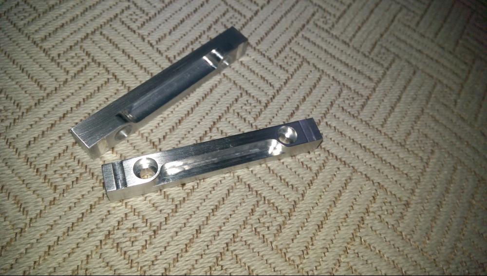

johnwmclean Posted January 6, 2016 Report Posted January 6, 2016 Looking for a name/supplier for these connecting metal joiners? Quote
luvdunhill Posted January 6, 2016 Report Posted January 6, 2016 I just make them myself. The usual suspects won't do them because the piece has to be turned to a 90 degree side. There is a special countersink bit for socket head screws that makes it pretty easy. Quote
Kerry Posted January 6, 2016 Report Posted January 6, 2016 I user them all the time. They are called counter bores. I made these. 1 Quote

johnwmclean Posted January 7, 2016 Report Posted January 7, 2016 Thanks Mark and Kerry, those custom pieces look terrific! Quote

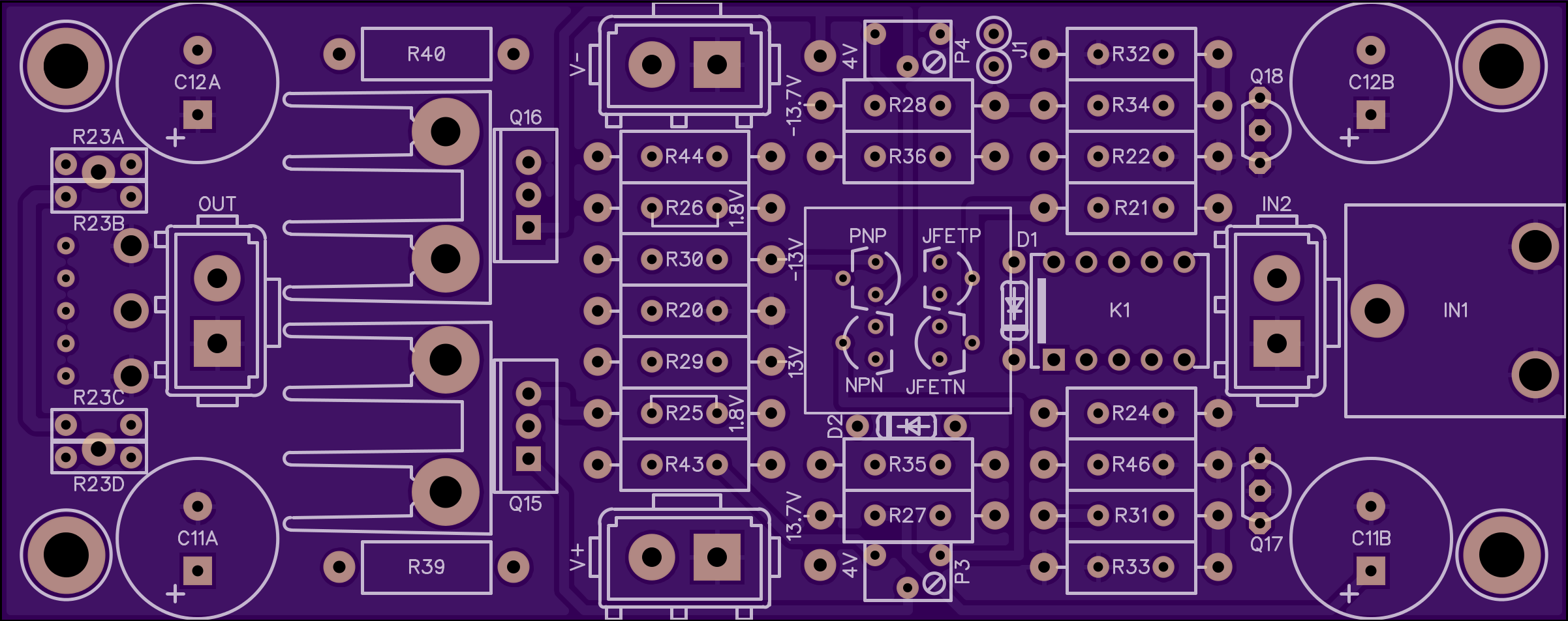

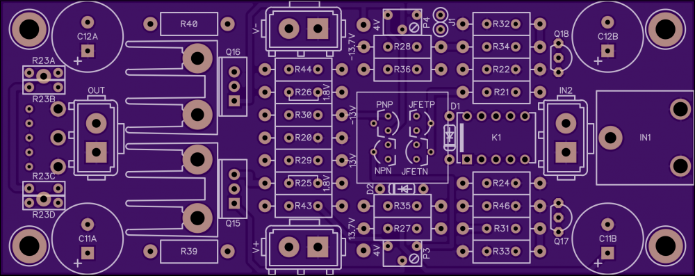

luvdunhill Posted January 12, 2016 Report Posted January 12, 2016 Placed an order for a board with Elecrow (used PCB Way for a mating design) that looks something like this. The two odd sets of connectors on the far left are board-to-board connectors that I'm trying out from Mill-Max Quote
luvdunhill Posted January 13, 2016 Report Posted January 13, 2016 It's a front end. BJT cascoded JFETs with MOSFET voltage gain. The relay is for switchable feedback loop. 1 Quote
luvdunhill Posted January 22, 2016 Report Posted January 22, 2016 The right way to mount a TO-3 package is with a shoulder washer on the bottom and then using a ring connector to attach the case to the circuit. I am trying to do it another way. It will make more sense when I post some pictures [emoji4] Ok, so strange. They interpreted the swell as negative board "cladding" (whatever the term is)? Anyways, it will work fine, but didn't expect the large non-blue areas around the TO-3 pins on the top layer. Next need the gage jack parts from Mouser for my next demonstration. Quote

luvdunhill Posted January 29, 2016 Report Posted January 29, 2016 Cool. Interesting to see how this turns out, though I'm not sure I ever knew why you needed or wanted these done this way. Or, Where the entire pin is in the bottom of the board, it's slightly press fit due to a small flange visible in the first picture For the later example, it would have been nice to have a solder pad on the bottom, but kept the top as close to min annular ring so that we don't introduce a larger gap around the pin, which hurts thermal performance. Quote

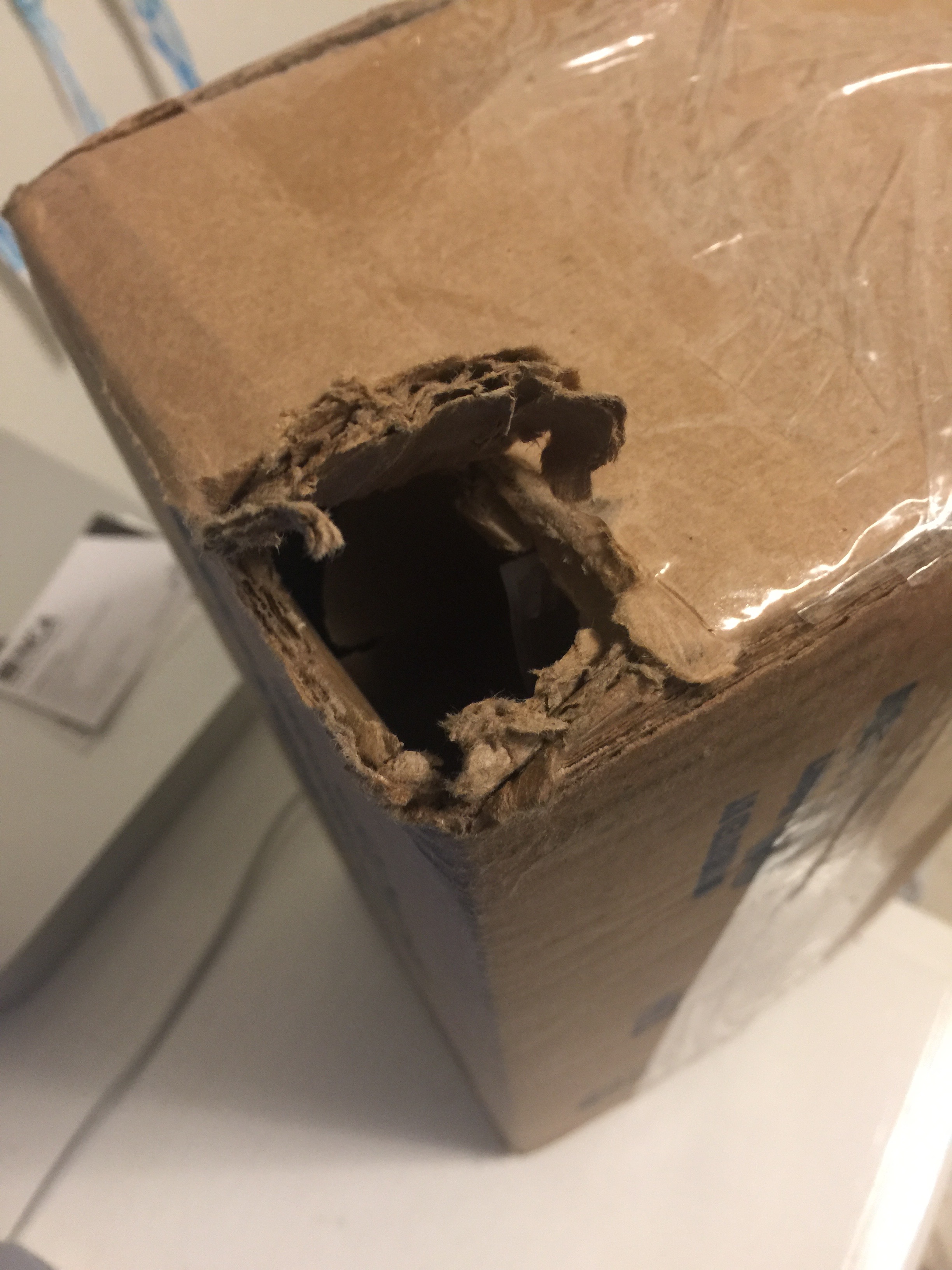

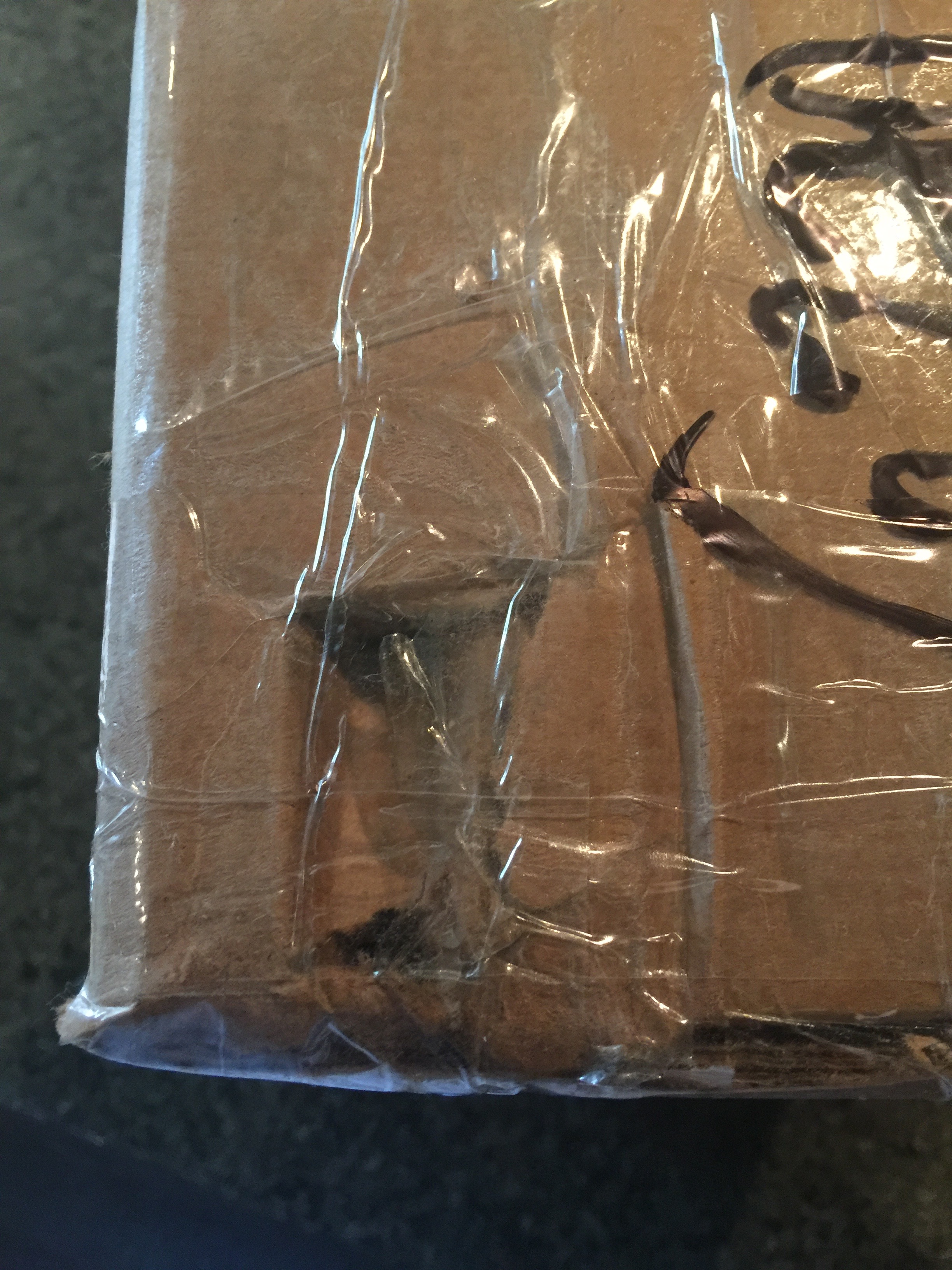

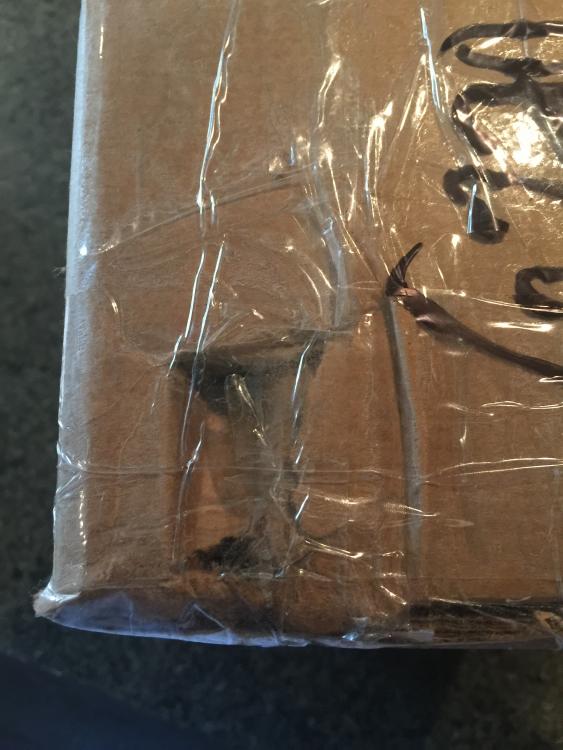

luvdunhill Posted March 3, 2016 Report Posted March 3, 2016 any suggestions on how to order copper bars and have them actually arrive? first order, got 1 of 2 (nice of UPS to patch the box) and second order both bars were missing. Quote
UFN Posted March 4, 2016 Report Posted March 4, 2016 Not sure if that was a rhetorical question, but if not: Ask the seller not to put them in a box so they rattle around. Tape them together and then just cover with a (thick) outer layer of bubblewrap and cardboard/paper/duct tape. //UFN Quote
