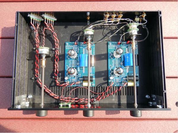

sbelyo Posted October 24, 2014 Report Posted October 24, 2014 I have used Delrin rods on 2 different builds and have been very happy with the results. Electrical isolation is my main reason for use but cost and easier machining also weigh in. Me Does it slip when you turn it? I'm using it to turn the shaft of a volume control and goldpoint switch. The knob will be collet mount and the shaft coupler is a clamping style
luvdunhill Posted October 24, 2014 Report Posted October 24, 2014 The negative of Delrin is torsional strength.
muskyhuntr Posted October 25, 2014 Report Posted October 25, 2014 If what you mean by 'slipping' is a feeling of flex in the rods while turning, it depends. On both a M3 build and an Aikido (picture below) there is no feel of flex when turning normally. However, when going past the limits of the switches/volume control you can feel some flex. The M3 has less flex than the Aikido due to it having shorter shafting, but not by much. I plan on using the same shafting when I finish casing my KSA4. Me
