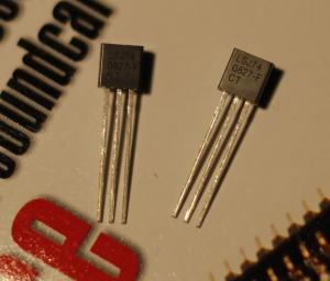

Pars Posted January 10, 2010 Report Posted January 10, 2010 They may be getting close, at least to the LSJ74: The Burning Amp Festival- October 18th 2009 Sign ups - Page 4 - diyAudio Quote

Pars Posted January 15, 2010 Report Posted January 15, 2010 It looks like a standard LM317/337 supply; not the OPA548 supply for the original Gilmore Dynamic on headwize. Its probably fine, but not quite as clean I would think. Quote

kevin gilmore Posted January 15, 2010 Report Posted January 15, 2010 The wheels are in motion What i really want is 2 n-channel and 2 p-channel parts matched and in one package. I have a couple of new designs just waiting for these things. Quote
cetoole Posted January 17, 2010 Report Posted January 17, 2010 What i really want is 2 n-channel and 2 p-channel parts matched and in one package. I have a couple of new designs just waiting for these things. I think there are a lot of people jonesing for just the part you described. Quote
