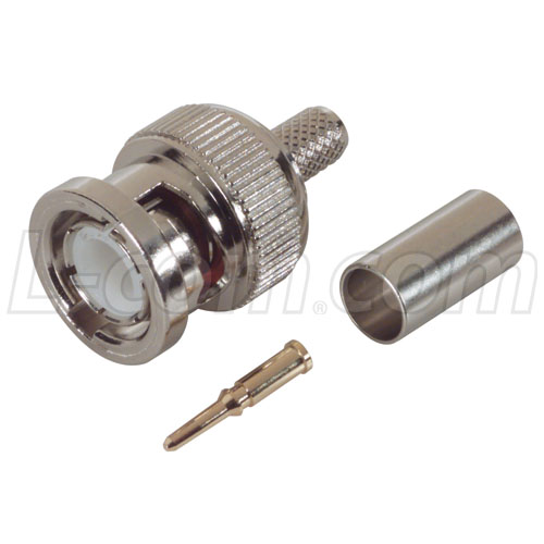

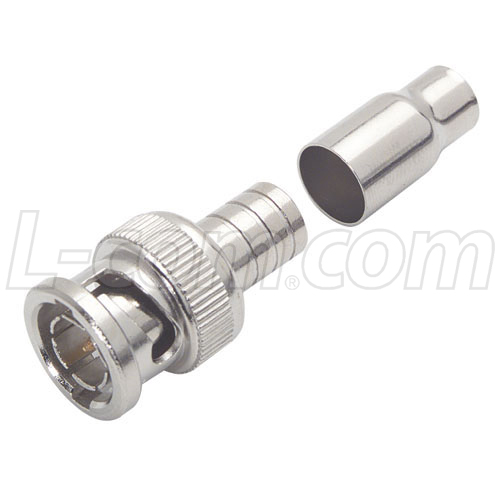

Pars Posted November 17, 2009 Report Posted November 17, 2009 Just make sure you get 75 ohm BNCs as opposed to 50 ohm, which seem to be more common (used for oscilloscope leads, etc.). When looking at connectors over time, I have noticed that many of the boutique BNCs are actually 50 ohm, but moar gold plated. Furutech--probably 50 ohm Vampire--also appears to be 50 ohm Cardas--appears to be 75 ohm, though can't tell for sure Trompeter 50 and 75 ohm shown in thumbnails: 50 ohm on left, 75 ohm on right. Quote
