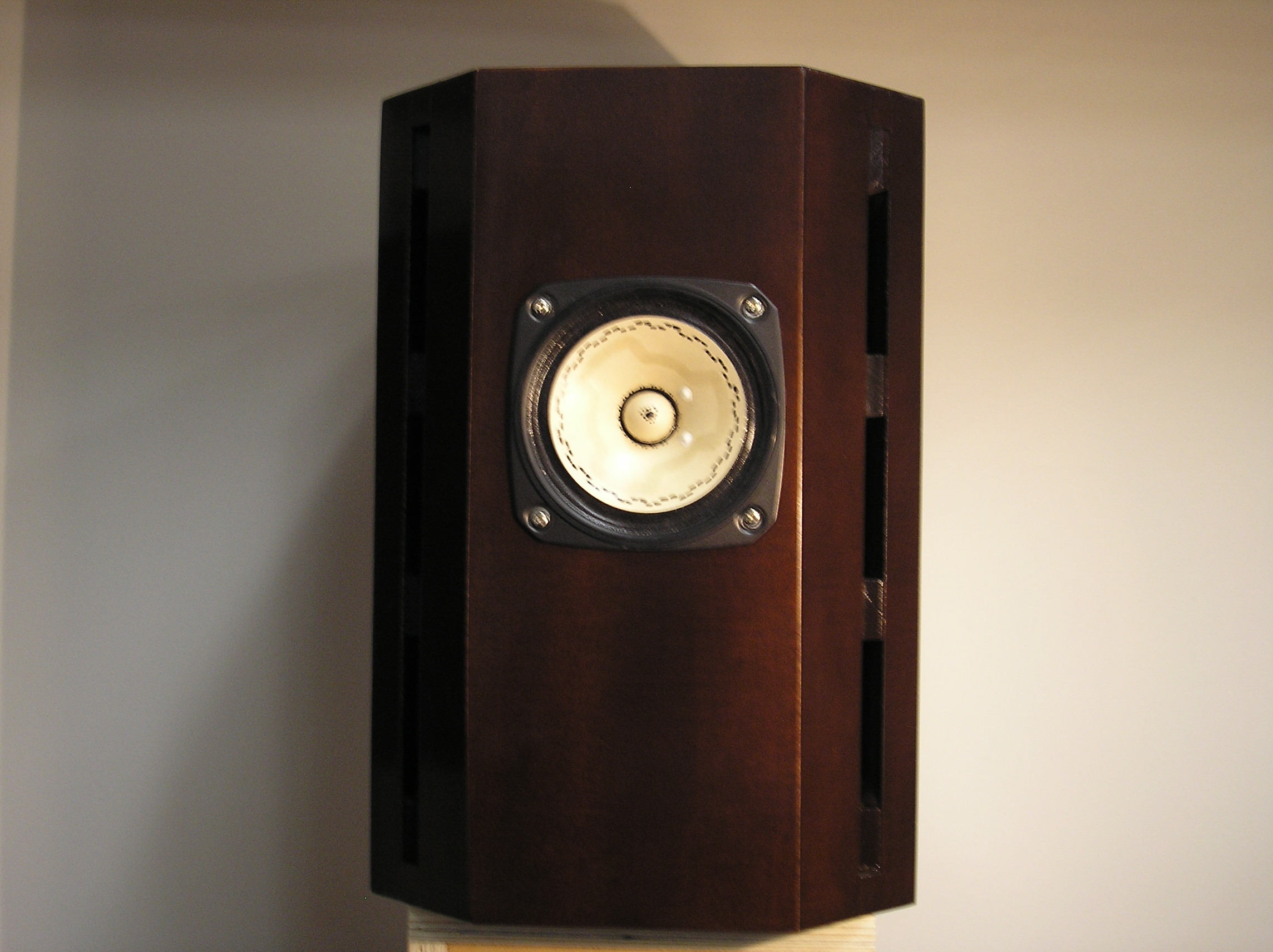

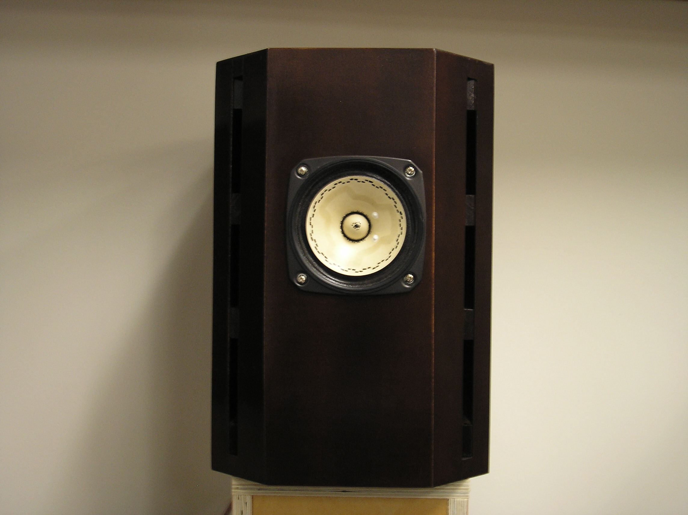

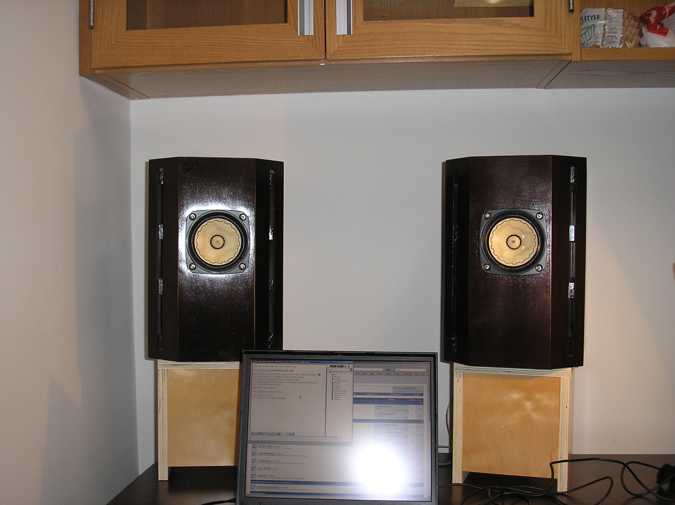

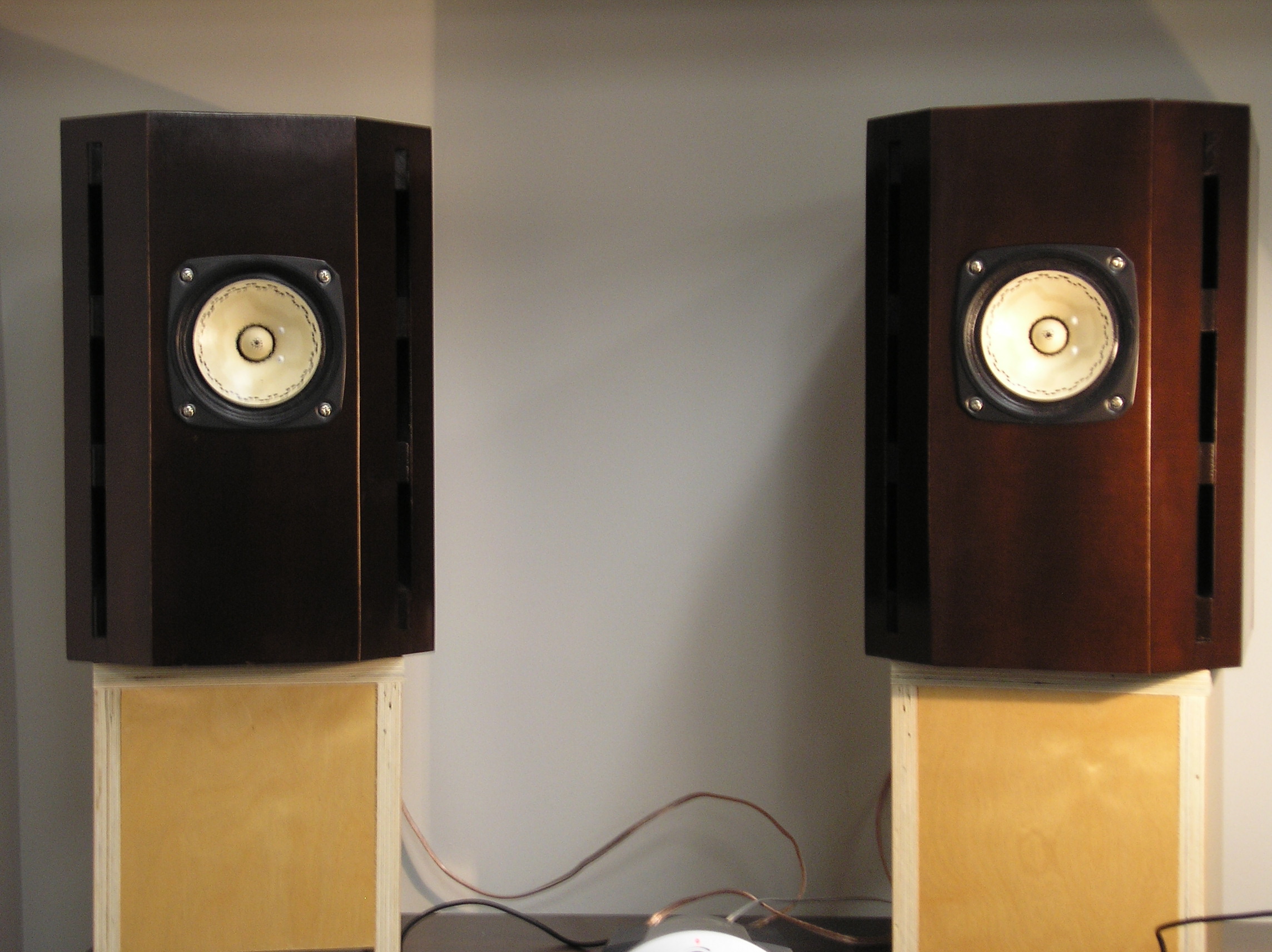

crappyjones123 Posted October 29, 2009 Report Share Posted October 29, 2009 so fucking happy right now even with the t amp at 15% they can fill up my office beautifully. was skeptical about the 1.8 watt decware amp but all reservations have been removed. yes i know the drivers are mounted sideways but theres a brace directly behind the driver and thats the only way the driver would go in without damage to driver posts. i did about 15% of the work in building them. rather happy with the outcome. the guys who built them did a beautiful job. pictures dont really shop the texture all that well. Quote Link to comment Share on other sites More sharing options...

crappyjones123 Posted October 29, 2009 Author Report Share Posted October 29, 2009 thanks both. the stands need to be shortened by about 1.5". the drivers are around the top of my ears. a little over infact. the imaging is fantastic. i just moved them about 6" apart and now they image even better. no shrill top end. clean to about 45hz. usable low frequency is probably around 60-65hz perhaps. but has no problems reproducing a 45hz test tone at -6db. Quote Link to comment Share on other sites More sharing options...
