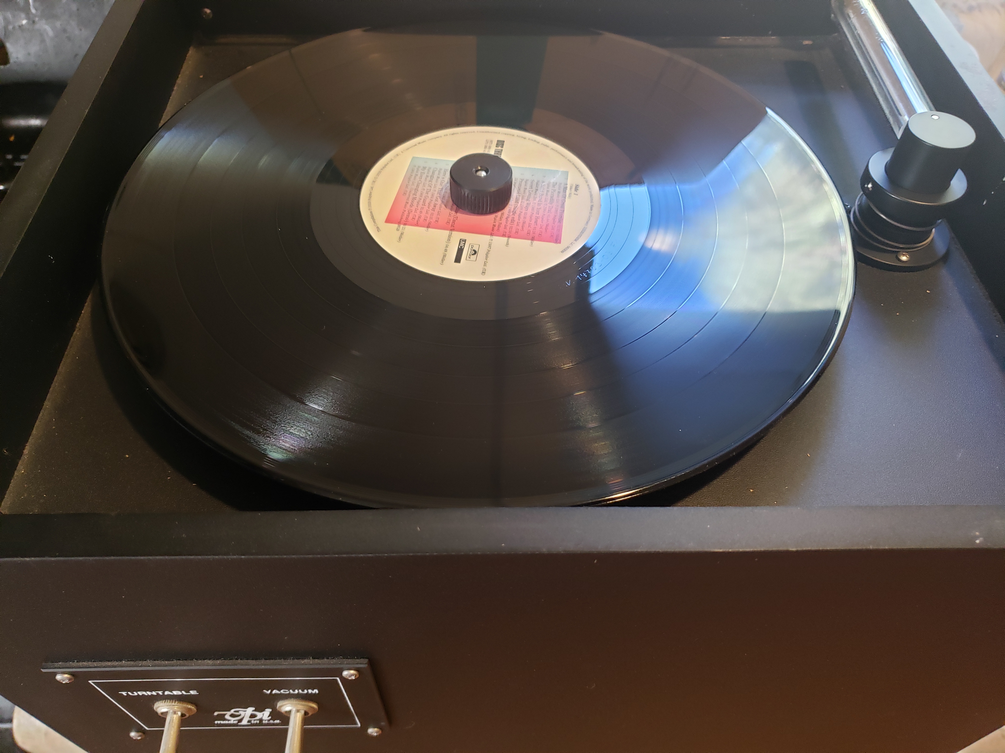

swt61 Posted December 24, 2020 Report Posted December 24, 2020 Using the VPI 16.5 cleaner that Al graciously gave me on extended loan for the first time. There's something so satisfying when you hit the vacuum switch and the wand sucks down and dries the album. This is the first automatic record cleaner I've ever used. I'm hooked. 9

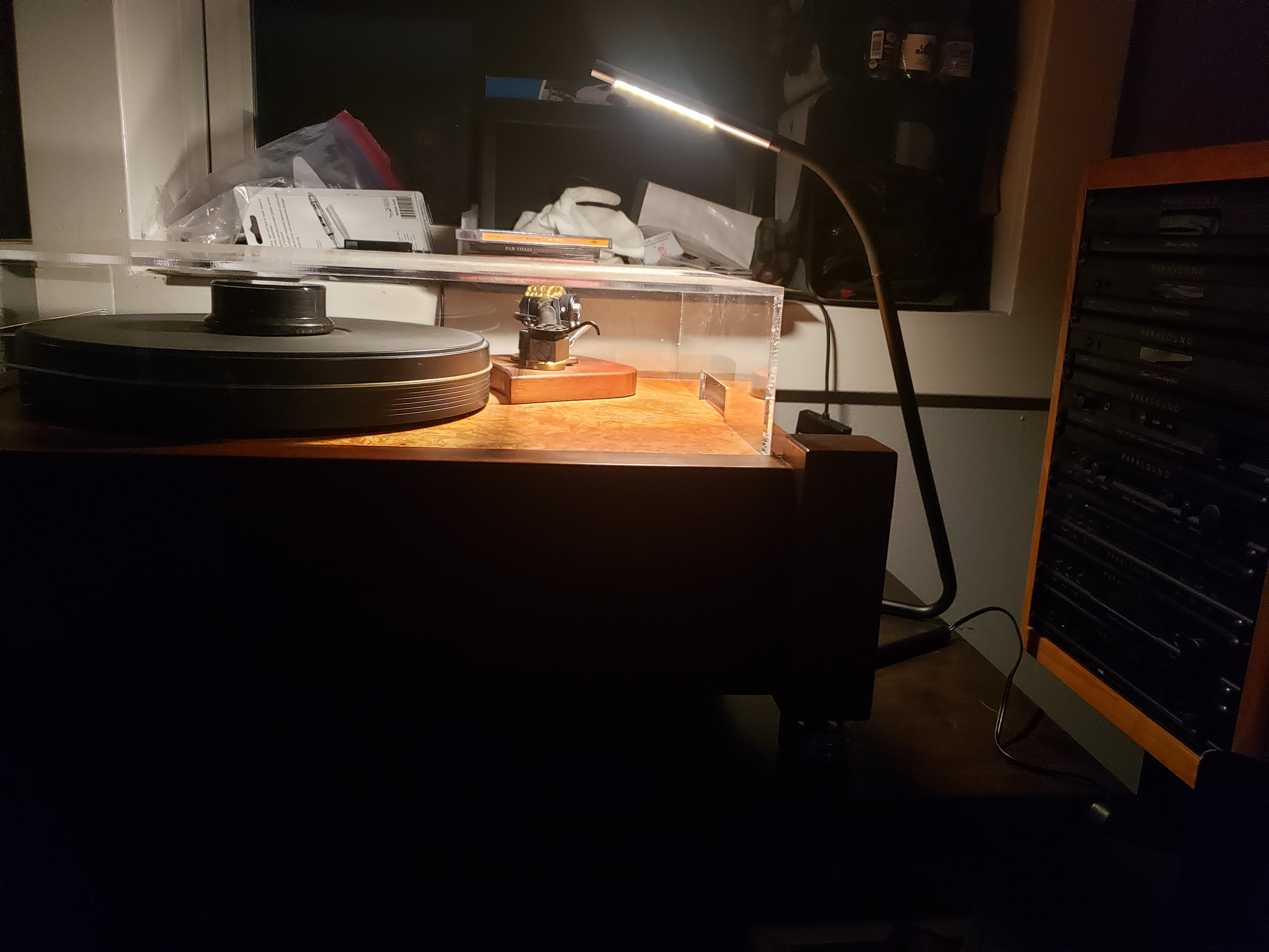

swt61 Posted January 12, 2021 Report Posted January 12, 2021 Found this light which is perfect for the TT system. It's an Ikea light, but I bought it on Amazon. About $30, compared to $100 for the Littlelite TT light. 7 2
