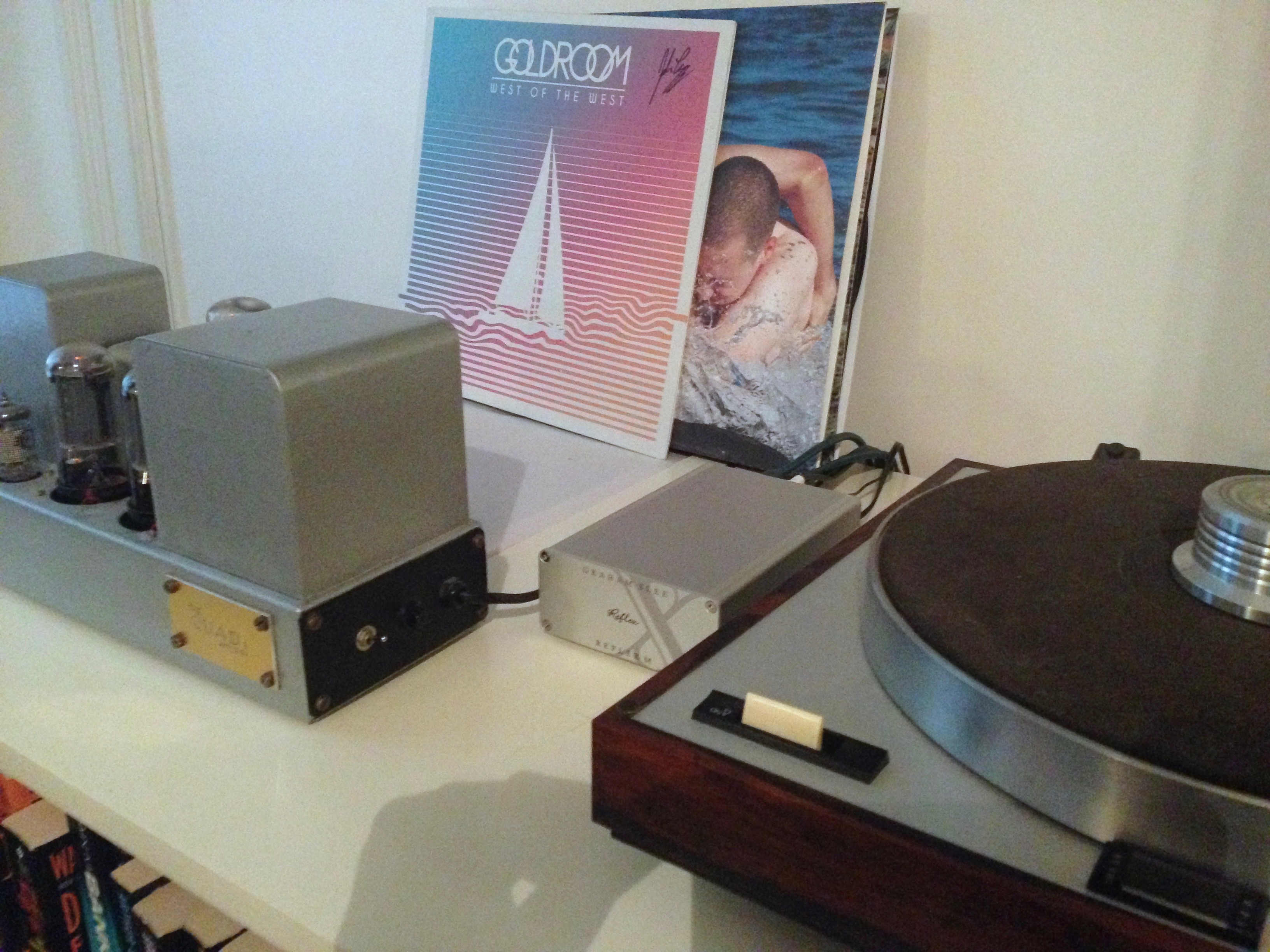

bjarnetv Posted October 14, 2016 Report Posted October 14, 2016 (edited) The local graham slee importer is closing it's doors and is selling off the remaining stock with a 40% discount. Naturally i picked up a reflex M and psu1. only problem now is i feel compelled to upgrade my lowly DL160 PU as well! #1st world problems also, this is the daintiest piece of hi-fi hardware i have ever seen! Edited October 14, 2016 by bjarnetv 1

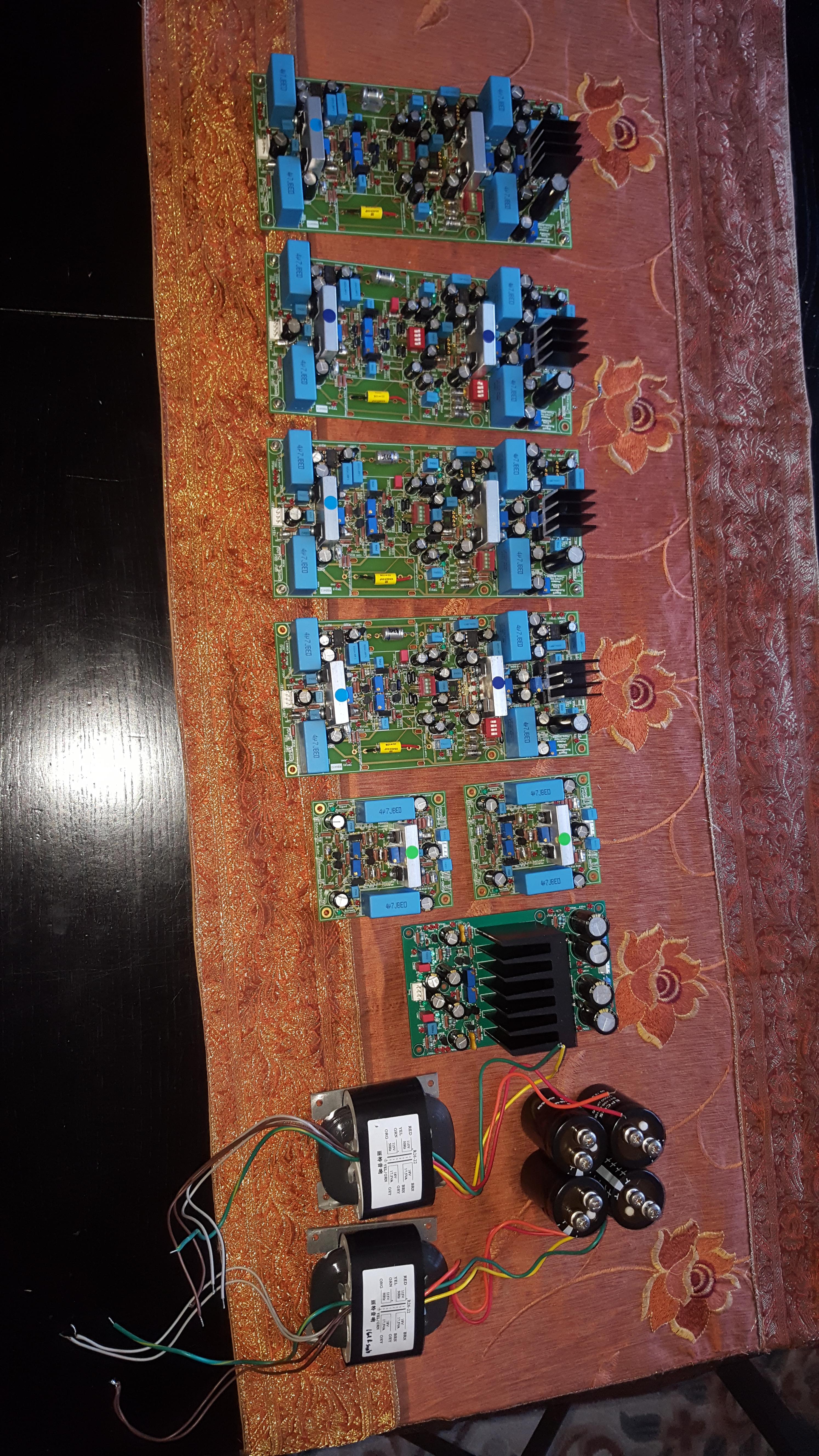

Craig Sawyers Posted October 15, 2016 Report Posted October 15, 2016 (edited) OK - completed and part tested current input balanced phono stage by Borbeli (and Sigurd Ruschovski). Better sound good - cheap to build it was not. Need the casework and build three more shunt regulators (the thing with the black heatsink). For use with Garrard 401/SME/DL103(Zu Audio rebuild) Edited October 15, 2016 by Craig Sawyers
swt61 Posted October 15, 2016 Report Posted October 15, 2016 I always wanted to try a balanced phono stage. That looks quite nice. Will wait to hear your thoughts. Is a balanced tonearm cable easy enough to come by?
Pars Posted October 15, 2016 Report Posted October 15, 2016 A phono cartridge is essentially balanced, so all separate wires from the headshell in. From what I recall, the two - signals are tied together in the turntable itself, so I think that undoing that and bringing them out somehow is all you need to do. Been quite awhile, and I've never rewired one.
Craig Sawyers Posted October 16, 2016 Report Posted October 16, 2016 I'll probably configure it single ended first. The two small boards can be bal2unbal or unbal2bal. So for SE these would be unbal2bal. Then rewire tonearm in a way I have not entirely thought through yet and go balanced input to balanced output. Then the small boards would be bal2unbal just to provide an unbal output if needed. Casework will come from here http://www.modushop.biz/site/ , at which point I will be financially punished as a result of the stupidly weak pound (globally) as a result of the clowns who voted us out of Europe.
luvdunhill Posted October 16, 2016 Report Posted October 16, 2016 Craig, check out the owner's manual for the Ayre P-5xe phono stage for one such rewiring scheme. I just use a 5-pin DIN then either isolated RCA jacks or XLRs.
Craig Sawyers Posted October 16, 2016 Report Posted October 16, 2016 Thanks mate - will download and have a look. The Ayre stuff is pretty awesome.
