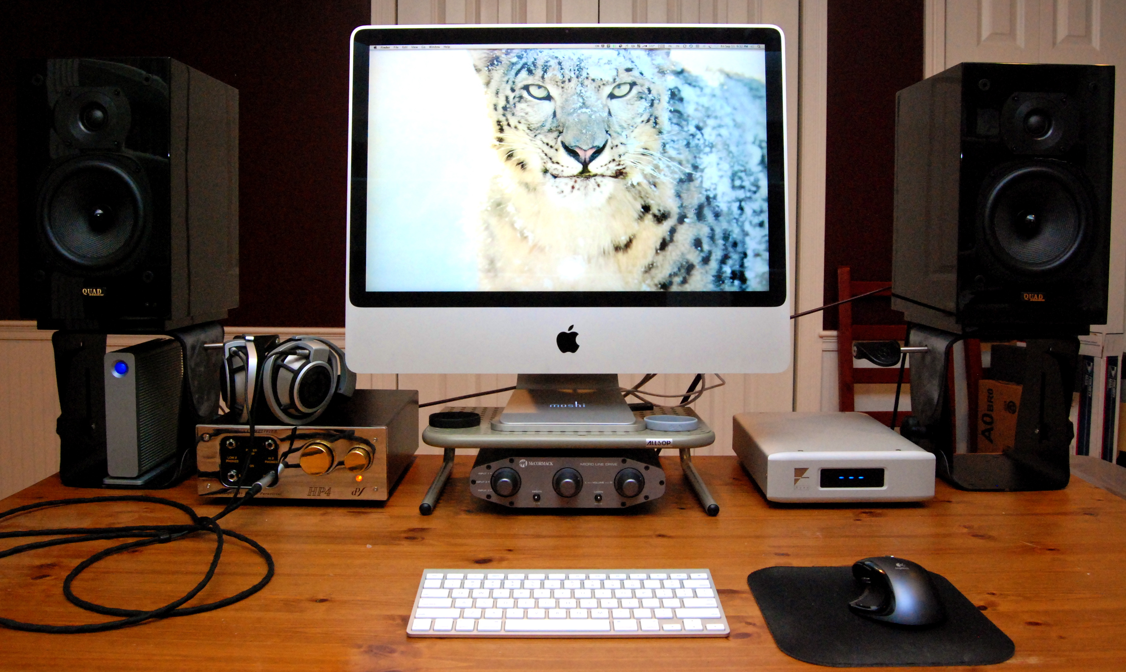

Hopstretch Posted September 12, 2009 Author Report Posted September 12, 2009 It's the continuing desktop clusterfuck. Like an arse, I decided to add an analogue source as well, so I needed a preamp. Thought I'd run it active with the headphone amp on the tape out and the powered monitors on the pre out. But it turns out there's a wicked hum in the speakers that way. Passive, though, it's beautifully quiet and transparent -- so the bodge setup right now is both sources into the pre, line out to the headamp and loop through that to the speakers. This appears to work fine from a SQ perspective, but still begs the original question about where to be setting the levels. The simple answer, I guess, would be to sell the lot and buy a Zana and be done.

Hopstretch Posted September 12, 2009 Author Report Posted September 12, 2009 See below for current setup, complete with some castoffs from Mike that just arrived today. I'd be interested to hear more about this mod for the 12Ls, Dusty.

jinp6301 Posted September 12, 2009 Report Posted September 12, 2009 See below for current setup, complete with some castoffs from Mike that just arrived today. I'd be interested to hear more about this mod for the 12Ls, Dusty. Your rig turns me on

swt61 Posted September 12, 2009 Report Posted September 12, 2009 Your rig turns me on Careful, that desk has just been wiped down!
Hopstretch Posted September 12, 2009 Author Report Posted September 12, 2009 Careful, that desk has just been wiped down! Nah, I just hose it off occasionally. Fnarr fnarr. Thanks Mike. Food for thought there. Made me wonder if it's a good idea to run the tube amp maxed out at all. Presumably that's going to be stressing the magic bottles more than having them loafing along while the SS pre works harder?
