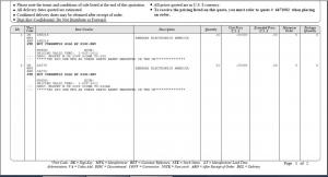

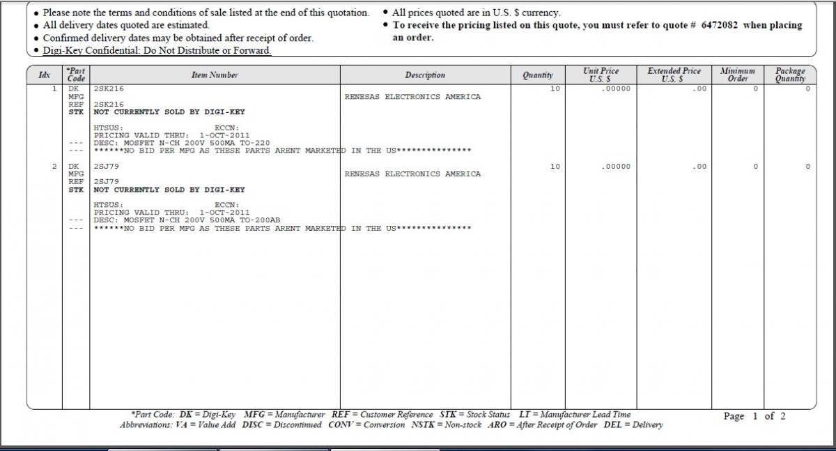

deepak Posted September 13, 2011 Report Posted September 13, 2011 The first distributor I spoke to told me minimum purchase quantity for k216/j79 was 3000 of each. Digikey just gave me this quote... does this mean they are free? (I called them curious about what it meant, and the plain simple of it is they can't buy them). Sorry guys. The New England rep for Renesas hasn't been very helpful, so if anyone else wants to try their local rep you may have more success. Quote
