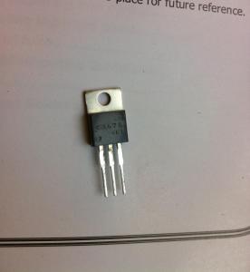

Hmmm I think the k216 I got from bdent may be fakes... If Inu is correct about the date codes the ones I have use a date code of M, which would be that new month after december when we switch to a lunar calendar. Here is a picture:
Posted
Those are genuine Renesas devices I believe.
Yes, it is genuine Renesas FET. I am using same one in my T2.
Thanks guys that is good to know. Now I just wish I had bought more of them, I wasn't expecting them to be so hard to come by.
