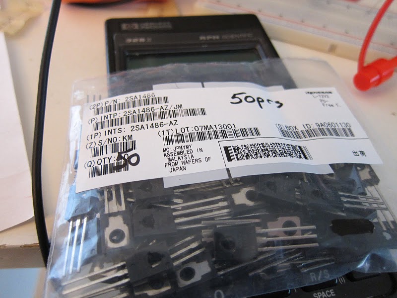

ujamerstand Posted August 5, 2011 Report Posted August 5, 2011 So, I bought some C3675 and A1486 from utsource, after seeing that they have it in stock in cheaper prices than bdent, and that this particular distributor seem legit from comments on diya. I initially thought that all of these are fakes because of the uneven epoxy coating on the back side of the a1486 part; but measuring them gives me a minimum hFe of 30, a maximum of 67, while most of them have a reading about 60. Similarly, most of the C3675 I got have a hFe reading around 58-71. So both of these devices are within tolerance. Are there any reasons why I should not be using these devices? Quote
luvdunhill Posted August 5, 2011 Report Posted August 5, 2011 (edited) You cannot really tell from that setup. You need to measure them at their rated voltages and a more realistic base current. Edited August 5, 2011 by luvdunhill Quote
ujamerstand Posted August 5, 2011 Report Posted August 5, 2011 arg. I guess I will have to build a KGSSHV supply for this purpose? Quote
luvdunhill Posted August 5, 2011 Report Posted August 5, 2011 Yeah, I don't know what to say. I haven't had to deal with authenticating these parts, as every single part I have came from an authorized Renesas dealer with original packaging. One just has to be prepared to pay in bulk. Quote
