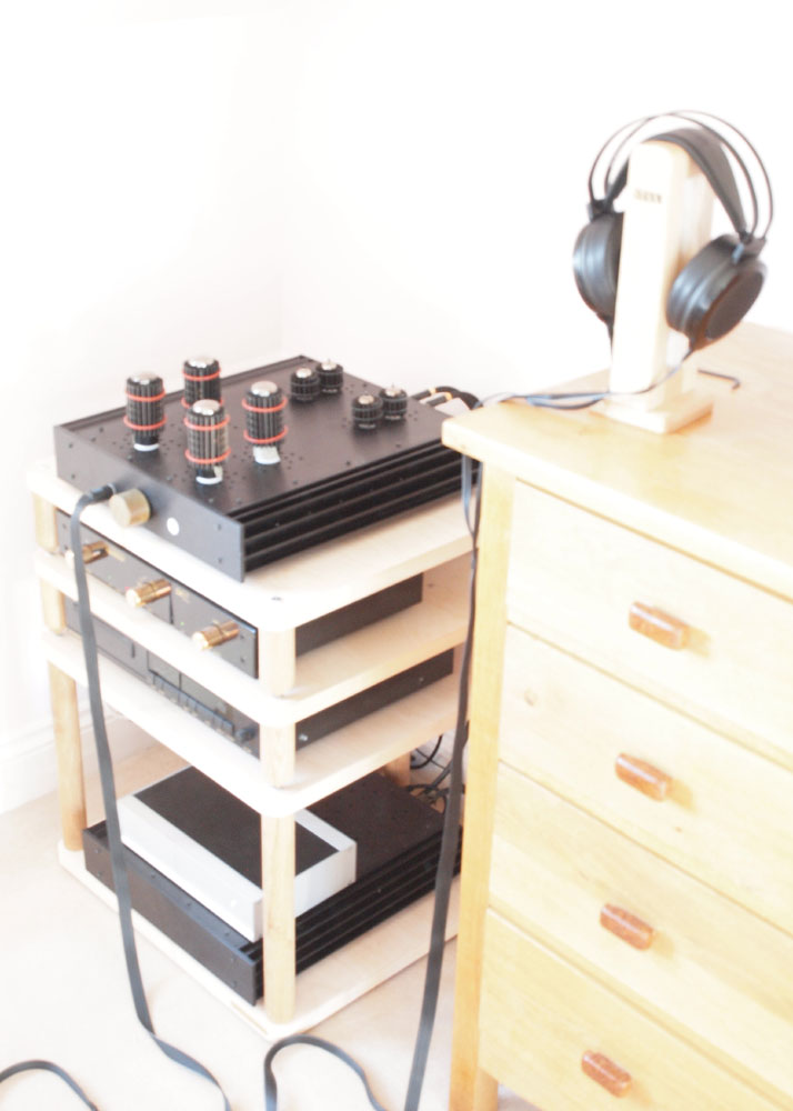

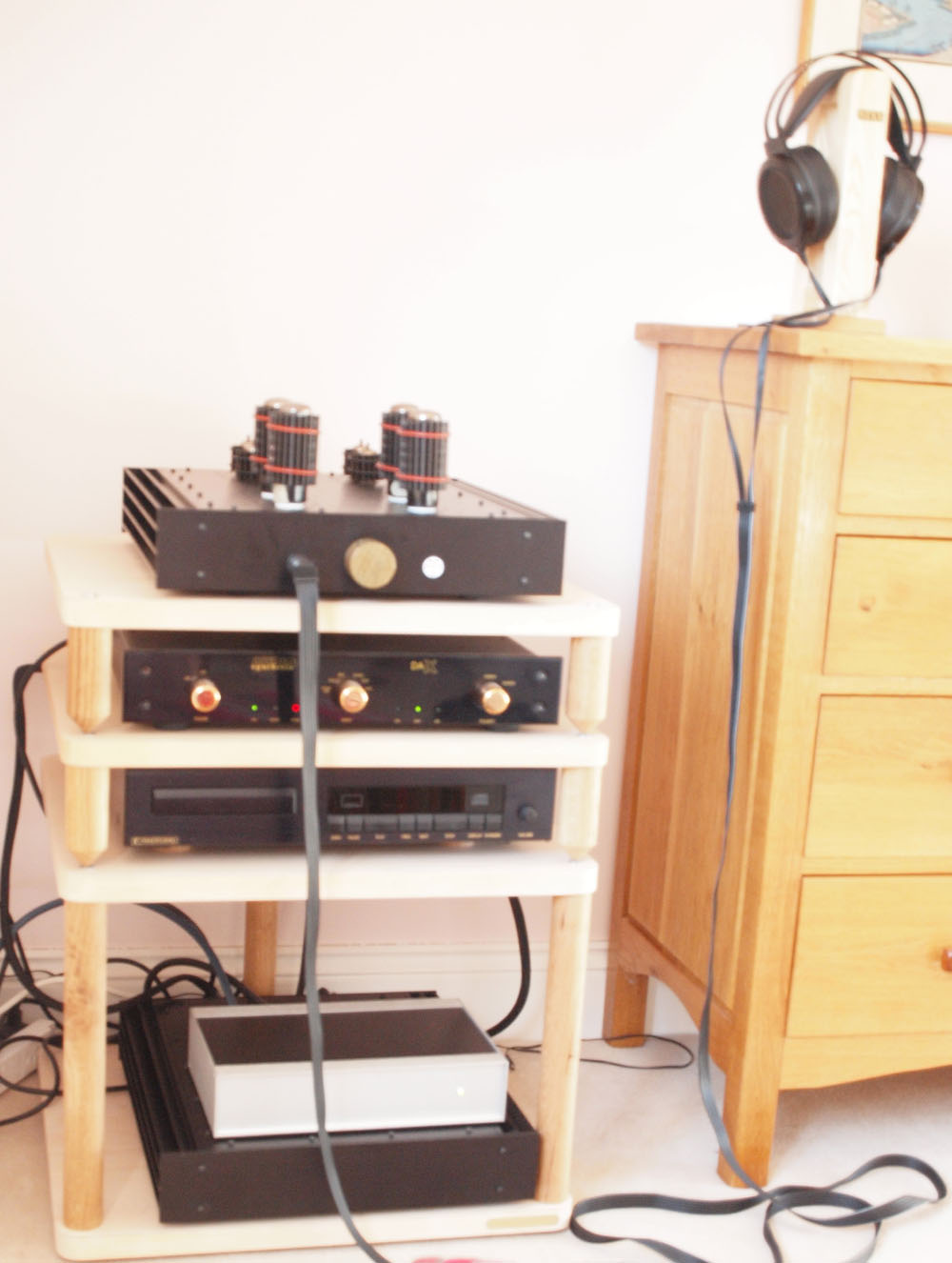

Craig Sawyers Posted January 9, 2011 Report Posted January 9, 2011 Here's a couple of pics with the T2 where it lives in the corner of our bedroom (and that was an interesting conversation, trust me ). [ATTACH=CONFIG]4217[/ATTACH] [ATTACH=CONFIG]4216[/ATTACH] Also measured the amp heatsink temperature after 8 hours = 48C (118F). The power supply was quite a bit cooler than that. Quote
