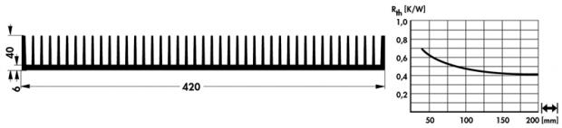

I think I found a couple options. I'll have to cut them down myself most likely, and they ship from Europe, but might be a possibility. I'm assuming no one needs heat sinks? Probably not that many people stupid enough to not get in on the case deal...

If there is a second run of boards, we can certainly change things at that time.
No way am i doing another 700 lbs of aluminum.
My recommendation would be to use a multiple of 100mm. Then at least you can slap a pair of heat sinks per side. I think shaving 12mm off the board size would be possible.
Here's the profile I'm getting a quote on now, I'd cut it to length myself
I'd be willing to handle the second run on heat sinks, but I cannot really commit to complete cases.
