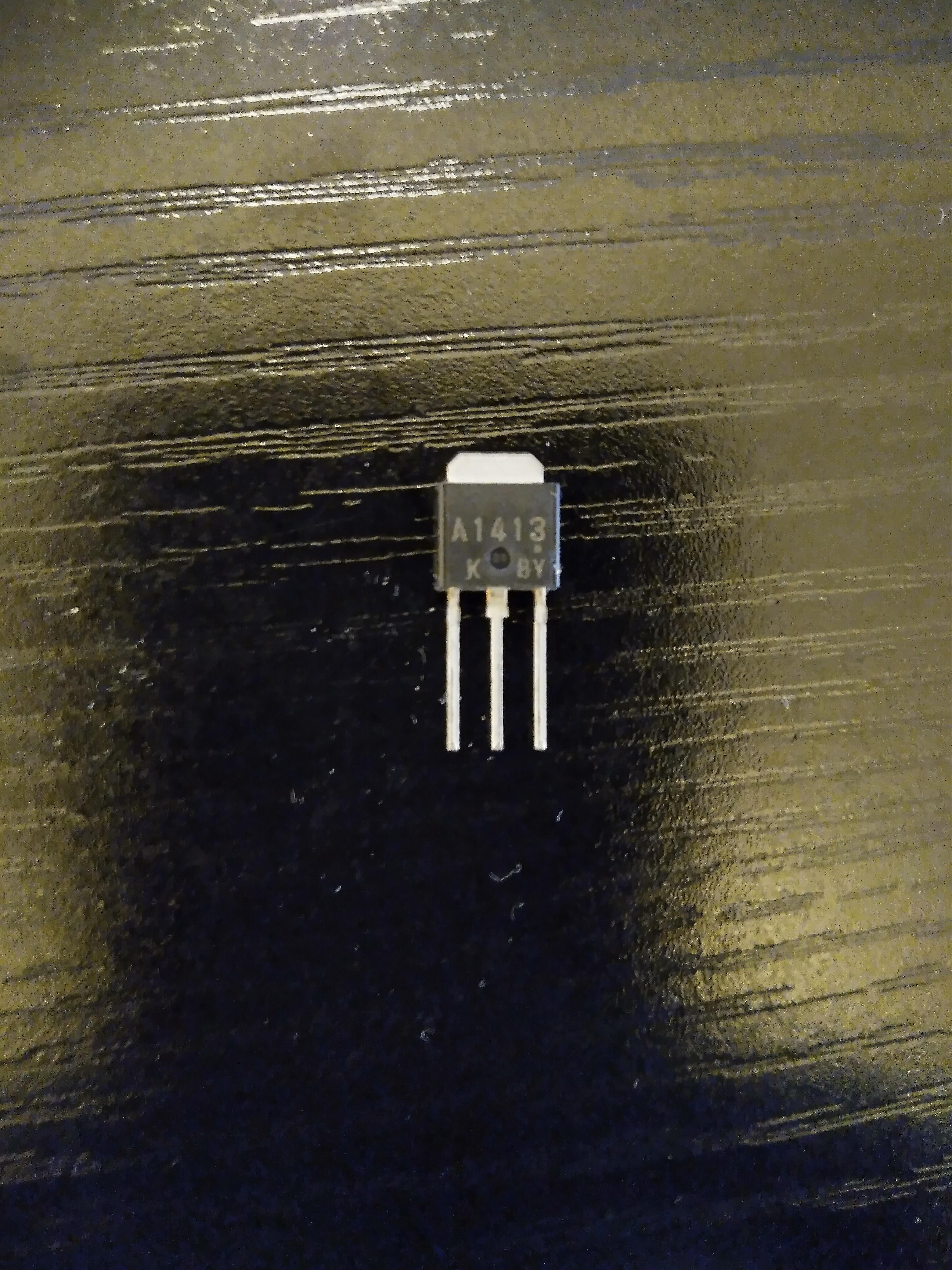

JoaMat Posted October 12, 2023 Report Share Posted October 12, 2023 2sa1413 is to-252 package, isn’t it? How do you solder them in – adapter board? Also, what kind of resistors do you use in the batteries. Quote Link to comment Share on other sites More sharing options...
jokerman777 Posted October 12, 2023 Report Share Posted October 12, 2023 17 minutes ago, JoaMat said: 2sa1413 is to-252 package, isn’t it? How do you solder them in – adapter board? Also, what kind of resistors do you use in the batteries. Mine from Bdent looks like this. If anything my batch of 1413 are labelled as "K" grade and my batch of 1627 are labelled as "L" grade, on my toy transistor tester from Amazon the hfe measures are 100 and 60 respectively which kinda checks out. From my mouser list all resistors are rated 350V, 0.5 watt, most are Xicon except a few. I will double check on board resistor values from color code tonight though. 🙂 Quote Link to comment Share on other sites More sharing options...

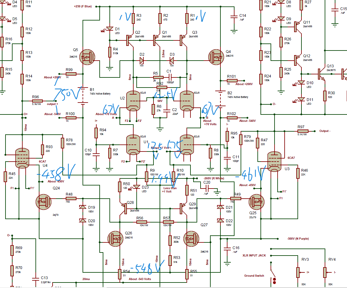

jokerman777 Posted October 28, 2023 Report Share Posted October 28, 2023 I went on and measured more things outside battery while setting battery voltage to 750V: Seems like everything is a little off. I suppose the key to get correct low offset at output is to get the output tube operating point in place (without considering the feedback shenanigans that I don't quite understand😵), with grid sitting on the -500V supply it should come down to getting the plate load CCS and cathode voltage in place. Other than the previously mentioned battery adjustment weirdness, measuring voltage across D1 and D23 I got 1.57V-1.67V, definitely on the low side similar to what I found in the battery. Also battery seems to be not outputing any current with little to no voltage drop across R99 and R100. LEDs With current noted on the schematic, at least for D1 and D23 they be running at about 0.5mA with a forward voltage drop of 1.8V (if all base current can be ignored). I took D1 and D23 and another one from the battery for a measure. LTL4213_old is taken off from the board, only plotting one as they all measured similarly, LTL4213_new is another batch I bought recently, along with the Cree C566D also a 2.1V red LED with nominal forward current of 20mA. These all measured pretty much the same, on the lower side of 1.8V but strangely never went down as low as around 1.6V as I measured in amp when operating. Only thing I can think of is derating due to the negative temperature coefficient? 3RDL-S is a 2.1V red LED with nominal forward current of 2mA, as expected the curve shifted to the right side. Seems to be a shot in the dark but I shall replace all LEDs with 3RDL-S and sufficiently elevate them from the board? (which I didn't do with the current LTL4213s on board..) 2SK246 I didn't take out the ones on board but gotten a few backup ones from ebay, hook them up on the breadboard and set voltage across 22K resistor to around 6.55V at 12V supply voltage from the bench. Then sweeping supply voltage nothing surprising and they regulates fine... Resistors I replaced R33, R34, R43, R44 with 500V rated resistors - as I just realized voltage across them will always be a little above 350V, and this doesn't change anything. So I think I'm going to replace all the LEDs this weekend, although it seems everyone else are using LTL4213 just fine, possibly still not the cause of my problem... Quote Link to comment Share on other sites More sharing options...
simmconn Posted October 29, 2023 Report Share Posted October 29, 2023 LED: The numbers are all over the place: 22 hours ago, jokerman777 said: measuring voltage across D1 and D23 I got 1.57V-1.67V 22 hours ago, jokerman777 said: With current noted on the schematic, at least for D1 and D23 they be running at about 0.5mA with a forward voltage drop of 1.8V Your IV curve shows the LTL4213 should have Vf between 1.725V and 1.750V with 0.5mA of current. You've got three different voltage ranges for the LED. Which one is correct? You need to find out where the dependencies come from. Your previous LED chain voltage measurement shows 12.1-10.7=1.4V of voltage variations with not much If change. Is the 1.4V evenly distributed across 7 LEDs? If you suspect Vf change due to the temperature coefficient, that's easy to verify. Just keep monitoring the LED voltage with the amp powered on from cold. 2SK246: Your test indicates that the 'backup ones from ebay' are probably good. Unless the ones on the board are from the same seller and same batch, the test result probably doesn't help much more than that. Rather than replacing parts shotgun style. I'd take voltage measurements shotgun style, then sit down and analyze the data. Replacing parts without knowing why and what would be a very inefficient way of troubleshooting. For example, when looking into the active battery, measure voltage on all nodes. Beware of the burden by the DMM input impedance (usually 10M Ohms but YMMV), so plan carefully when you measure across high-value resistors. When looking into the final stage, collect enough voltage data within the CCS so you can calculate the current supplied by the CCS. Measure the voltage at Output+/Output-, then determine if the tubes are in the right operating point. If you know very well how the circuit works, you can strategically take only a few measurement at key spots; otherwise just do more leg work and collect all data. Don't worry if some could be redundant. They often end up helping you where least expected. 1 1 Quote Link to comment Share on other sites More sharing options...
