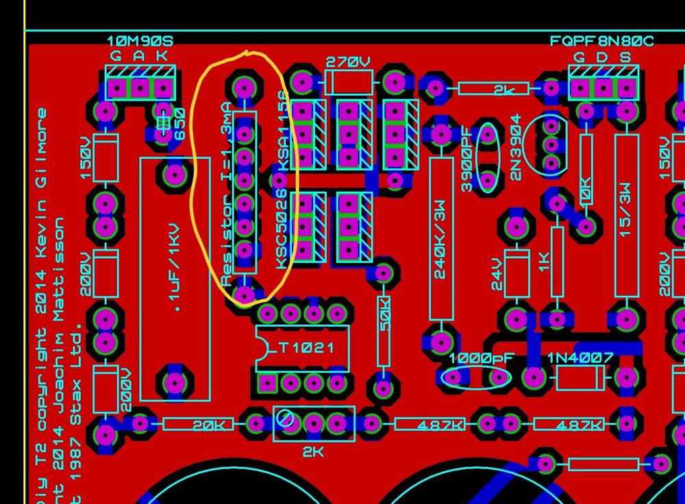

JoaMat Posted February 6, 2023 Report Posted February 6, 2023 (edited) R11 determines the current through LT1021-10 which needs 1.1 mA at 25 degree C. Choose R11 value accordingly. For +/-500V sections; R11 = 400K gives 1.4mA and 0.8W. Edited February 6, 2023 by JoaMat 3 Quote
jamesmking Posted February 6, 2023 Report Posted February 6, 2023 (edited) 7 hours ago, JoaMat said: R11 determines the current through LT1021-10 which needs 1.1 mA at 25 degree C. Choose R11 value accordingly. For +/-500V sections; R11 = 400K gives 1.4mA and 0.8W. The original published gerbers has All the rails running at around 1.8mA through the R11 resistor except the +-500V rails at almost 2.3mA! The original published gerbers has: +250V rail (300V zenner string) using 160K so 1.875mA, 0.56W -260V rail (actually a +300V supply (with 350V zenner string) ) using 200K so 1.75mA, 0.61W -560V rail (600V zenner string) using 330K at 1.82mA, 1,09W +-500V rails (550V zenner string) using 240K almost double the required current at 2.29mA... and around 90C+ temperature with the lid off dissipating 1.26W... so if we set a target of around 1.4mA to provide a little headroom and go for values in the vishay PR03 resistor range available at mouser or radio spares: +250V rail 220K (available mouser and radio spares) for 1.36mA 0.41W -260V rail 240K (available mouser) for 1.46mA 0.51W or 270K (available radio spares) for 1.3mA 0.45W -560V rail 430K (available mouser) for 1.395mA 0.84W or 470K (available radio spares) for 1.28mA 0.77W +-500V rails 390K (available mouser and radio spares) for 1.41mA 0.78W... that's half a watt reduction in dissipation 🙂 compared to the original published gerbers. These lower dissipations might even allow the use of Vishay PR02 2W resistors instead of the 3W... time to update the gerbers and schematic again. I will update my gerbers and schematic post. Edited February 6, 2023 by jamesmking 1 Quote
JoaMat Posted February 7, 2023 Report Posted February 7, 2023 Well, it’s almost 10 years ago I made the “original layouts”. Just found another version of a layout on my computer from that time. A part of it shows (in ugly yellow circle) a RES90 resistor with text "Resistor I=1,3mA". There is also room for three standing resistors instead of one power resistor. 2 Quote

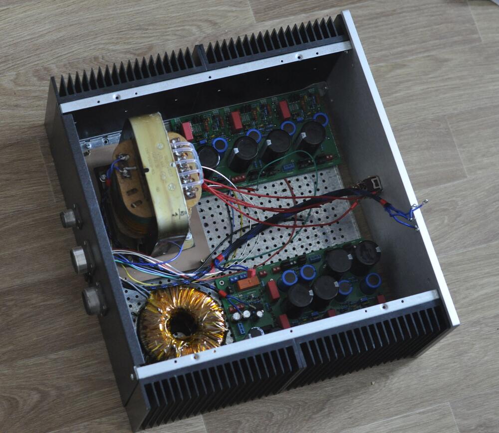

bbest Posted February 17, 2023 Report Posted February 17, 2023 some intermediate results of PSU (followed by jamesmking assembly) Used 0.5mm transformer wires for AC HV (red ones): compact and reliable. 2 Quote

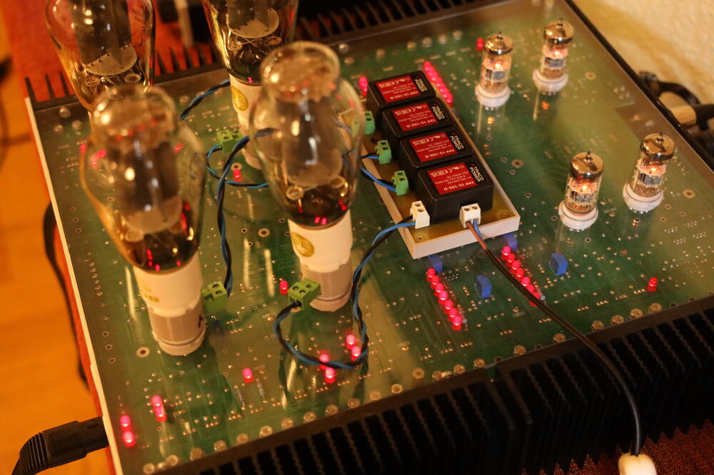

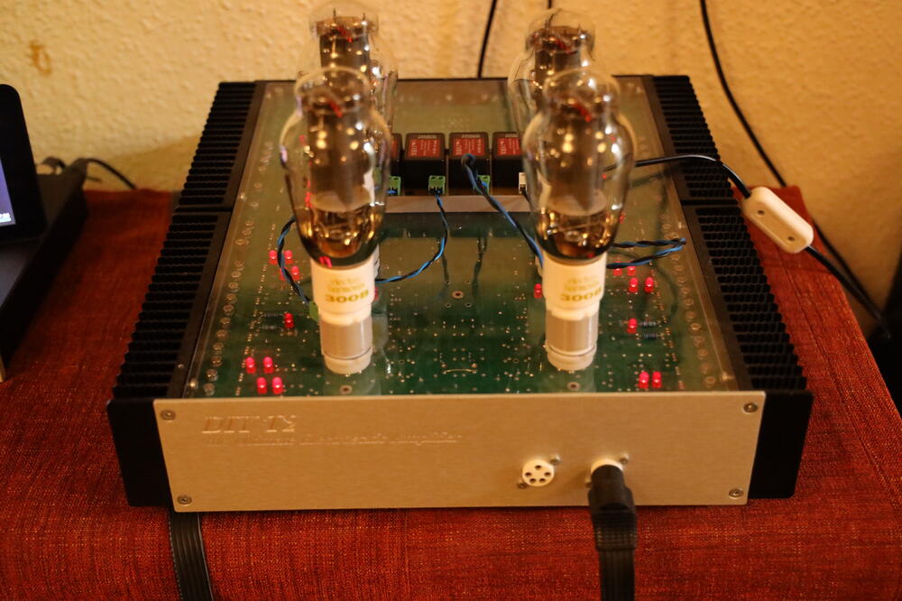

JoaMat Posted April 14, 2023 Report Posted April 14, 2023 DIY T2 amplifier with 300B tubes. Amplifier is built on Kevin’s board. Only modification is decreased high voltages, +/-400V instead of +/-500V. Homemade 300B to EL34 adapters connected to four Traco 5V switched PS for filament power. I only replaced the EL34 with 300B along with the filament power supply. No other adjustments. It works – I’m in no harry to change back to EL34. 12 1 Quote

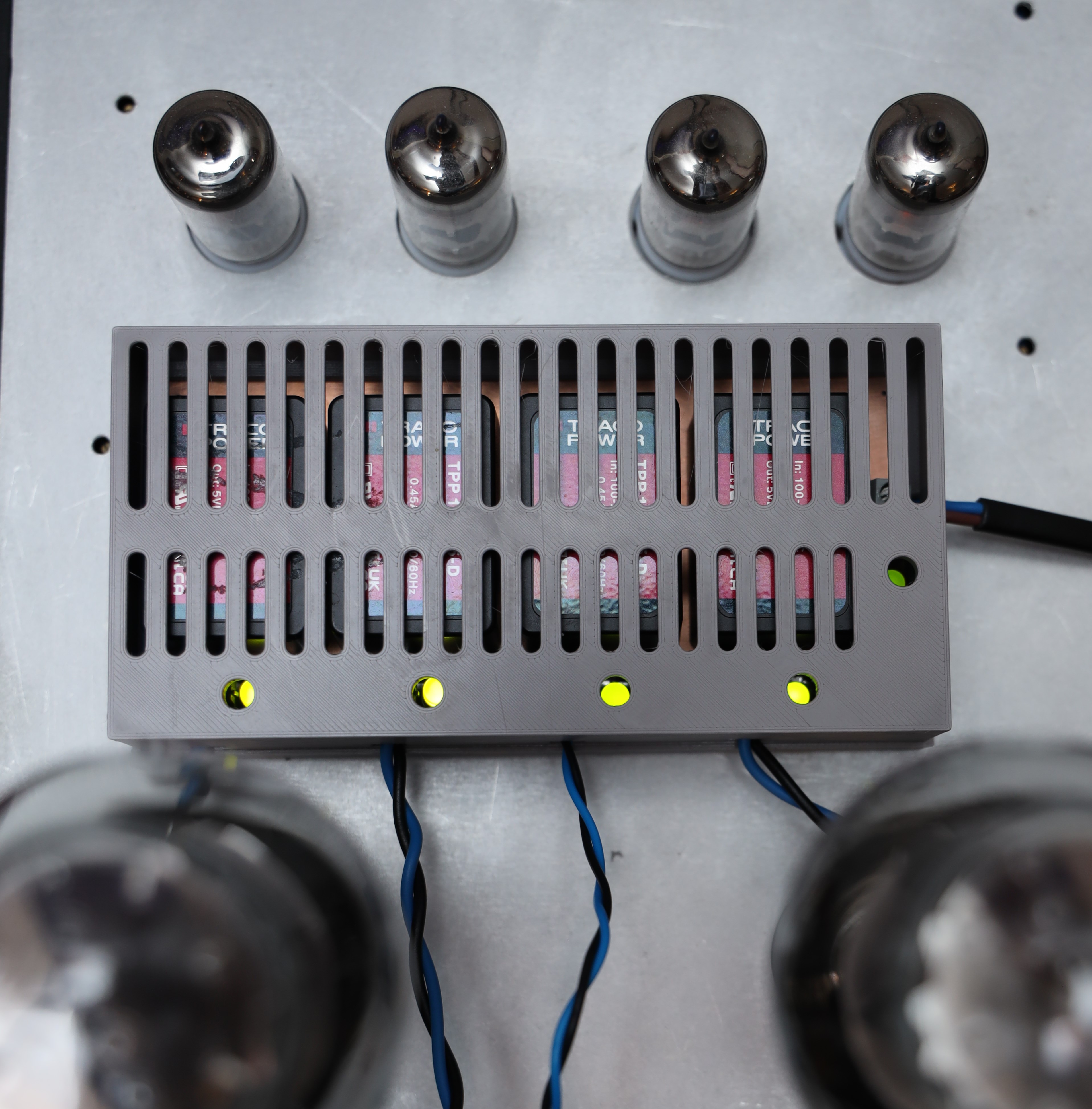

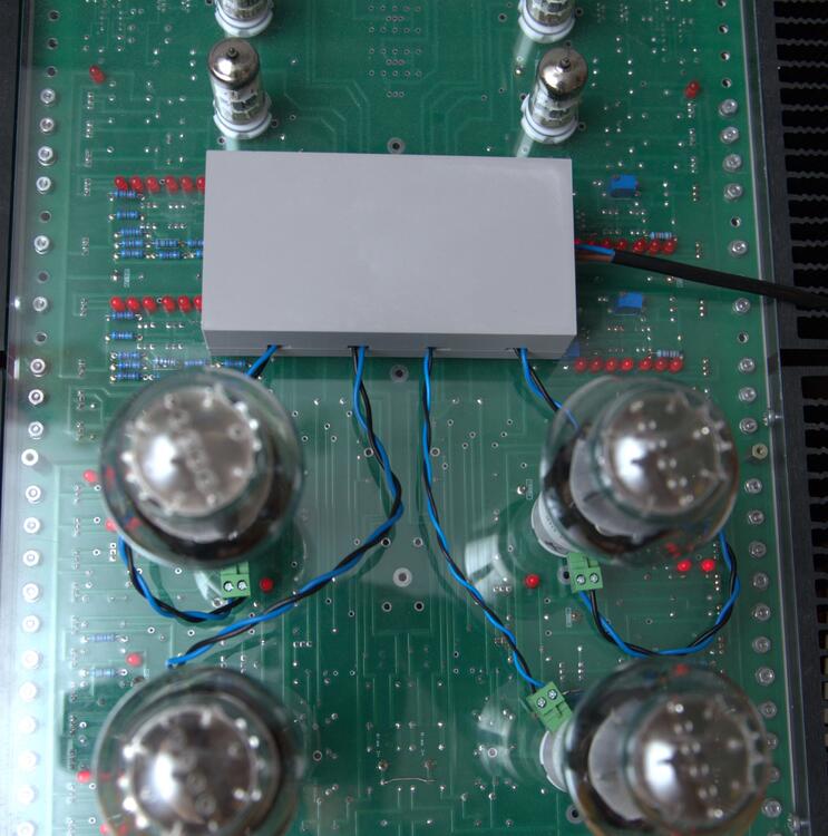

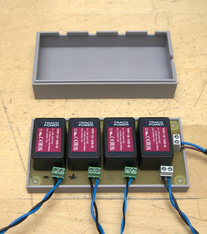

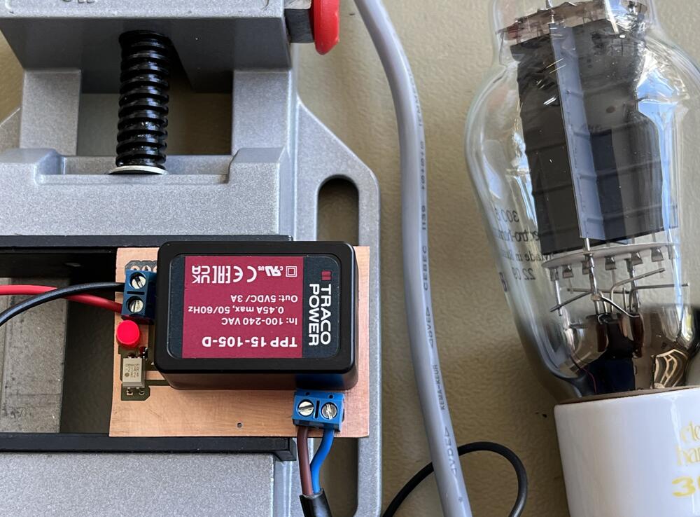

JoaMat Posted April 18, 2023 Report Posted April 18, 2023 I 3D printed a cover to my filament power supply today. Just four Traco TPP 15-105-D and some tblocks. I don’t think my tubes need slow start – and if they do – they are not my tubes. 11 Quote

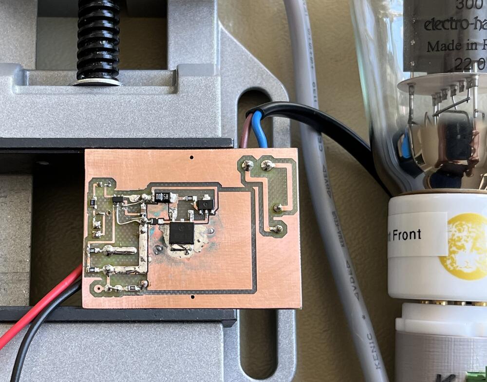

JoaMat Posted April 23, 2023 Report Posted April 23, 2023 (edited) Soft start would be nice... …if it works. Not sure it will, but I know a way to find out. Above is based and inspired by this: Edited April 23, 2023 by JoaMat 2 Quote

JoaMat Posted May 3, 2023 Report Posted May 3, 2023 On 4/23/2023 at 2:01 AM, JoaMat said: …if it works. Not sure it will, but I know a way to find out. Yep, it seems to work. So far so good. No heat problems. Current set to 1.5A and when filament voltage reaches 3.7V solid state relay closes. 4 Quote

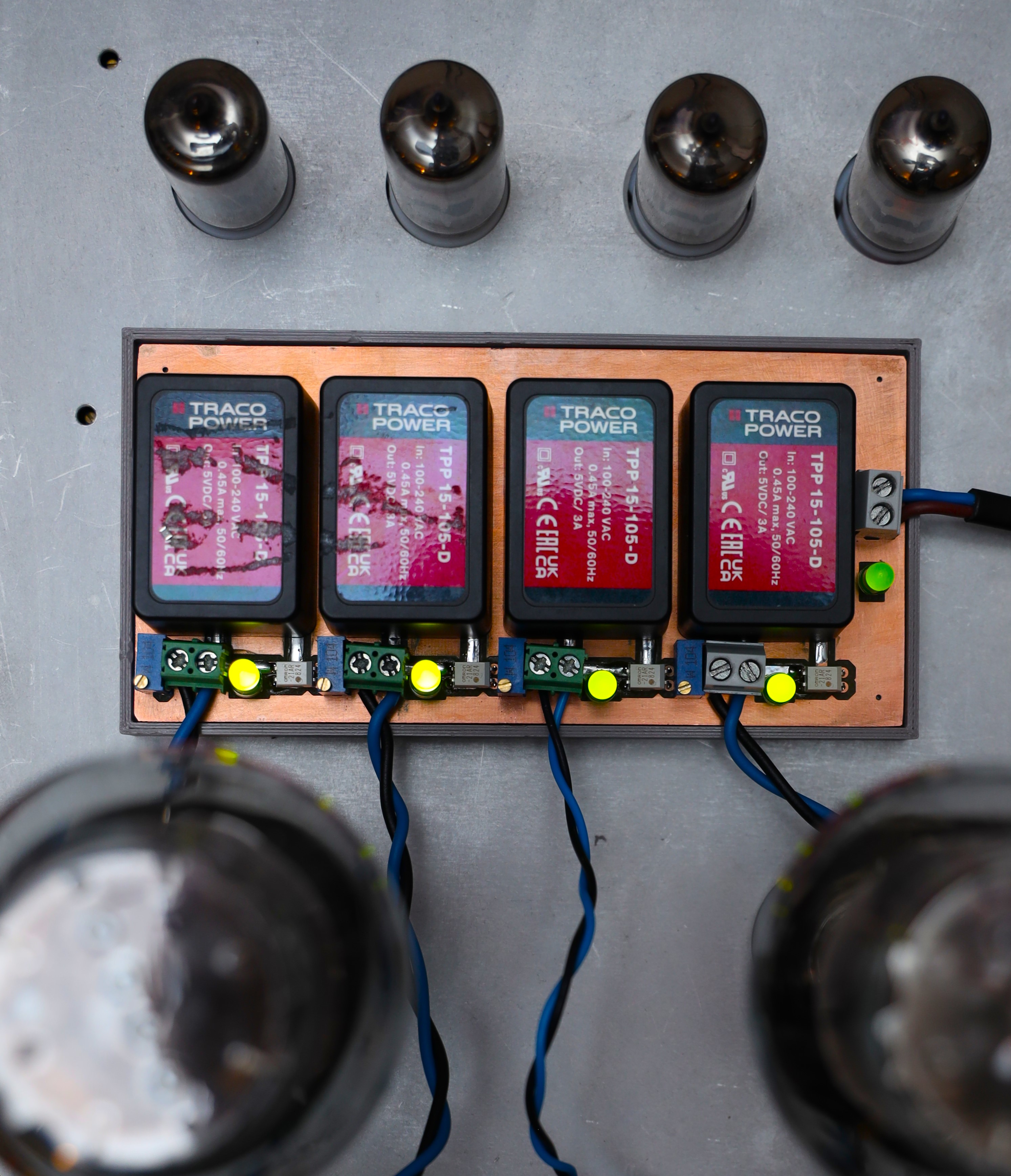

JoaMat Posted May 11, 2023 Report Posted May 11, 2023 Now I think I’ve a 300B filament power unit I like. All smd on bottom side and common (through hole) trimmers and LEDs, and the Tracos of course on top side. With trimmers voltage at tube pins is easily set to 5.00 +/-0,05V. There is voltage drop cross wires and solid-state relays. Cover with ventilation slots. The Tracos produce some heat. 4 Quote
