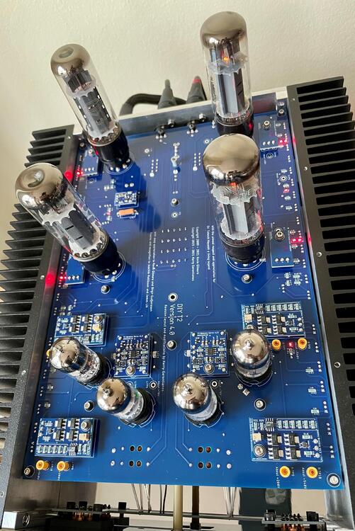

Kerry Posted July 9, 2021 Report Posted July 9, 2021 Here's a new twist on my T2 build. I've added both the HE-90 jack as well as a custom built Teflon HE-60 jack with appropriate voltages/resistances. This one is in black chrome That's the back of the power supply... 26 Quote

Kerry Posted July 11, 2021 Report Posted July 11, 2021 19 hours ago, starcat said: Are you using all original transistors or modified boards with substitutes? Digital attenuator or analog pot in there? I've redesigned my own boards and using the RK50 typically. I'm currently using C3675 (4x for the active batteries), KSA1156, C4685A (output CCS), FJPF2145, STN9360, J79, K216. 11 Quote
JoaMat Posted July 12, 2021 Report Posted July 12, 2021 (edited) Thanks Kerry, for internal picture of and info about your T2. It’s always very inspiring see your work. I assume the four small boards, one at each big tube, are CCS for the two LEDs on main board at respective output CCS. They must differ (schematically) from the original design, mustn’t they? Do you mind tell us what the small boards look like? Edited July 12, 2021 by JoaMat Quote

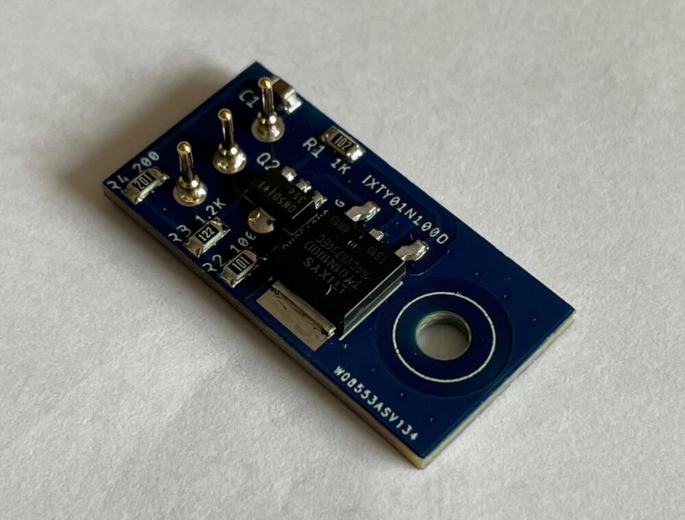

Kerry Posted July 13, 2021 Report Posted July 13, 2021 On 7/12/2021 at 6:57 AM, JoaMat said: Thanks Kerry, for internal picture of and info about your T2. It’s always very inspiring see your work. I assume the four small boards, one at each big tube, are CCS for the two LEDs on main board at respective output CCS. They must differ (schematically) from the original design, mustn’t they? Do you mind tell us what the small boards look like? Yes. It's the CCS for the LEDs that feed the the output CCS. It's a simple cascaded DMOS with a cap on board. Quote
