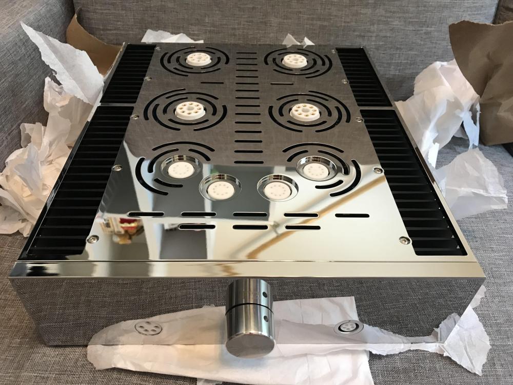

Hugo Posted May 17, 2019 Report Posted May 17, 2019 (edited) Santa came much earlier this year!!! Thank you so much, Kerr.. I mean, Santa! ? Edited May 17, 2019 by Hugo 14 3
nopants Posted May 17, 2019 Report Posted May 17, 2019 looks like Kerry's build Sent from my Pixel 2 XL using Tapatalk 1
Helium Posted May 20, 2019 Report Posted May 20, 2019 Beautiful! Kerry, how did you treat the chassis to achieve polished surface? Seems to be steel, not aluminum? Is is mechanically polished or galvanized? 1
