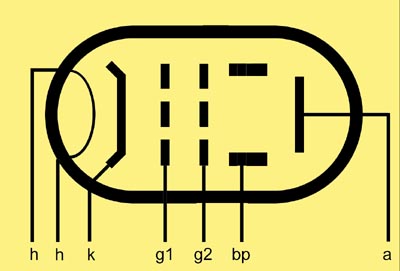

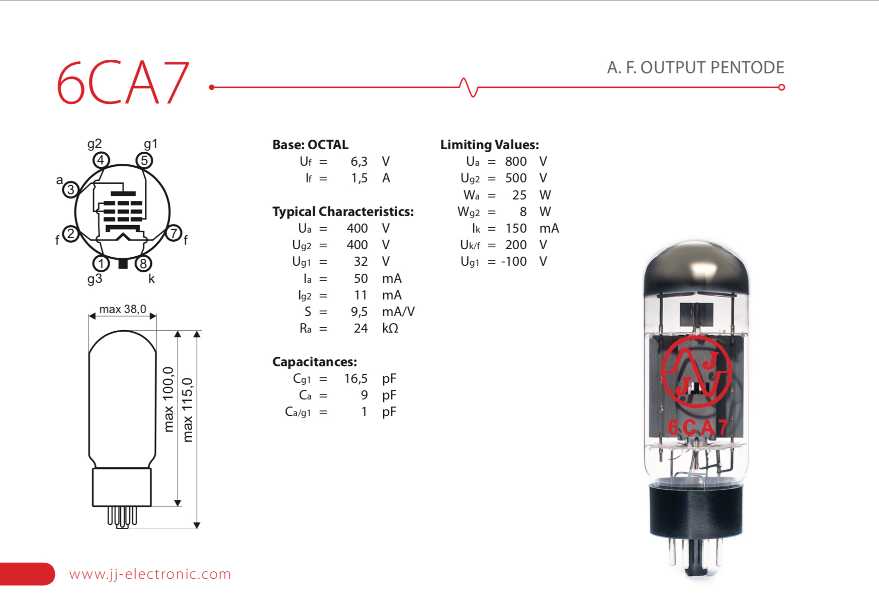

Laowei Posted November 1, 2017 Report Posted November 1, 2017 (edited) More tube weirdness. The JJ 6CA7 is a Beam Pentode, with the beam forming plates connected to pin 1, similar electrically to the pentode EL34’s G3. The other big bottle 6CA7s are Beam Tetrodes, with the beam forming plates internally wired to the cathode (pin 8). Pin 1 is NC in this case. In the GG, G3 is tied to the cathode on the PCB. So no difference electrically between using any EL34 or 6CA7 in that position. In the T2 circuit, G3 is tied to the plate and draws current, so may have stressed the JJ 6CA7 beyond what it could handle. The internally connected EH 6CA7 doesn’t see that. Edited November 1, 2017 by Laowei 1 Quote
Whitigir Posted November 1, 2017 Report Posted November 1, 2017 (edited) 5 minutes ago, Laowei said: More tube weirdness. The JJ 6CA7 is a Beam Pentode, with the beam forming plates connected to pin 1, similar electrically to the pentode EL34’s G3. The other big bottle 6CA7s are Beam Tetrodes, with the beam forming plates internally wired to the cathode (pin 8). Pin 1 is NC in this case. In the GG, G3 is tied to the cathode on the PCB. So no difference electrically between using any EL34 or 6CA7 in that position. In the T2 circuit, G3 is tied to the plate and draws current, so may have stressed the JJ 6CA7 beyond what it could handle. The internally connected EH 6CA7 doesn’t see that. I think you just perfectly explained why my T2 cooked my JJ 6CA7, and not the EH 6CA7, while GG played real nice with JJ6CA7 and I loved it it also seems the explanation, the Beam Tetrode has the second harmonic minimized. Hence why I am hearing the EH6ca7 more balanced than any of the EL34 I threw on the T2 Edited November 1, 2017 by Whitigir Quote

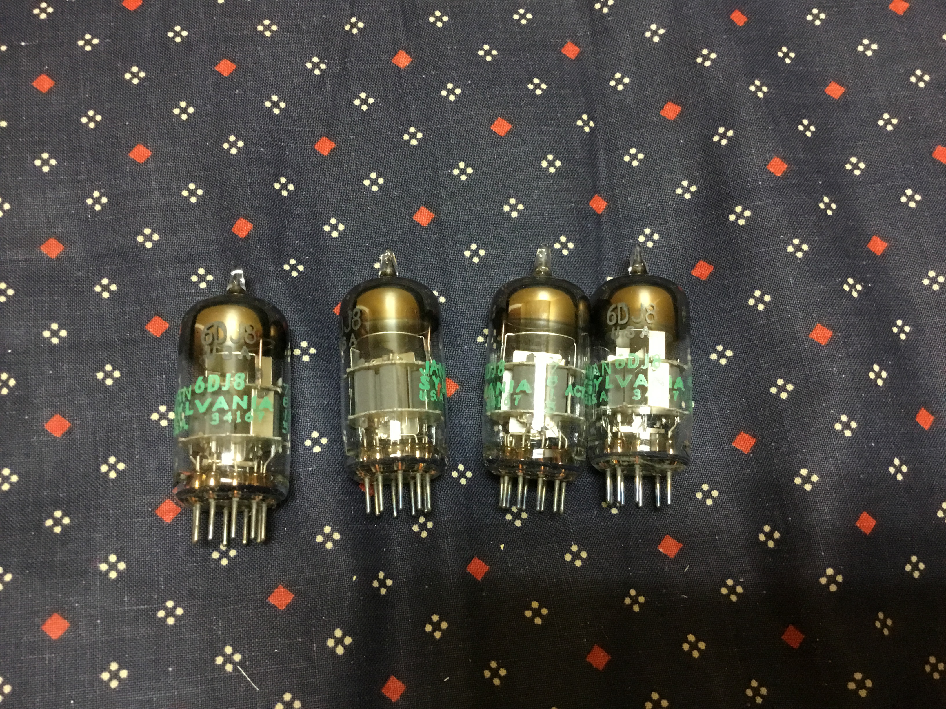

kevin gilmore Posted November 1, 2017 Report Posted November 1, 2017 (edited) those JJ tubes have only 1 hole in the plate per side, the originals have 3 holes and a different configuration of the plate, more square than rectangular. my T2 is still using the same tubes as when I demo'd it at CJ010. I recently did a 100 to 120V conversion on a real T2 for someone on HF. It has the original tubes, 22 years old. (pictures can be supplied if anyone has a real T2 and wants to convert voltages, better than $250 in shipping both ways) The gold aero's are labeled 6dj8 Edited November 1, 2017 by kevin gilmore 2 Quote

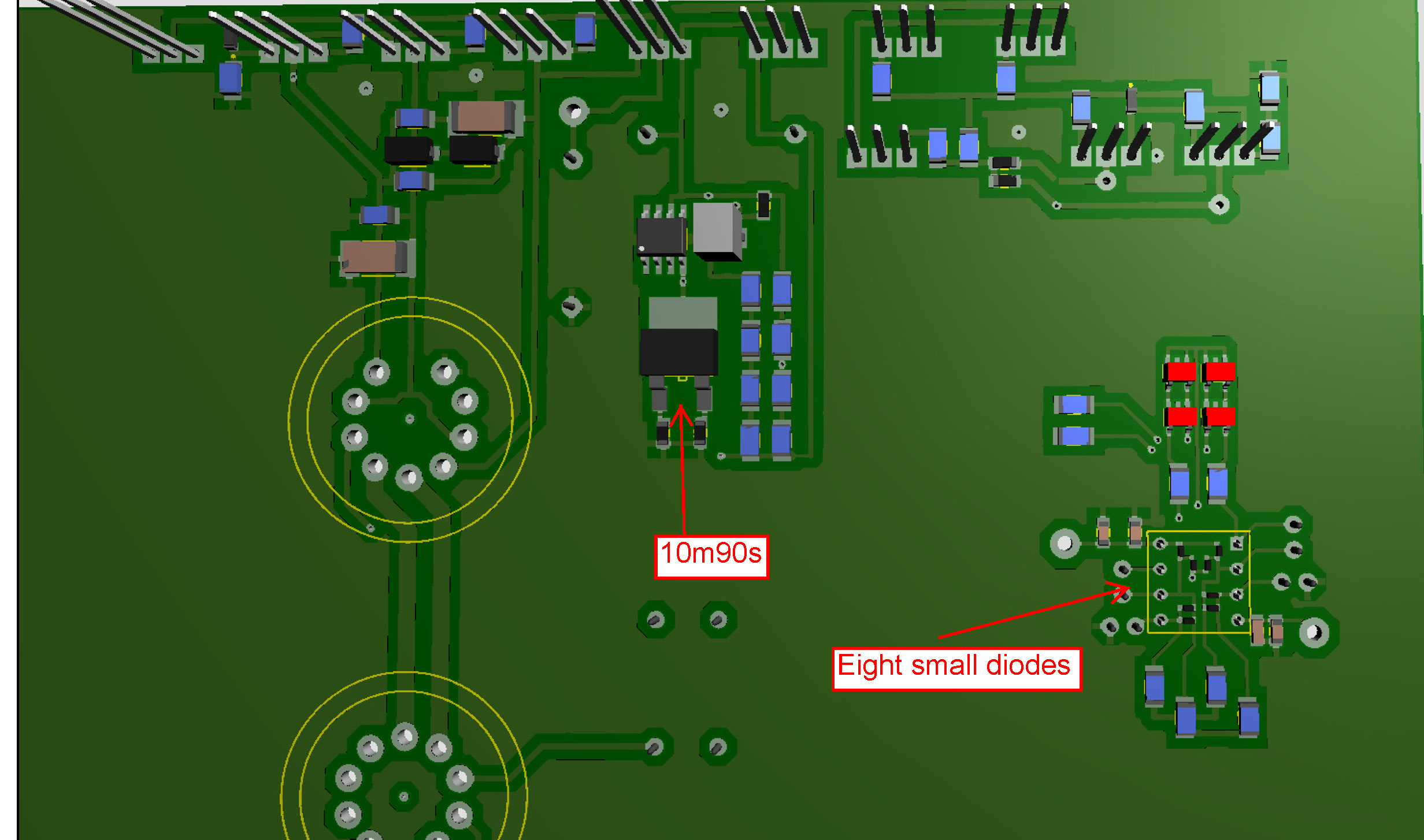

JoaMat Posted November 28, 2017 Report Posted November 28, 2017 Managed to squeeze in the eight diodes under the lf353 op-amp. Batteries resistors killing some 730 volt in series with the LEDs, or in my case lt1021, replaced with 10m90s. Works great in layout software. In real life - 1 Quote
