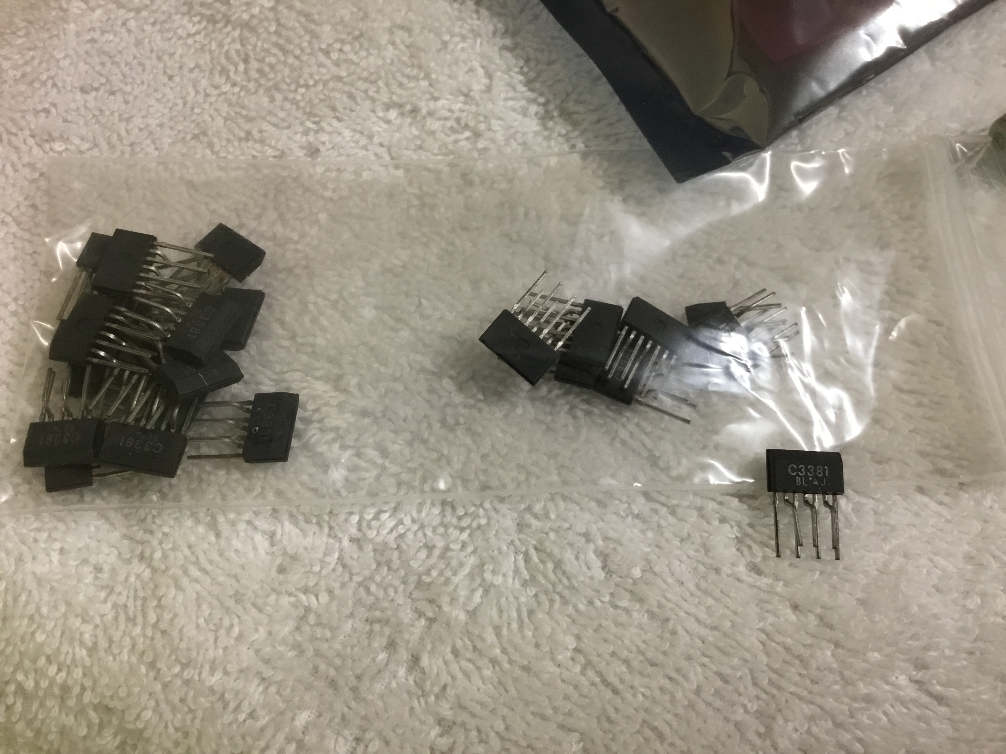

justin Posted May 19, 2017 Report Posted May 19, 2017 a little late to the party but i have what i think are some real 2SC3381-BL on the way. "Like" this post if you think you'd be interested in some. i'll post them up for sale somewhere once i test them 6 Quote

justin Posted May 19, 2017 Report Posted May 19, 2017 7 hours ago, Whitigir said: I am too! I have a few but don't know if it is authentic has anyone ever found a fake part in that package? seems like it wouldnt be worth the effort to fake Quote
GeorgeP Posted May 19, 2017 Report Posted May 19, 2017 Those look real. That said, I am aware of fake 2sk389, but then they used relabelled 2sc3381, so pretty doubtful they would fake a 2sc3381 when they would more likely label them as 2sk389... I did see some questionable 2sc3381 with flat legs, but the ones pictured are squared, which matches the spec sheet. Quote
