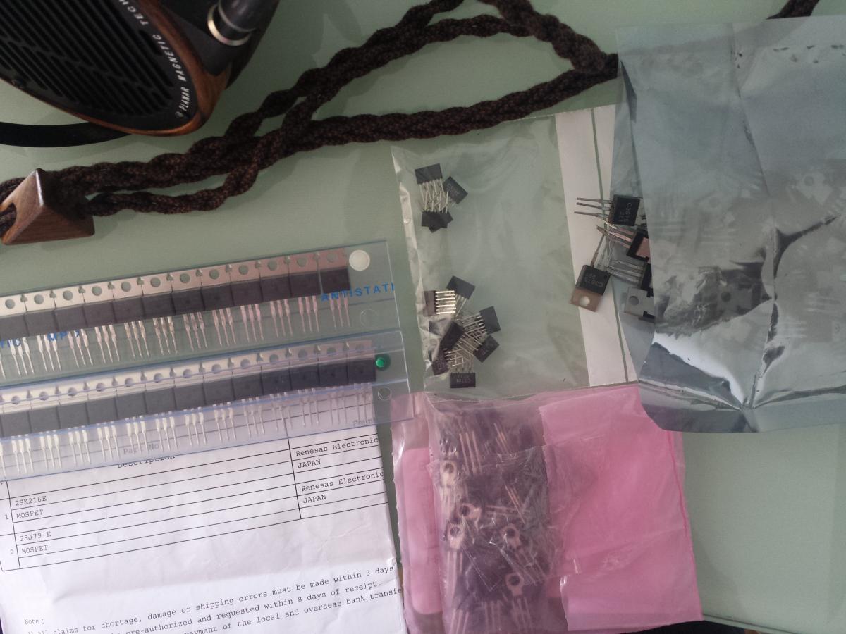

G600 Posted July 31, 2015 Report Share Posted July 31, 2015 Big children are happy with weired toys... At least no Lenesas here ! (always crappy pictures with me) 1 Quote Link to comment Share on other sites More sharing options...
