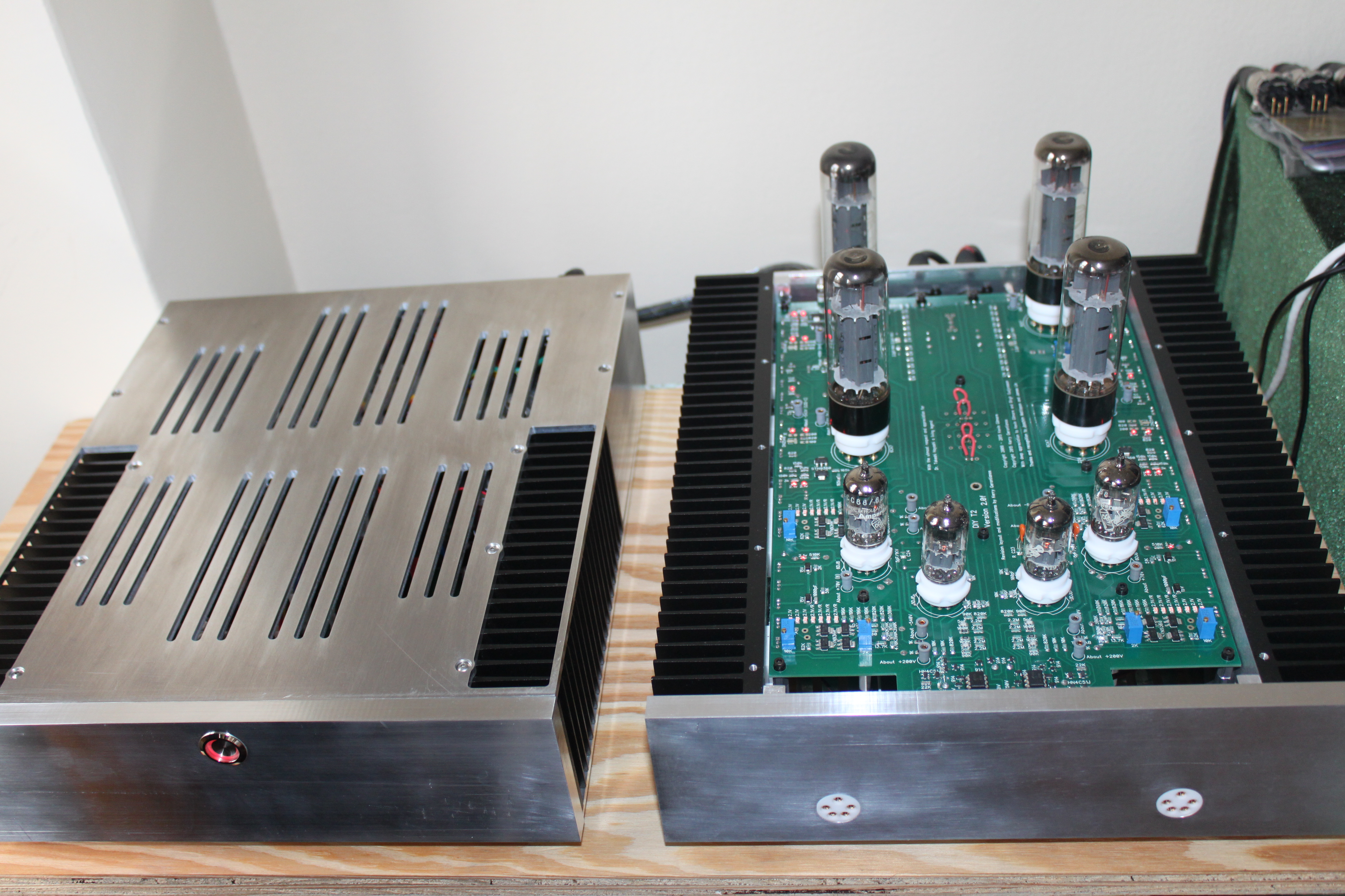

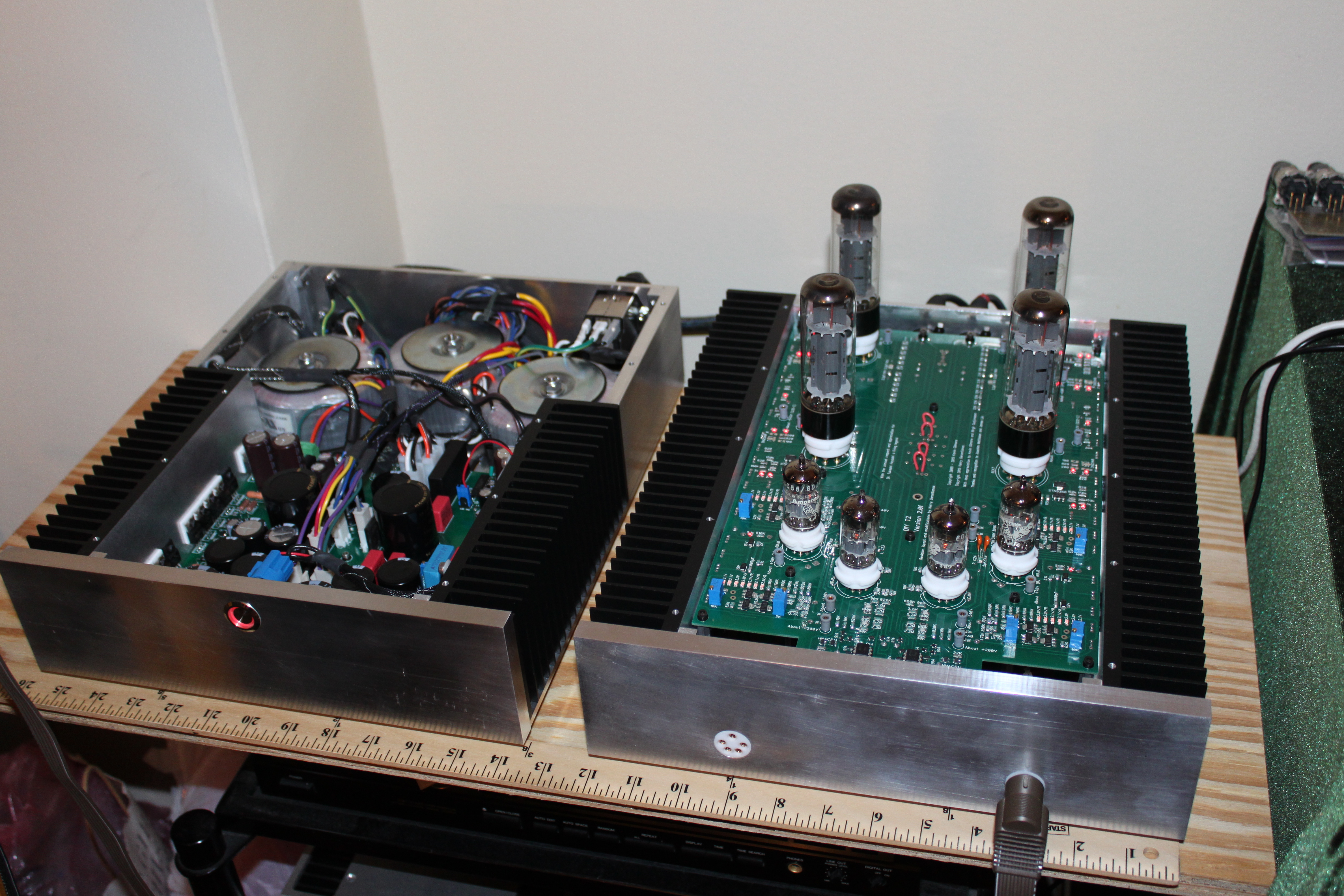

stax fart Posted June 1, 2016 Report Posted June 1, 2016 OMG that looks better than any comercial amp, regardless of price. You sir have a gift, also, I'm sure it sounds terrific.
Kerry Posted June 2, 2016 Report Posted June 2, 2016 Thanks everyone. Just two more plates to mill and the chassis are done, then off to have them finished The pot will come shortly. I'm going to use an encoder and Kevin's digital attenuator boards. 1
