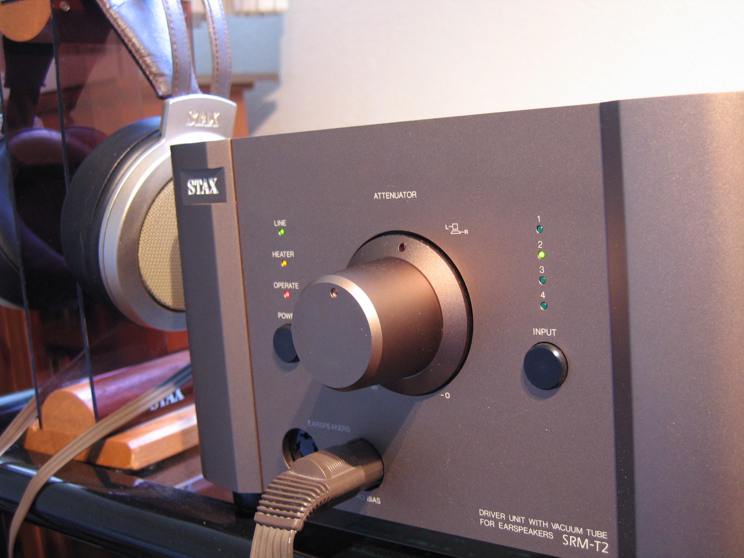

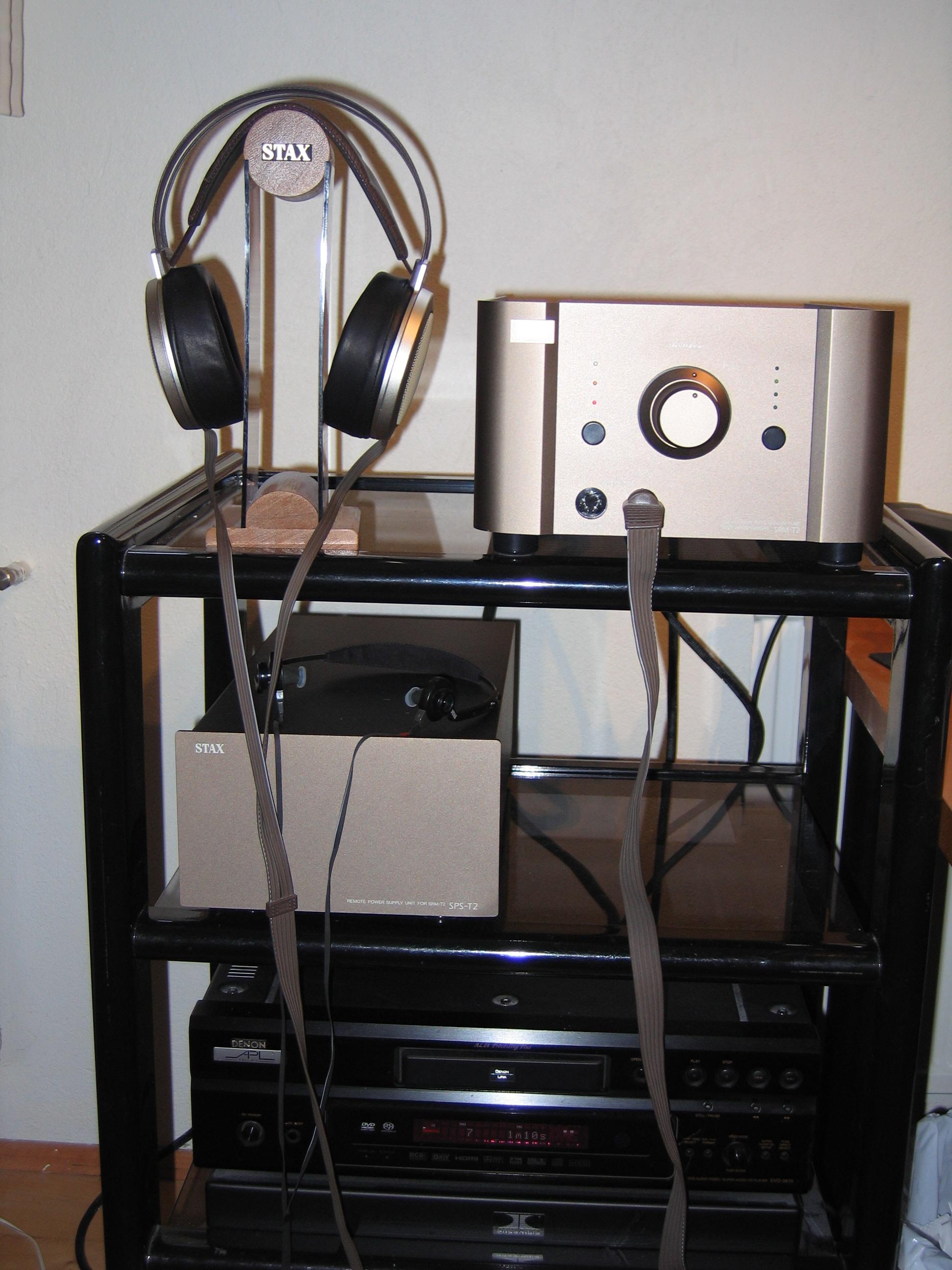

spritzer Posted April 30, 2019 Author Report Posted April 30, 2019 Done and some nostalgia as it's been a decade since this was going on... 8 Quote
tumpux Posted May 1, 2019 Report Posted May 1, 2019 Beautiful.. What happen with this amp on a daily basis? Is it still work? Is it true that on the back of the amp unit, there is a plate with the owner's name? Any plan to stuff a Carbon into this shell for its 30th anniversary? Quote
spritzer Posted May 1, 2019 Author Report Posted May 1, 2019 I sold it back in 2010 as it makes no sense to keep it. It doesn't sound as good as people think it does and the hum bothered me a lot. Well that and it was doomed to fail so I just recapped it and moved it on. Quote

spritzer Posted May 1, 2019 Author Report Posted May 1, 2019 It's a feature that it can cook eggs on the top panel... Kinda funny when the only option in Iceland is to take off the top panel and have a fan close by to cool it. 2 Quote

spritzer Posted May 2, 2019 Author Report Posted May 2, 2019 8 hours ago, tumpux said: Some more questions, from the pictures look like there are sleeves on the input stage tubes. Are they for cooling purpose? Is the original T2 use any exotic capacitors? I don't have a soft spot for what was a compromise from the start. The chassis they ended up with was not what they wanted to do as the tubes were supposed to be in chimneys to take away a lot of the heat but it was probably too expensive. The stuff on the input tubes are shields to try and keep crap out of them. They used nice caps but no audiophile BS. Quote
bwck2000 Posted May 2, 2019 Report Posted May 2, 2019 Wow...... The pics is back......true gem in head-fi history, thank you for uploading them again after years btw the t2 is much smaller than I thought with a headphone stand at the side for comparison and the way they put all the relay at the back as well as the way they put two sands in a single heatsink is funny Quote
