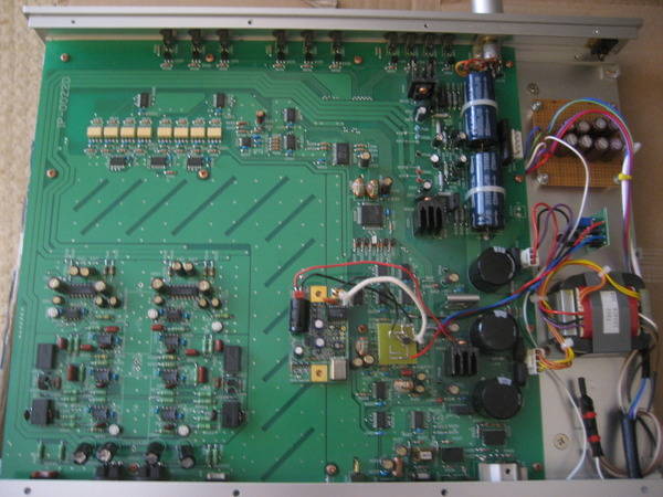

padam Posted February 11, 2010 Report Share Posted February 11, 2010 So I got the Parasound 1600, how can I get it to work on 230V? There are three transformers if I am not mistaken(see picture), do I have to replace those or it is easier just to use a voltage converter? (Are there any which are cheap and don't degrade the SQ?) Thanks! Quote Link to comment Share on other sites More sharing options...
n_maher Posted February 11, 2010 Report Share Posted February 11, 2010 So I got the Parasound 1600, how can I get it to work on 230V? There are three transformers if I am not mistaken(see picture), do I have to replace those or it is easier just to use a voltage converter? (Are there any which are cheap and don't degrade the SQ?) Thanks! It sure looks like there are jumpers on the pcb for changing the input voltage but they also look like they are soldered in which may make changing them a bear. I'd probably just get a properly sized stepdown trafo and call it a day. Quote Link to comment Share on other sites More sharing options...
spritzer Posted February 11, 2010 Report Share Posted February 11, 2010 Those are the jumpers and you need to solder in some new ones, i.e. move the wiring from parallel to series on the primaries. Quote Link to comment Share on other sites More sharing options...
veloaudio Posted February 11, 2010 Report Share Posted February 11, 2010 From the manual: Rewiring for 220-240 V 50 Hz Operation The D/AC-1600 HD can be rewired for operation abroad. Please refer this conversion to a skilled electronics technician to avoid injury or possible harm to the unit. The main power supply printed circuit board has three separate power transformers. Nearby the transformers you will find jumper wires that correspond to the various primary windings of each power transformer. A total of six jumper wires are connected to the circuit board for 120 V operation. Two jumpers are connected near each transformer; each jumper has 120 V printed alongside it on the circuit board. Only 3 jumpers are connected to the circuit board for 220-240 V operation One jumper is connected near each transformer; each jumper has 220 V printed alongside it on the circuit board. For 220-240 V operation, you must also disconnect the six 120 V jumpers. Quote Link to comment Share on other sites More sharing options...

Azazel Posted February 12, 2010 Report Share Posted February 12, 2010 Congrats Padam! To make sure you do not do something wrong, just check input resistance with a simple polimeter before and after the V change: must be 4x afterwards on every transformer (same primaries wired parallel for 110V, are wired now series for 220V). Quote Link to comment Share on other sites More sharing options...

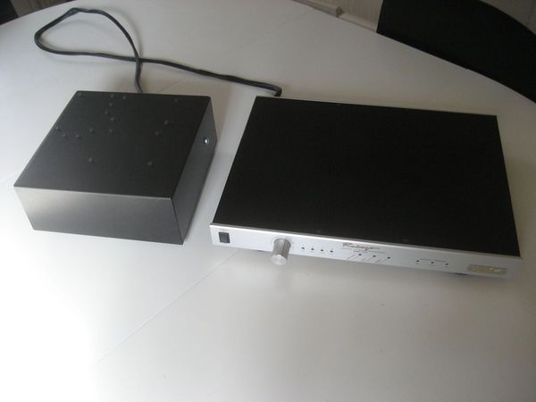

blubliss Posted March 10, 2010 Report Share Posted March 10, 2010 Any thoughts on this DAC? Maybe since it is modded it is not wise? I am interested to try the Reimyo sound and I only have one measly DAC . Reimyo dap-777 mk I For Sale | AudiogoN [ATTACH=CONFIG]2812[/ATTACH] [ATTACH=CONFIG]2813[/ATTACH] Quote Link to comment Share on other sites More sharing options...
veloaudio Posted March 11, 2010 Report Share Posted March 11, 2010 Any thoughts on this DAC? Maybe since it is modded it is not wise? I am interested to try the Reimyo sound and I only have one measly DAC . Reimyo dap-777 mk I For Sale | AudiogoN [ATTACH=CONFIG]2812[/ATTACH] [ATTACH=CONFIG]2813[/ATTACH] That would be mine. I bought it here from Randerson3024 (Bob). I'll give you a deal if you're interested. Quote Link to comment Share on other sites More sharing options...
