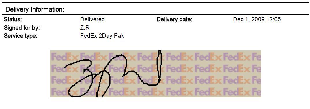

Grahame Posted December 1, 2009 Report Posted December 1, 2009 In other news, my impressions have made it to JHA Anybody know who the mysterious Z.R. is? Quote

The Monkey Posted December 1, 2009 Report Posted December 1, 2009 In other news, my impressions have made it to JHA Anybody know who the mysterious Z.R. is? Could be Zac Penrod. And how dare you derail the derailment. Quote
Hopstretch Posted December 1, 2009 Report Posted December 1, 2009 Anybody know who the mysterious Z.R. is? Quote

Dusty Chalk Posted December 1, 2009 Report Posted December 1, 2009 Those tubes are huge!Anybody know who the mysterious Z.R. is?Looks like an exclamation point at the end, too. Quote

guzziguy Posted December 1, 2009 Report Posted December 1, 2009 In other news, my impressions have made it to JHA Anybody know who the mysterious Z.R. is? Could be Zac Penrod. And how dare you derail the derailment. Zoltan Rorschach. He's in charge of interpreting the impressions. Quote
