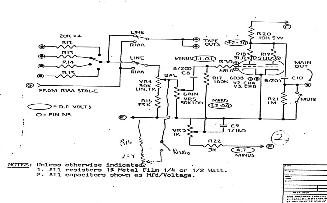

luvdunhill Posted June 12, 2009 Report Posted June 12, 2009 cool! So, since you have your own thread, Pars mentioned something about you saying that replacing a plate resistor in his Counterpoint preamp with a DMOS type CCS was a bad idea. I was wondering, why would something like this ever be a bad idea? I don't really know the circuit, but the question was asked in the general and this specific example was brought up as a counterpoint (heh) to why replacing a plate resistor with a solid state CCS wouldn't always be a good idea... Quote
Pars Posted June 12, 2009 Report Posted June 12, 2009 Actually I had been talking to Doug in a thread over on hf regarding that. I think it was nikongod in chat a couple of weeks ago here who said he thought it would be a bad idea after looking at the schematic. Quote
luvdunhill Posted June 12, 2009 Report Posted June 12, 2009 ok, I apologize, my facts are wrong, but the question still exists Quote
nikongod Posted June 12, 2009 Report Posted June 12, 2009 I thought it was a bad idea because the rest of the pre has gone to such great lengths to use no SS parts anywhere. Tube rectifier, pentode voltage regulator,, the whole thing is grid biased (even the phono-stage). The only silicon is in the heater & biassing supply. For sure the CCS would improve PSRR/SNR, linearity, and bump the gain, but I think its cool having an amp with no SS parts anywhere. I guess my opinion is more philosophical than scientific. Quote
Pars Posted June 12, 2009 Report Posted June 12, 2009 I thought it was a bad idea because the rest of the pre has gone to such great lengths to use no SS parts anywhere. Tube rectifier, pentode voltage regulator,, the whole thing is grid biased (even the phono-stage). The only silicon is in the heater & biassing supply. For sure the CCS would improve PSRR/SNR, linearity, and bump the gain, but I think its cool having an amp with no SS parts anywhere. I guess my opinion is more philosophical than scientific. Ahh, gotcha. When you said that about the ccs, I either missed why or whatnot. There is another ss piece in here: SA-5/5.1 Level I Power Supply Upgrade. As in the audio stage, I install far better resistors and film capacitors, and upgrade the aluminum electrolytic capacitors, using Black Gate Powdered Graphite capacitors. The solid-state constant-current source for the error amplifier tube is eliminated, removing the final source of "transistory" colorations. Price for SA-5/5.1 Level I Power Supply Upgrade: $1150 Add $110 setup fee to this price if not done with an "LSP" upgrade.) A Siliconix CR160 CRD is used here, protected by a 91V zener from getting over-voltaged. I was thinking about replacing this with an IXYS DNR2450 (PN off the top of my head, bought one but haven't tried it yet) so I could get rid of the zener, etc. Quote
luvdunhill Posted June 12, 2009 Report Posted June 12, 2009 I thought it was a bad idea because the rest of the pre has gone to such great lengths to use no SS parts anywhere. Tube rectifier, pentode voltage regulator,, the whole thing is grid biased (even the phono-stage). The only silicon is in the heater & biassing supply. For sure the CCS would improve PSRR/SNR, linearity, and bump the gain, but I think its cool having an amp with no SS parts anywhere. I guess my opinion is more philosophical than scientific. ok, thanks Maybe Chris needs to see if he has enough heater and real estate for a pentode CCS then! Quote
Pars Posted June 12, 2009 Report Posted June 12, 2009 Nah, this is one of thos '80s slim designs made to appeal to the SS peeps looking at Levinson, etc., so it is very space challenged. I don't want to destroy the resale value, so if I want better I'll just get rid of it and buy something else (or build it). I do have an Aleph P1.7 partially done (and languishing) Quote
