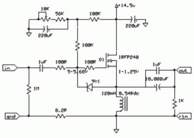

dsavitsk Posted June 9, 2009 Report Posted June 9, 2009 Here's another variation I am in the middle of:

dsavitsk Posted June 9, 2009 Report Posted June 9, 2009 hey, thats a fun idea. What about using those LU1014D power JFETs? I'm sure it would work great, but I hate hunting down obscure solid state parts. Someone should try it, though. So far, my experiments with the topology have been really promising.
luvdunhill Posted June 9, 2009 Report Posted June 9, 2009 I'm sure it would work great, but I hate hunting down obscure solid state parts. Someone should try it, though. So far, my experiments with the topology have been really promising. I'd expect more chokes from you Why not something like a choke loaded source follower?
dsavitsk Posted June 9, 2009 Report Posted June 9, 2009 I'd expect more chokes from you Why not something like a choke loaded source follower? DC offset. Depending upon the OPT used, the offset between sides has to be really small. For instance, I am working on the version below as an IV to a differential NOS AD1865N DAC. Talking with K&K, offset between sides needs to be in the less than 1mV range, with lower being better. I went through 100 2sk170's, and while I found reasonably match parts, I am still going to need trimmers to be able to make adjustments to get things in that range making choke loading impractical. In fact, I may need to pick up more fets to find better matches. With the Cinemag on the headphone driver, offset issues are slightly relaxed, but not really by much -- it is still a fully interleaved 80% nickel core. More than a few microamps of current will still saturate it. However, barring the offset issue, I wonder if dual chokes on the same core might work for both sides ... By the way, the topology is in use here: http://www.diyaudio.com/forums/showthread.php?s=&threadid=141865 TDA1543's, cheap OPT's (Cinemags that cost $18) and it sounds great -- one of my favorite things I've built.
luvdunhill Posted June 10, 2009 Report Posted June 10, 2009 (edited) I went through 100 2sk170's, and while I found reasonably match parts Doug, I have a considerable number of LSK170 that are already grouped by Idss. In general, they fall into the Toshiba "V" grade Idss classification. I'd be more than happy to ship you a bag of them and let you choose whatever pairs you'd like. Failing that, I have a considerable number of the Toshiba parts (both binned by Idss, and still in original packaging) that I could send as well. I use a similar topology with my NOS DAC, except using a eight legged devil instead of a transformer I guess I was referring more to this type of topologies discussed in this thread, but I appreciate the information about DC offset. I wouldn't have though about that diyAudio Forums - CHOKE Loaded MOSFET, easy to build - Page 1 I think you need your own thread around here, many people enjoy picking your brain about things In fact, your name came up the other day with respect to a CCS for Pars Counterpoint Preamp. Maybe a mod around here can make that happen (thread split)! Edited June 10, 2009 by luvdunhill
luvdunhill Posted June 10, 2009 Report Posted June 10, 2009 sorry, right thread, but ambiguous post. Here's a schematic.
