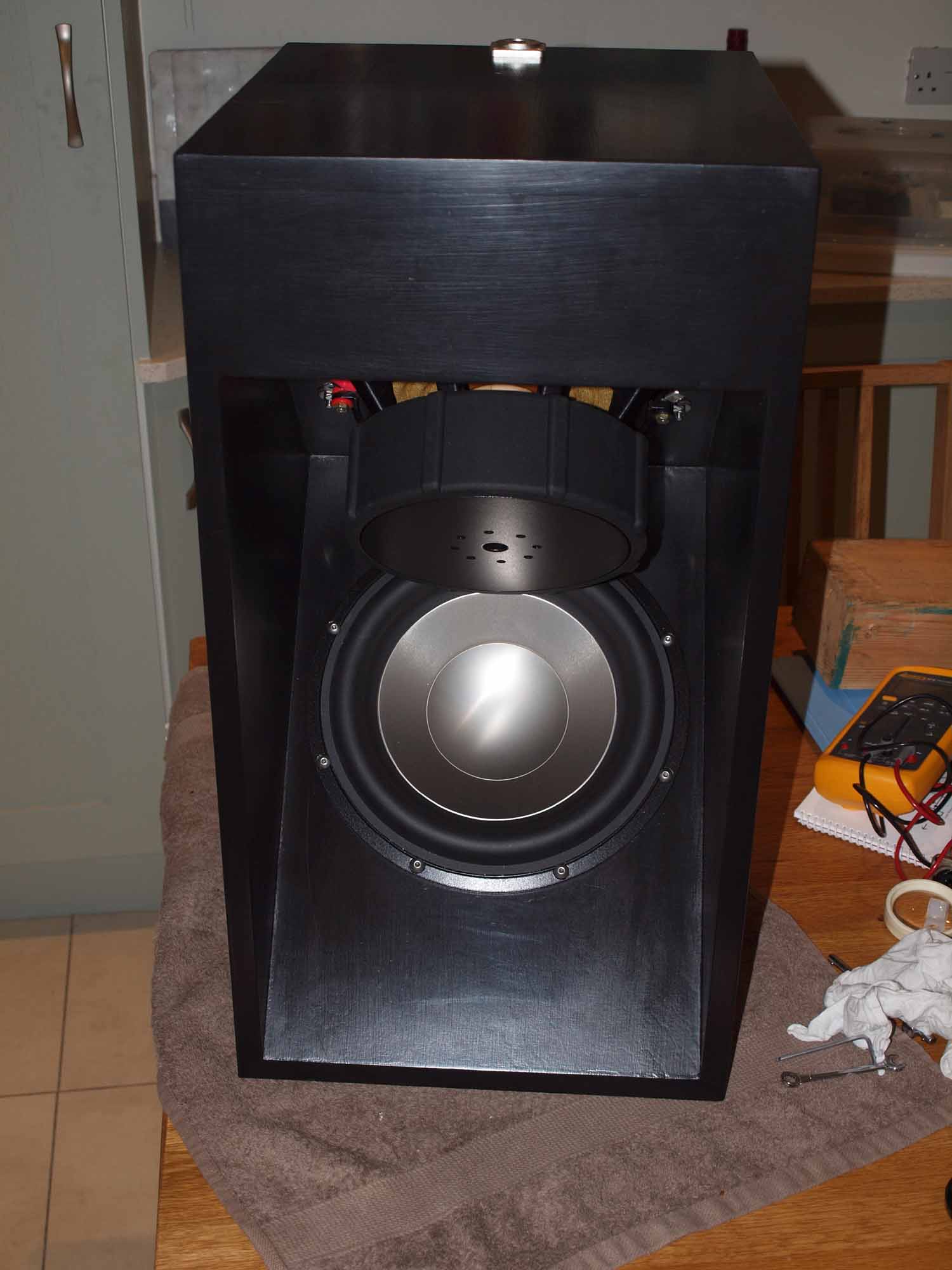

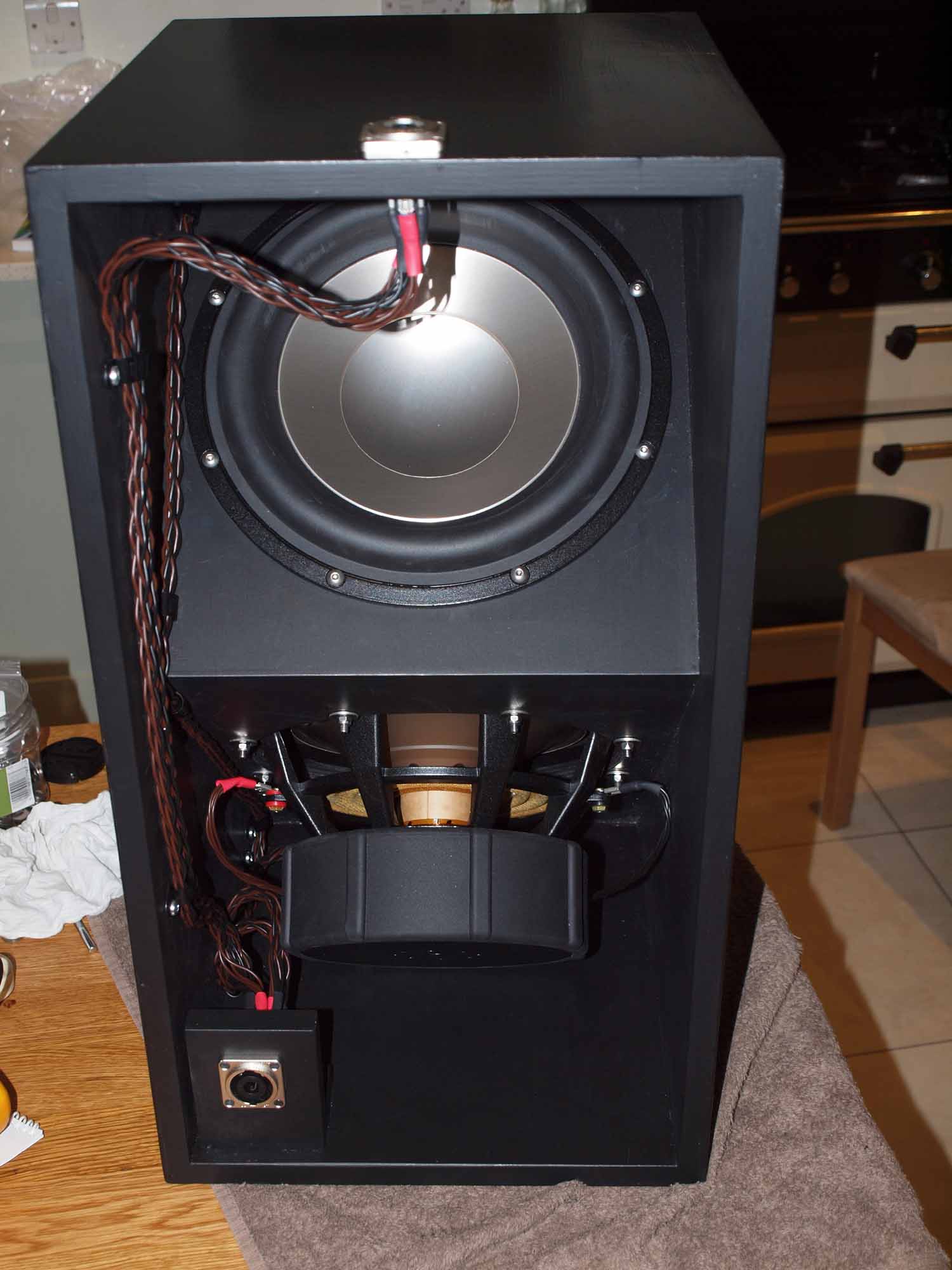

Craig Sawyers Posted October 26, 2020 Report Posted October 26, 2020 I'd definitely go the M-frame route from that website. Sure you need two drivers per side, but you get the benefit of (at least to first order) distortion cancellation. These were mine during building maybe 5 years ago. 6 Quote
luvdunhill Posted October 27, 2020 Report Posted October 27, 2020 I'd definitely go the M-frame route from that website. Sure you need two drivers per side, but you get the benefit of (at least to first order) distortion cancellation. These were mine during building maybe 5 years ago.http://content.head-case.org/monthly_2020_10/1716163796_Bass1a.thumb.jpg.35861bb05e5c74bac9f1ad9e72f89ad6.jpghttp://content.head-case.org/monthly_2020_10/1197123693_Bass1b.thumb.jpg.786acd945dc188cf6794c4297ff696de.jpgHow directional are these? Specifically, if the solid sides “faced” the listener Quote
Craig Sawyers Posted October 27, 2020 Report Posted October 27, 2020 They are crossed over at 120Hz, which has a wavelength of 2.9 metres. which completely ignores the structure (because it is so much smaller than the wavelength of the sound; the structure is acoustically small). 1 Quote
