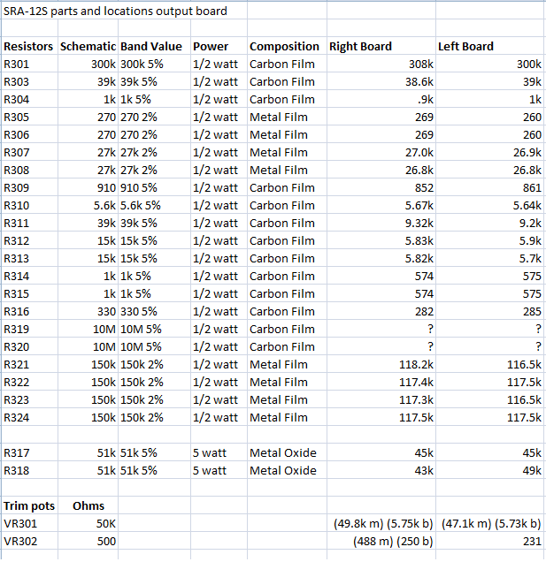

I also have some measurements for the resistors but they were taken on the board so not terribly accurate sometimes. When I replaced some, they usually would measure within tolerance when removed from the PCB.

The static noise you hear on the channel is either an out of spec leaky resistor or bad output transistor. The input jfets (2sk30's) would not be the problem. You need to source the original TO-3 transistors and replace those ones (I have some NOS stock I can sell if you need some). Also you can't measure the resistors as it is as they will all show up out of tolerance especially the 150kohm resistors because the 500ohm trimpots adjust the balance of the output. To measure the resistors properly you need to isolate it from the trimpots or desolder them one by one and measure it that way, and most likely it will measure fine (but the dielectric properties can be out of spec when high voltage and heat is presently going through the resistors). You should only see 290-300vdc between the base and collector of the output transistors. I'd replace all the resistors with uprated equivalents and replace those transistors with original Toshiba TO-3 units.

EDIT: Installed full resistor replacements, all Xicon and big ass Dale RN60D's. As everyone probably figured, the static was after all a bad resistor. Still have the original TO-3 replacement transistors coming in too thanks to some help from you guys, but it sounds great right now with the SR-007. I actually like it better than my old feedback-modded 727A. We'll see if the original configuration changes that.
