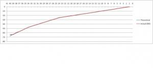

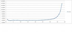

luvdunhill Posted March 30, 2009 Author Report Posted March 30, 2009 Cool! I'll try it out! The below results are using the VLOOKUP function. So, this turns out to give some unexpected results. The basic schematic is a series attenuator like this: Notice I'm using a three slope curve, not the traditional log curve. The issue is once you get to the higher attenuation steps, things go crazy. I'm still trying to figure out why. At first, I figured it was because there are course E96 values < 10 ohm in film resistor line I'm looking at. But, then I just set the values < 10 to the exact theoretical value, and Exhibit A (atten1.jpg) is the resulting graph. Notice the deviation. My other theory is somehow the error from the series resistors above somehow catches up and throws the balance off... anyways, any ideas? So, next I plotted the error between the theoretical value and the E96 values on another graph, see Exhibit B (atten2.jpg) and the non linearity at both ends of the stepper becomes obvious. Now, if you sit and play with the lower values, you can actually coerce the values a bit, but then you get this strange deal with the first 2 steps, where you have a NOOP of sort and the volume doesn't change. This is rather strange, but maybe acceptable. See atten3.jpg and atten4.jpg. Still working on some other features, then I can post the spreadsheet. A few questions in addition to comments on the above: What's the best way to provide a "mute" stop (yeah, stupid question I know)? Is there any reason I cannot use the current sensing thin film resistors for values < 10 ohm, or alternately, how hard is it to mount smaller SMD resistors on 0805 pads, if perhaps they are available < 10 ohm in smaller case sizes? Quote

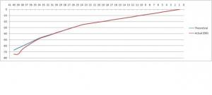

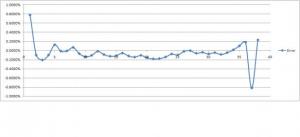

luvdunhill Posted March 30, 2009 Author Report Posted March 30, 2009 meh, I figured all the above out, plus how to move the non-linearity to the last 2 loudest steps.. even then, my max deviation is 0.50% That VB function didn't work for me, but writing an appropriate one was rather simple it turns out. Okay, so next order business is a Bode plot for frequency response. Of course, Excel seems to be a fail on that out of the box. So... rolling up the sleeves.. Quote
