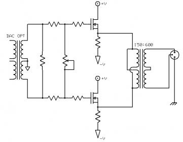

dsavitsk Posted May 8, 2009 Report Posted May 8, 2009 Do you guys have any opinions regarding the RS1? The RS-1s are a good option since you won't need any gain to power them from your DAC, just a buffer. Here is some detail on what they need. Why don't you just build something? A couple of back to back source followers into a 150:600 transformer will sound great, and should match the character of the DAC pretty well.
