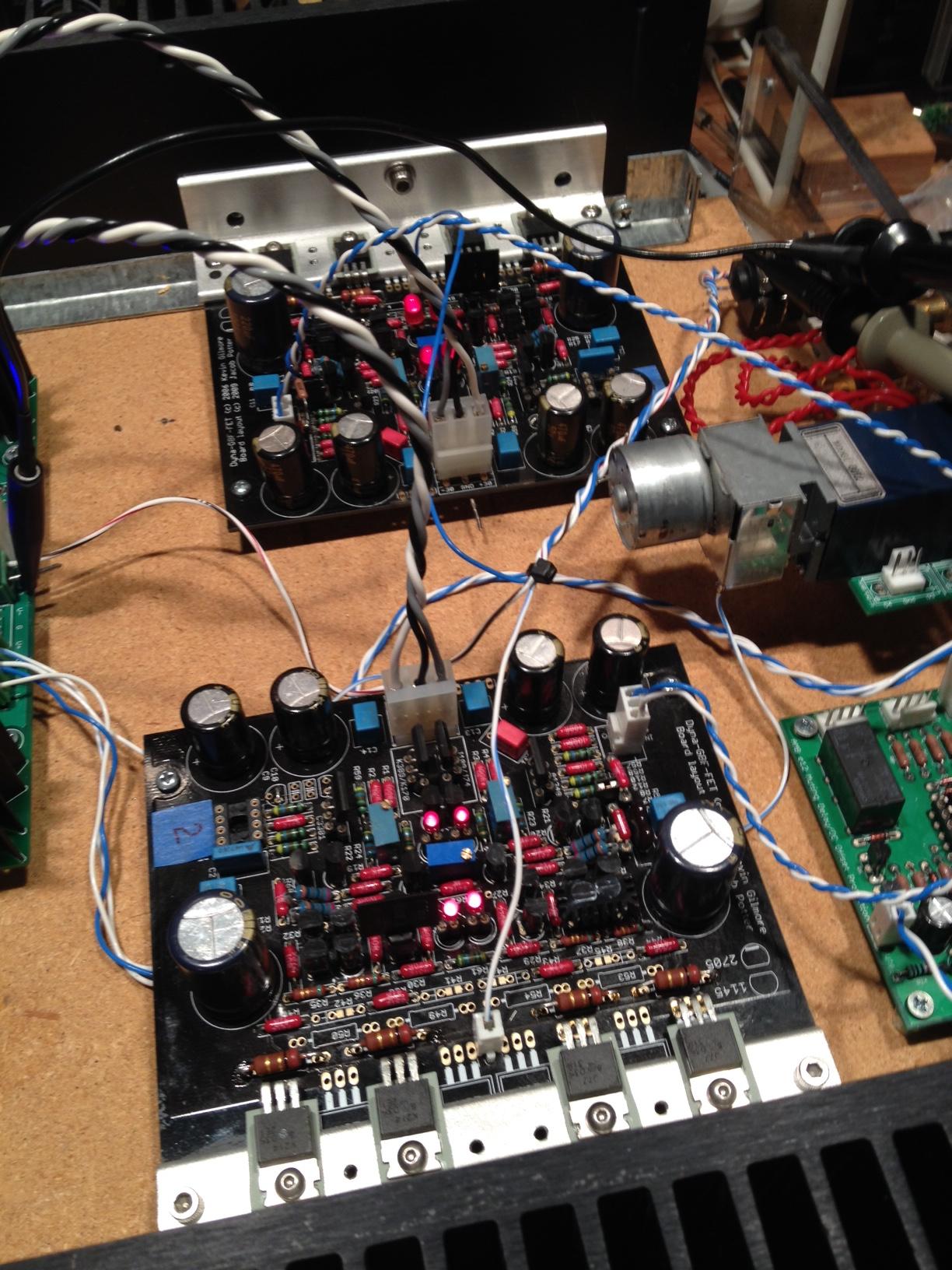

Pars Posted February 27, 2017 Report Posted February 27, 2017 Of course the 2nd board was too good to be true. Put the 2nd pair of outputs in, oscillating to beat hell now without volume up, nothing plugged in. 70+MHz (0.7 div @ 0.2us/div). Board was acting strange even before I powered it (wasn't even plugged into AC). When I put the scope probe on the R output, it showed some fuzz on the trace. Board was plugged into all I/O. Strange. When powered, the oscillation was independent of volume setting, and with no phones plugged in. Varied at times by just approaching the bench, moving hands, etc. Fun. I'm going to try Cordell's zobels on this one first. Probably use some 100pf Wima FKPs I have with 90.9R or 120 or 150 ohms to gnd. Or I have some 33pf Mica caps. Also had noticed that I hadn't gotten the devices all the way onto the angle brackets (drilled like my dynahi ones), and recalled getting pissed at not being able to accurately hit a good center punch (Starrett) dimple with my drill press, so bought some cheap center bits from Harbor Freight. Redrilled the angle bracket for the good channel. Much better. I'll redo the other one presently. Also discovered my load box is broken; Lorlin rotary switch wasn't working correctly. Quote

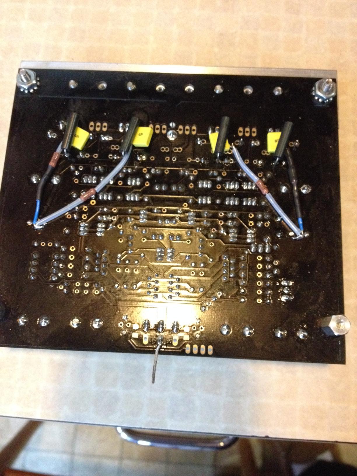

Pars Posted February 28, 2017 Report Posted February 28, 2017 Put in the zobels (100pf-90.9R) in which seemed to cure this problem. I haven't done much testing yet, but didn't find any oscillation. Hard to find any ground points close by on the bottom (gnd plane is on top). Closest is about 2". Put the cap right on the gate pin. Resistor and teflon tubing later (x4) and done. That is the only change (other than Vbe multiplier resistor values) that I've done to this board from std. config. 1 Quote

Pars Posted March 1, 2017 Report Posted March 1, 2017 Put a toggle switch in the load box (33/330) and ran RMAA on the #2 board (Cordell gate zobels only). Still looks good. I had a scope on the outputs and saw a touch of oscillation when I first fired it up. None after. So the 3 "cures" for the oscillation that I have found: Ferrite beads Cordell gate zobels Amb output zobels Board #1 has the ferrite beads. #2 has the Cordell zobels. I think I will put the beads on #2 also and the zobels on #1 and be done. Dynafet2_33_3.pdf Dynafet2_330_4.pdf 2 Quote

Pars Posted March 5, 2017 Report Posted March 5, 2017 Got both boards up and running with mods 1 and 2 above. Ran RMAA on it at 150mA, 100mA and 75mA bias. I think 150mA is probably the best. See what any of you think of the plots attached. Also brought my T50RPs down and listened to some tracks on it. I think this may be my favorite amp! I'll have to do more listening though. Dynafet_both_75_330L.pdf Dynafet_both_150_330L.pdf Dynafet_both_150_33L.pdf 7 Quote
