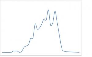

luvdunhill Posted June 15, 2009 Author Report Posted June 15, 2009 This graph is worthless without the compliment devices, but ... Quote

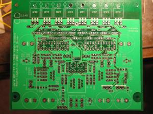

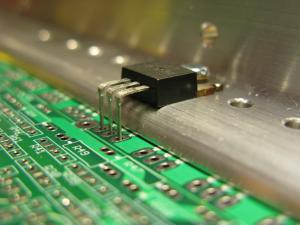

luvdunhill Posted June 17, 2009 Author Report Posted June 17, 2009 (edited) well, I have the boards and have started working with one and getting the other ready to send to Kevin. Not an easy board to stuff so far... A few initial suggestions, in random order: 1.) The silk is sort of messed up in places. Kinda like printing on a bad ribbon, for those that remember those days, it's offset at points. I'm assuming this is an issue with the fab, not the files? 2.) The output transistors I think could be better labeled using "2SJ" and "2SK" rather than Q27-Q34. I'd remove that A17,5mm text as well (whatever that means). 3.) The top ground plan extends too far and will be under my aluminum angle, which I'm uncomfortable about. I'm not sure if this will be the case for everyone, but I'd like to move back the ground plane to the most northern edge of the pads. This will cause some of the ground plane in the middle of the output devices to be unconnected and thus removed, but this is okay. 4.) The "1145 / 2705" legend will be partially hidden by the bracket. I'd move it down a bit. Also, perhaps another legend would be more appropriate, as there are four transistors in the middle that are at a 90 degree angle and have no reference designators that I need to track down on the board files to see what polarity they are... maybe add a dot to all the 2SA devices right above the center pin? That way you could accommodate the mystery devices in the middle of the board that are currently at a 90 degree angle from your legend. 5.) If at all possible, there needs to be more room around the output resistors. Especially between R53,R54,R49,R50 and the row below it (R44,R46,..). The bodies on these three rows of resistors practically touch. Any more room would be greatly appreciated. Looking at the layout, you can create some more room at the bottom quite easily. Move the JFETs toward the power connector and move the regulators around a bit and move up R57,R58, etc. You get the idea. More room between the first row and second row of the output resistors, as well as more room between the second row of the output resistors and the R44,R46... row. I think we definitely need to do this. 6.) R33 and R32 actually touch the caps. These should be moved out a bit, you have plenty of room. 7.) On most the caps, I'd remove the "A" and "B" nomenclatures. It gets confusing. Less text is better. Also, I'd remove the smaller silk screen and just keep the larger outline on C11B, C12B, C13A, (and the unnamed capacitor to the right of the power connector), C32B, etc. It's clear enough with the single large outline with the four pads inside and helps the silk look less busy. 8.) The resistor between R28 and R32 has no printed reference designator, that I could find. 9.) On C1B, the south hole could be enlarged a tiny bit, as I cannot quite fit my capacitor in there. I can give the component dimensions, but my guess is as large as the IN connector holes would be great. While everything fits, it is tight in there. I'd move C11B to the left a bit and then C1B to the left as well, since currently everything touches. *10.) In my opinion, the resistor foot print is just too small. I know it will be hard to enlarge it, but I think a lot of people aren't going to like the fact that you have to slam the leads against the body and then the ring gauge on the board is so darn small. I realize it's work to fix this, but I think it will be worth it, as it's very, very tight. I'm just preempting Pars complain on this matter I dunno what to say... it's very, very tight. 11.) I'd add a silk layer to the bottom to explain the rather clever jumpering system and a note to the top of the board explaining that the bottom jumper must be populated. I didn't even notice it myself until I looked at the EAGLE files. 12.) For the four 7zip patterns, I think this will be confusing to stuff, since we're using the small device heat sinks. I know mistakes will be made and people will have to consult the data sheets as is. See attached image for what I'd recommend to do here for the silk. 13.) Depending on the connector you want to use for the 4 pin SIP to the left of the power connector, I'd recommend putting a bit more space between here and the cap. For example, you might want to use a Molex KK connector that has the retention clip, and currently it wouldn't fit. 14.) For the two regulators, I'd use the TO-92 silk pattern. Since the higher voltage parts aren't available in TO-220, I think we should just use this pattern and emphasize this on the silk. The polarity needs to be marked somehow as well. Ok, more tonite after I finish stuffing the boards. Simply a gorgeous design, by the way... hats off! Edited June 17, 2009 by luvdunhill Quote

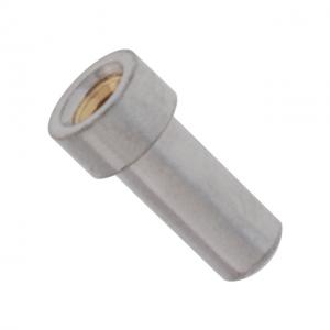

luvdunhill Posted June 17, 2009 Author Report Posted June 17, 2009 I would like to use these I'll check tonite, but these should fit fine for the 7zip packages. Would that suffice? Mouser 575-410322010 Quote
Pars Posted June 17, 2009 Report Posted June 17, 2009 (edited) I have some of those (28 pin) and yes they work. The flush pin sockets are much slicker, however They do require drilling (a slight bit) and are dependent on the pads/holes being of sufficient size that you don't go through the thru plating. Not a biggie, but if they will work, I would use them, even for singles. I used these for my work dynalo for all transistors, and it worked out really nice. Edited June 17, 2009 by Pars Quote
luvdunhill Posted June 17, 2009 Author Report Posted June 17, 2009 I have some of those (28 pin) and yes they work. The flush pin sockets are much slicker, however They do require drilling (a slight bit) and are dependent on the pads/holes being of sufficient sizer that you dont; go through the thru plating. Not a biggie, but if they will work, I would use them, even for singles. I used these for my work dynalo for all transistors, and it worked out really nice. eh, you lost me after the drill part Quote
Pars Posted June 17, 2009 Report Posted June 17, 2009 The normal pad/hole size is not big enough for the flush sockets, so I had to drill them out slightly (on the Dynalo board). I have a pretty full set of carbide PCB drills Quote
digger945 Posted June 18, 2009 Report Posted June 18, 2009 I've never tried some of the Mill-Max products you gave a link to, tried some Mill-Mas inline(8 pin, 32 pin, etc. sip package) type ones and the holes in the pin sockets were never big enough to put the leads into, or at least anything I was using at the time. I finally settled on the Molex 64 pin ones, cutting the plastic away leaving just the pin to solder into the board. They do stand a bit proud of the pcb, but only the largest leads are too big to fit into the receptacle. They have a nice positive lock when the lead seats into the socket, making it hard to mistake if you have the lead in far enough. I think the Mouser part is 315-93-164-41-003000 Easy to use, just give one side of the plastic a nip with your cutter and the hatch right out. Thanks for the update Marc. Having poured over the pbc images for weeks myself I know it can demand a fair amount of attention and get tiring quickly. Look forward to some pics. EDIT:The link is for a Mill-Max part, I can't find the Molex and Tyco parts I used right now, maybe tomorrow. Quote

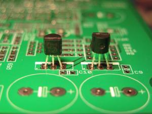

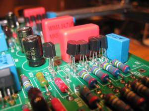

luvdunhill Posted June 18, 2009 Author Report Posted June 18, 2009 A few pics that illustrate some of my points above: Quote
j4cbo Posted June 18, 2009 Report Posted June 18, 2009 1.) The silk is sort of messed up in places. Kinda like printing on a bad ribbon, for those that remember those days, it's offset at points. I'm assuming this is an issue with the fab, not the files? That does look like a fab problem. I'm surprised; PCBFabExpress has done better with the other boards I've ordered from them. Might be worth contacting them to see what's up. 2.) The output transistors I think could be better labeled using "2SJ" and "2SK" rather than Q27-Q34. I'd remove that A17,5mm text as well (whatever that means). Will do. 3.) The top ground plan extends too far and will be under my aluminum angle, which I'm uncomfortable about. I'm not sure if this will be the case for everyone, but I'd like to move back the ground plane to the most northern edge of the pads. This will cause some of the ground plane in the middle of the output devices to be unconnected and thus removed, but this is okay. Looking at it, yeah, that should be no problem to change. 4.) The "1145 / 2705" legend will be partially hidden by the bracket. I'd move it down a bit. Also, perhaps another legend would be more appropriate, as there are four transistors in the middle that are at a 90 degree angle and have no reference designators that I need to track down on the board files to see what polarity they are... maybe add a dot to all the 2SA devices right above the center pin? That way you could accommodate the mystery devices in the middle of the board that are currently at a 90 degree angle from your legend. I've actually got a more compact TO-92 layout that I think I'll try to switch to (it's used in my custom layout for my own builds, here). Hopefully that will allow making all the devices face the same two directions. 5.) If at all possible, there needs to be more room around the output resistors. Especially between R53,R54,R49,R50 and the row below it (R44,R46,..). The bodies on these three rows of resistors practically touch. Any more room would be greatly appreciated. Looking at the layout, you can create some more room at the bottom quite easily. Move the JFETs toward the power connector and move the regulators around a bit and move up R57,R58, etc. You get the idea. More room between the first row and second row of the output resistors, as well as more room between the second row of the output resistors and the R44,R46... row. I think we definitely need to do this. I'll see what I can do, but I'm not too worried about the positioning now... they're staggered, so heat shouldn't be too much of an issue, and the actual terminations are well-spaced. 6.) R33 and R32 actually touch the caps. These should be moved out a bit, you have plenty of room. 7.) On most the caps, I'd remove the "A" and "B" nomenclatures. It gets confusing. Less text is better. Also, I'd remove the smaller silk screen and just keep the larger outline on C11B, C12B, C13A, (and the unnamed capacitor to the right of the power connector), C32B, etc. It's clear enough with the single large outline with the four pads inside and helps the silk look less busy. Will do. 8.) The resistor between R28 and R32 has no printed reference designator, that I could find. Whoops, that's R31. Not sure how it got unlabeled. 9.) On C1B, the south hole could be enlarged a tiny bit, as I cannot quite fit my capacitor in there. I can give the component dimensions, but my guess is as large as the IN connector holes would be great. While everything fits, it is tight in there. I'd move C11B to the left a bit and then C1B to the left as well, since currently everything touches. Will do. *10.) In my opinion, the resistor foot print is just too small. I know it will be hard to enlarge it, but I think a lot of people aren't going to like the fact that you have to slam the leads against the body and then the ring gauge on the board is so darn small. I realize it's work to fix this, but I think it will be worth it, as it's very, very tight. I'm just preempting Pars complain on this matter I dunno what to say... it's very, very tight. I don't think there are any spots that immediately preclude enlarging the outer pads on the resistor footprint, actually. I'll see what I can do there. 11.) I'd add a silk layer to the bottom to explain the rather clever jumpering system and a note to the top of the board explaining that the bottom jumper must be populated. I didn't even notice it myself until I looked at the EAGLE files. Adding silkscreen on the bottom will increase the cost a bit. Maybe just put a label in copper and then a little more explanation on top? 12.) For the four 7zip patterns, I think this will be confusing to stuff, since we're using the small device heat sinks. I know mistakes will be made and people will have to consult the data sheets as is. See attached image for what I'd recommend to do here for the silk. That looks great. 13.) Depending on the connector you want to use for the 4 pin SIP to the left of the power connector, I'd recommend putting a bit more space between here and the cap. For example, you might want to use a Molex KK connector that has the retention clip, and currently it wouldn't fit. 14.) For the two regulators, I'd use the TO-92 silk pattern. Since the higher voltage parts aren't available in TO-220, I think we should just use this pattern and emphasize this on the silk. The polarity needs to be marked somehow as well. Will do. Let me know what else you find. Ok, more tonite after I finish stuffing the boards. Simply a gorgeous design, by the way... hats off! Thanks! I want more photos once it's all stuffed Quote

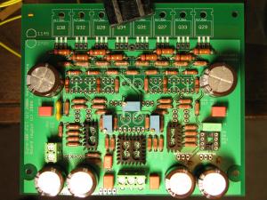

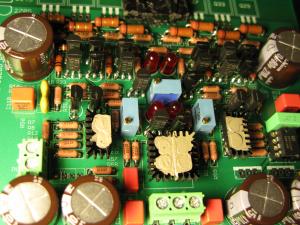

luvdunhill Posted June 20, 2009 Author Report Posted June 20, 2009 Gotta head out, and will be busy until tomorrow night Maybe I can get another set of eyes to double check the transistors? I'm most worried about the orientation of the 2SC3381/2SA1349 and JFET "singles". I double checked it, but you never know. From top to bottom, left to right I have: JJJJ KKKK (not populated yet) ACC CAC ACA AAC AC CC AA AC AA JJ KK CC ... and pics to show orientation of the "duals"... zoom all the way when you view the pic, as the light made things hard to capture, and seems to make it look like there are some flaws in the dual assembly, which are pretty much smooth when looked at straight on... oh well, just a bit self conscious I guess Tomorrow I need to jumper the regs, jumper the feedback and install the MOSFETs. Then have to bolt my sigma22 to the heat sink and get things ready to flip the switch. I'll probably load test the sigma22 first, assuming I can find enough power resistors around here. Quote

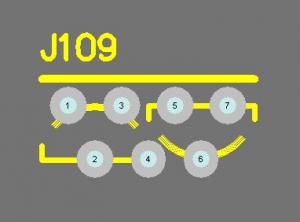

luvdunhill Posted June 20, 2009 Author Report Posted June 20, 2009 ok Jacob, everything fits. No need to move the JFETs, they are perfect. Still need to double check the orientation of the TO-92 parts, but it will have to wait until tonite, unless someone else can look. The jumpering for the regs is a bit annoying (pin 1 to 3 on one and pin 1 and 2 on the other), and given how slick the feedback jumper is, could a similar SMD jumper be added to the bottom of the board for the regulators? Quote
digger945 Posted June 20, 2009 Report Posted June 20, 2009 The inputs and CCS's are good, checking the buffers and others now. Quote
digger945 Posted June 20, 2009 Report Posted June 20, 2009 You have a 20k pot parallel to the 681 ohm for the negative rail bias adjust(the trimmer on the left in your pic). What value is the one in the middle that we can't see. It should be the 20k for Vbe multiplier adjustment. Looks like the one on the right is 10k, as it should be. I'm still looking, slow as it is. I like your solder, care to share what brand it is. Quote
