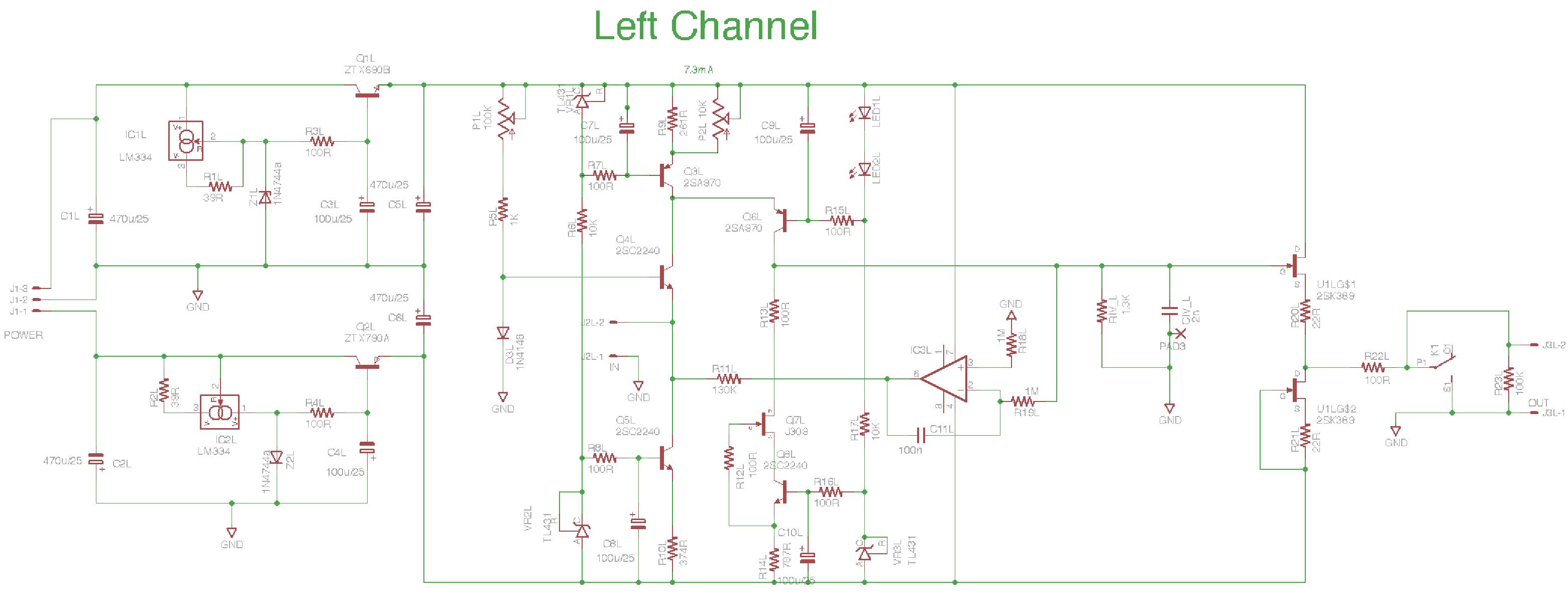

Pars Posted January 25, 2009 Report Posted January 25, 2009 Talking to myself again Colin (or Marc or anyone who has an opinion on this): In the I/V stage that I am using, I had used 2SA970/2SC2240 BJTs since they are quite neutral. I have read some threads that said that 2SA1016/2SC2362 sound quite a bit better, so I went ahead and got some. Can I just leave the existing BJTs in the CCS stages, or should I switch them all out? In the attached schematic, only Q4L and Q6L are in the signal path. All other devices are CCS. I think... Sorry to the OP for thread redirection Quote
