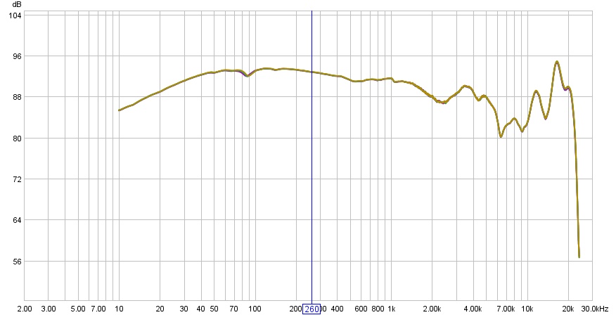

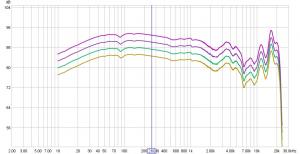

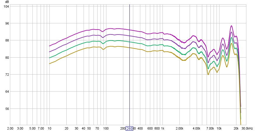

Dreadhead Posted December 16, 2008 Report Posted December 16, 2008 Well I just got done doing tests on the HD650 using my ECM8000 measurement mic and dummy head and room EQ Wizard (that some of you have seen). I kept the mic and headphones in the same spot and tried the following: HD 650 running Balanced from the GS-X (of DAC3 Balanced)HD 650 running SE from the GS-X (of DAC3 Balanced)HD 650 running SE from AE-2 plugged in with wall wart(off DAC3 SE)HD 650 running SE from AE-2 running off battery (off DAC3 SE) I attempted to volume match all 4 configurations but ended up having about .3 db (at 1kHz) variation that I could take out using the software so they all have the same value at 1kHz. Attached are the frequency response curves for the four configurations. The second one has a vertical separation introduced so you can see that there are different curves. Amazingly Identical. The most difference I can find is on the order of less than 1db. Quote

recstar24 Posted December 16, 2008 Report Posted December 16, 2008 Awesome. Thanks for sharing. I do not have much experience with balanced drive, other than 15 minute auditions at meets. The past chicago meet I was in love with the HP1000 APS balanced from the TTVJ 307a. Probably the best I have ever heard them. I would attribute that more to the 307a and the APC cabling than the balanced part. Quote

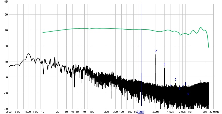

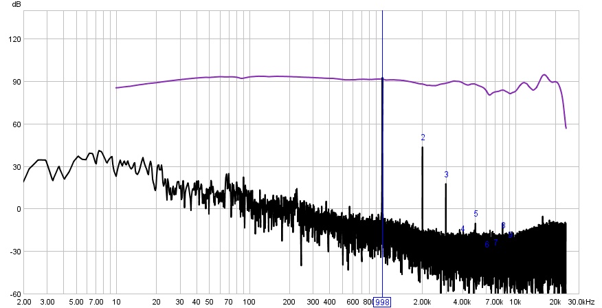

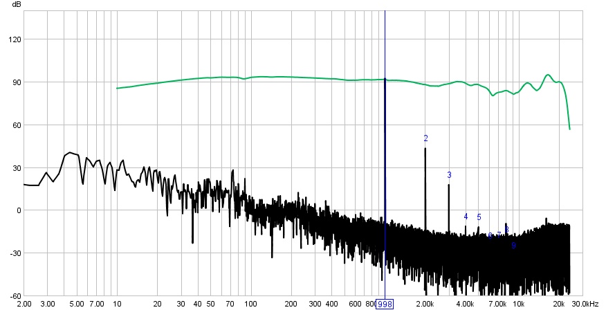

Dreadhead Posted December 16, 2008 Author Report Posted December 16, 2008 Here are the THD results for a 997.6 signal for cases 1,2,3 in that order. the two SE cases it's 0.347% and for case 1 it's .351% Quote

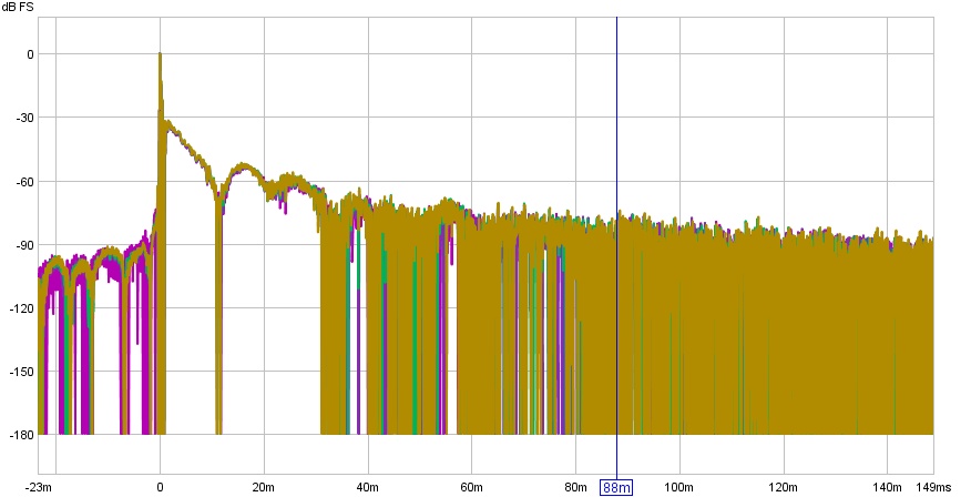

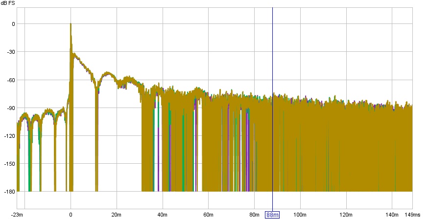

Dreadhead Posted December 16, 2008 Author Report Posted December 16, 2008 Unfortunately not doing this with an AP system so don't have those curves. I do have the impulse responses and I'm plotting those as we speak: The first attached is the Impulse response for all 3 versions where the phones are being driven SE. The last if for all 4 and you can see that the response is slightly different for the Balanced line (the line that's been added). I should add the differences are at such low amplitudes I can't say they are trustworthy though they are repeatable. Quote

Dreadhead Posted December 17, 2008 Author Report Posted December 17, 2008 It only misses the point if the only thing impacting how headphones sound is frequency response. Grawk, Actually I plotted the IRF which is both frequency and phase response and that's all sound is. They are identical. From my understanding control is the ability to deal with the resonances of the phones and that appears to be the same or they would show up in the frequency respons. The IRF is not a static graph by any stretch of the imagination. I'll be honest and say I was very very suprised by these results and I'm trying to figure out another test but I can't see one right now. Quote

Dreadhead Posted December 17, 2008 Author Report Posted December 17, 2008 Very interesting Dreadhead. To support your findings, I paste here the measurements we got using a calibrated Earthworks cardioid placed into a dummy ear...... snip Torpedo, Thanks for the measurements. I'll have to look around more. The software I have computes the the harmonic distortions as well but I didn't want to type all of them in. I only checked at the 500 Hz that Stereophile usually uses and at 1000 but I can do it at any frequency. It's just not as organized as your friends and I can't get much above around 11-12kHz because the harmonics are above my allowed maximum of 24kHz (the software only supports 48kHz sampling). If lower THD is what you get that sounds good to me I'll take a look tonight. Quote

Dreadhead Posted December 17, 2008 Author Report Posted December 17, 2008 He also measured impulse response and energy storage-liberation, but those measurements were virtually identical in both modes...... Yeah that's my finding too. The software I'm using is Room EQ Wizard (freeware) and it does everything using a sweep and impulse. Using 4 sweeps and impulses etc it takes over a minute to generate one curve. The THD calculation is done separately but within the same software. I'm using a Edirol FA-66 and a Behringer ECM8000 measurement mic with and have the calibration curve for the mic as done by a lab and posted on the REQ website. Are you sure you didn't move your headphones at all in the balanced/unbalanced comparison, I thought I saw those curves before and that you had switched cables at the headphone. I used an adapter specifically so that I could avoid touching the headphones at all, because my experience is that if I move the headphones a little bit it makes a sometimes order 1dB changes to the response I measure out the other end. Quote
