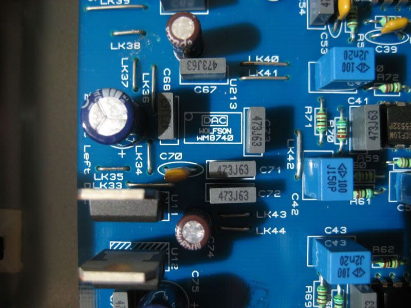

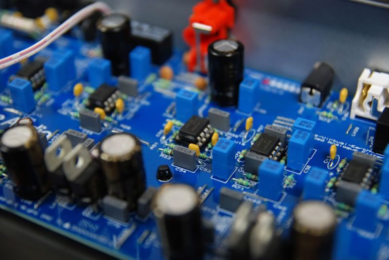

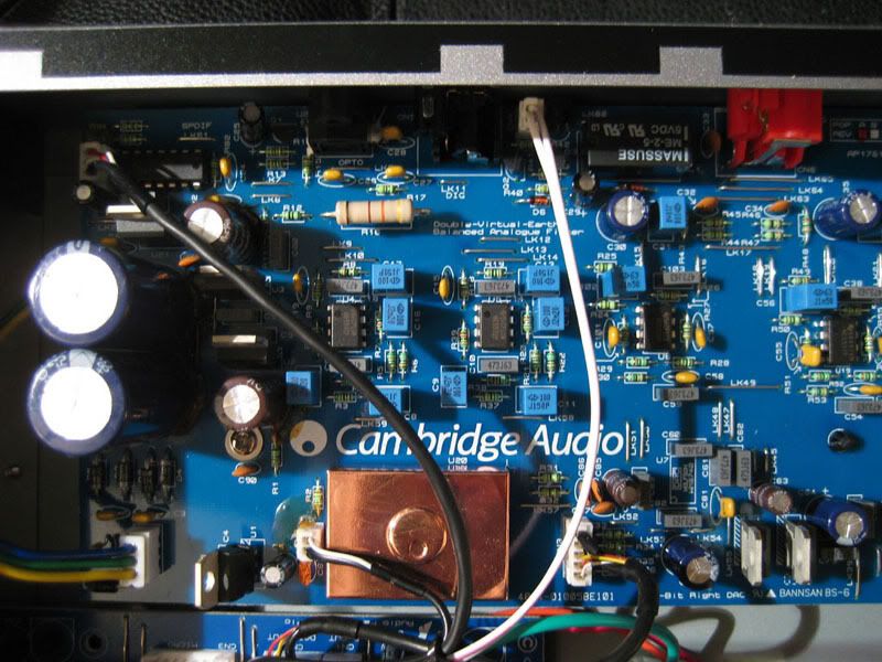

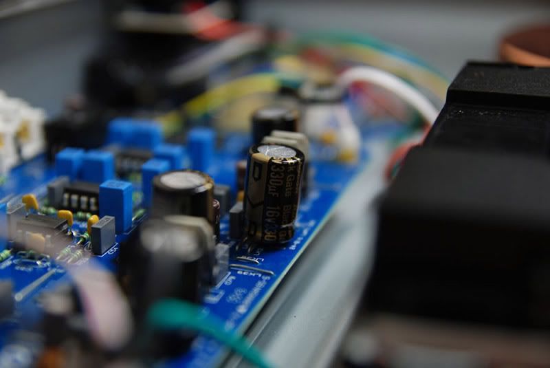

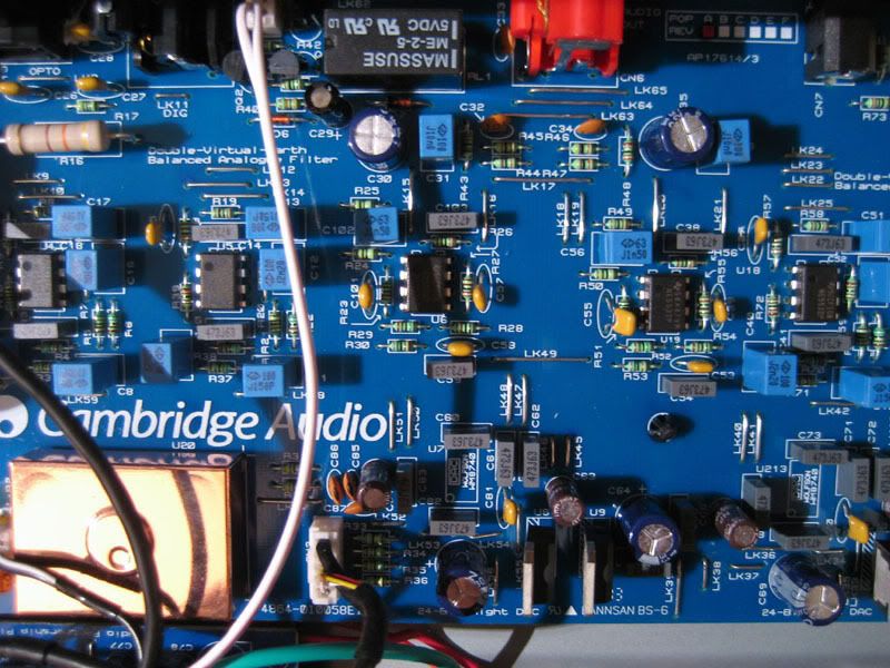

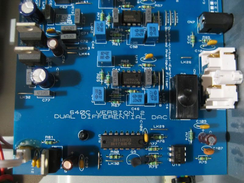

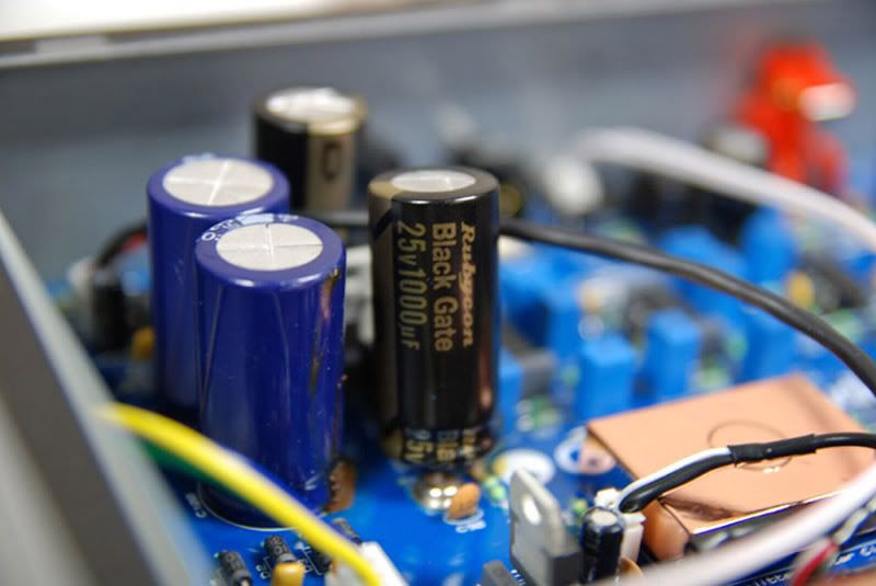

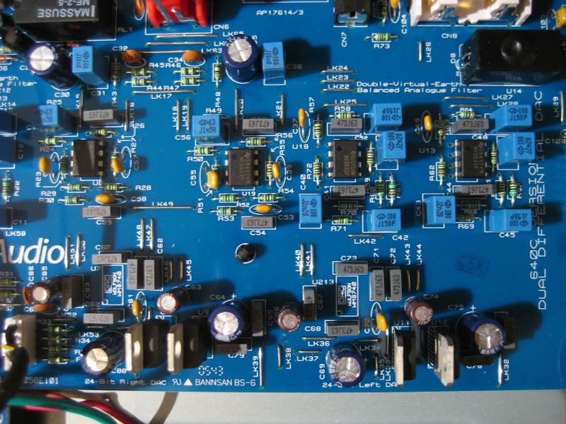

Mods to the CDP included:
- caps on main power, secondary, filter input, filter output, and de-coupling rolled to Rubycon Black Gates (not sure what was in place before)
- 5 filter op-amps socketed and rolled to National LME49720 (from stock TI NE5532)
- WIMA 0.1uF C0G cap inserted across the rails

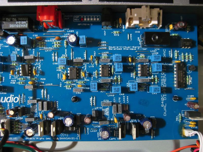

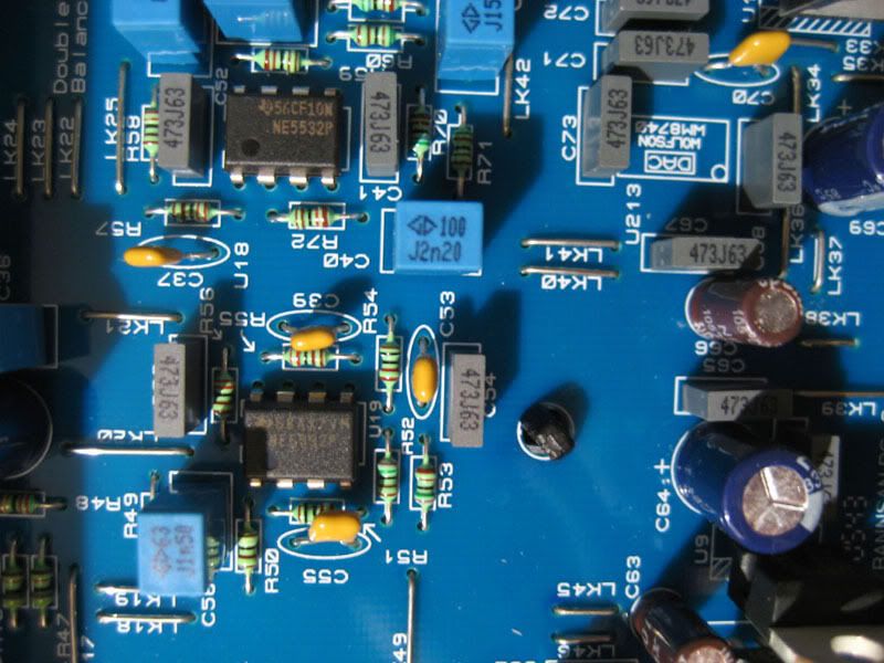

Before: (click for larger)
th_640ci_1.jpg th_640ci_2.jpg th_640ci_3.jpg th_640ci_4.jpg th_640ci_5.jpg th_640ci_6.jpg th_640ci_7.jpg th_640ci_8.jpg

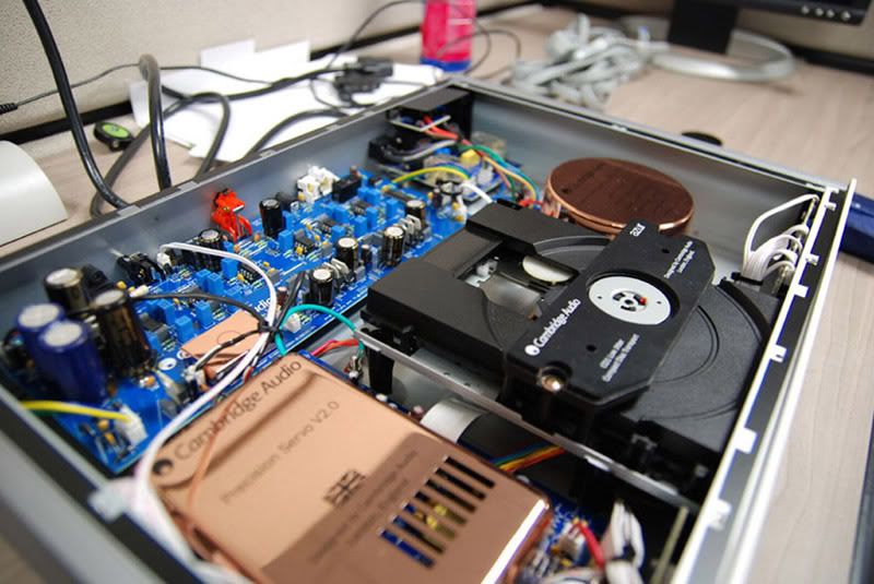

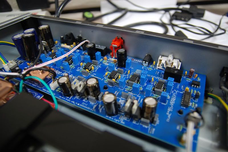

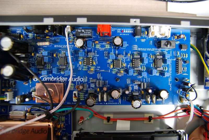

After: (click for larger)
th_640m_1.jpg th_640m_2.jpg th_640m_3.jpg th_640m_4.jpg th_640m_5.jpg th_640m_6.jpg
