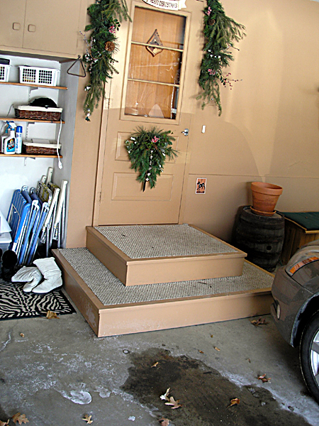

Pars Posted August 30, 2008 Report Posted August 30, 2008 I figured some of you do enough of this that it might be worth asking here. I need to rebuild the steps going into our house from the garage and would like to do some similar to the ones a friend has in his house. These appear to be box steps? Any ideas as to where I could find some plans for something similar to these? Thanks, Chris
swt61 Posted August 30, 2008 Report Posted August 30, 2008 Not sure about plans, but the good news is they're very simple to build. Ideally you'd like the rise of each step to be 7", and the tread to be 11". You can adjust those measurements to work with the total height you need, but stay close to them. Basically you're going to use 2 x 8 lumber to build your boxes. One box per step of coarse, and each box will be 22" narrower and 11" less deep than the one below it. You'll just construct a basic 4 sided box from the 2 x 8s, and use joist in between to strengthen the structure. Let's say you're going to build a two step box as in the pic you posted. Your top box will want to be the width of the door or wider. You can decide on the depth, but if you want a landing on top as pictured keep it relatively square in shape. Let's say for the sake of our conversation that the top landing is 3' x 3'. You'll want to cut two pieces of 2 x 8 to 3' length, and 3 pieces of 2 x 8 to 2' 9" in length. Then attach the three shorter pieces to the 3' pieces as shown... Making sure to attach the shorter outside pieces inside the longer 3' pieces. This will result in a 3' x 3' square box. Simply repeat this procedure for the step below, but make the next step 22" wider and 11" deeper. In this case that would be 58" wide x 47" deep. this will give you a tread width of 11" all the way around the three sides of the step. I'd add one more joist for a total of four on this box as well for added sturdiness. Once you have all the boxes built simply cut 3/4" plywood to the top dimension of each box and nail or screw the plywood on top of each box, making sure to mark your inside joist, so that you can see where to nail to these as well. The boxes can be joined with nails from underneath. Simply nail from the bottom of the plywood top into the joist of the smaller box on top. If you want them to be decorative like the steps in your pic you can add a layer of 1 x 8 Oak boards around the perimeter of each box. Mitered corners will look best here. Then use carpet or vinyl flooring to cover the plywood.

Pars Posted August 30, 2008 Author Report Posted August 30, 2008 Thanks all. Unfortunately, I don't have a table saw, so ripping the 2 x 8s to 7" might be fun. All I have is a radial arm saw and a circular saw. Will Home Depot / Lowes, etc. do this for you? The door width to the edge of the brickmould is about 36". I don't really want the top step to be 3' deep... 2' would be more than deep enough. Also, if I wanted the left side to be a straight drop instead of a step, I assume I would make the boxes 11" x 11" delta between each step? The door height from the garage floor is about 21 3/4". so I guess 2 steps should do it? Thanks again, Chris
grawk Posted August 30, 2008 Report Posted August 30, 2008 radial arm saws are particularly good for ripping. You'll want to make each box 7 1/4" tall. Since it's your house, you can definitely make your box steps any size you want, but you'll want to have enough tread for each, so let that determine how deep you make the boxes.
