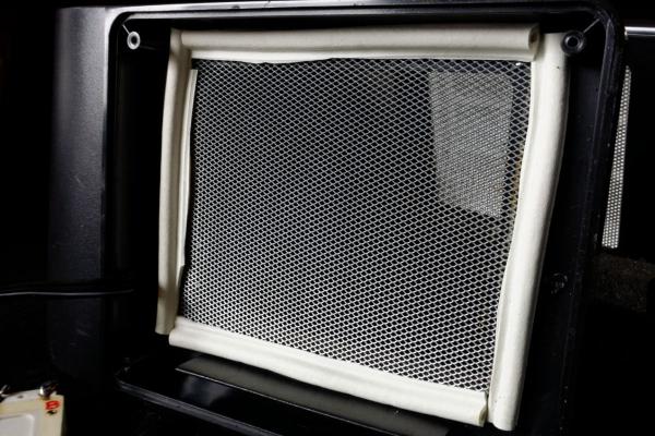

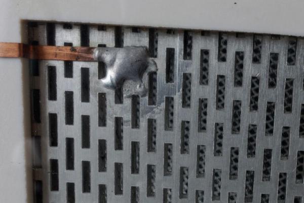

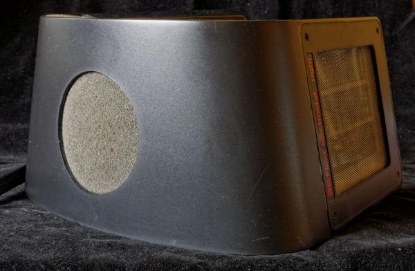

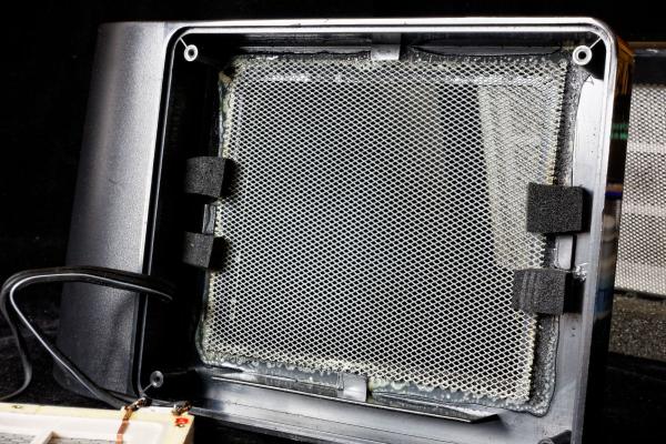

My "new" old way to look strange during listening to the music ... ;-)
I have also made some mod, it helps with the reproduction of lower bass.
It is nice that new set of foams is still produced, but still waiting for delivery.

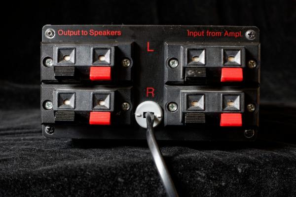

Energizer is model PS2 with four transformers inside.

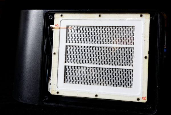

The whole driver is 9,32 mm thick and dimensions are 119x105 mm.
The window with visible stator is 74x85 mm.
The are dust covers, but different from those in Stax drivers. It is smooth and looks like mylar, but it is not. It is different plastic foil, very thin and delicate.
It is very easy to damage them.
