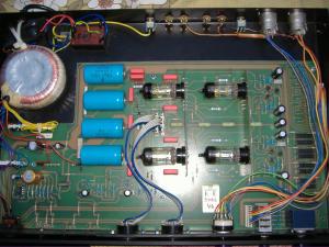

complin Posted January 11, 2012 Report Posted January 11, 2012 (edited) Not really even though my Icelandic always shines through. The amp is quite bad though, SRPP with ECC81's and a B+ of 900V. Well the PS2 Ergo Amp I've seen uses 4 x RTF ECC82 Valves East German Military spec and was manufactured by K&E in Germany On the front - it has controls for Volume, Balance, left/right, Reverse Phase, Stereo, Phase 180', Mono and Difference Two headphone sockets and peak lights for left an right On the reverse - Pair of balanced inputs, Two pairs of RCA inputs. Also two switches, one marked ground an the other which switches between symmetrical an asymmetrical? This is what it looks like inside Edited January 11, 2012 by complin Quote
spritzer Posted January 11, 2012 Author Report Posted January 11, 2012 I just checked my schematic and they did indeed use ECC82's. Not that it matters really since we are still dealing with a small signal tube with a max Va of 300V, driven way past its limits and asked to push what, 300pf? Pure madness... Also, that balanced input is really just single ended (notice the dual section 10K RK27 pot) and the input drivers are BC639. It's also fully AC-coupled. Quote
complin Posted January 11, 2012 Report Posted January 11, 2012 I just checked my schematic and they did indeed use ECC82's. Not that it matters really since we are still dealing with a small signal tube with a max Va of 300V, driven way past its limits and asked to push what, 300pf? Pure madness... Also, that balanced input is really just single ended (notice the dual section 10K RK27 pot) and the input drivers are BC639. It's also fully AC-coupled. Not sure why this is an issue because if i'm not mistaken Dr Gilmore also designed AC coupled electrostatic amplifiers using ECC82's (12AU7) ? Quote
spritzer Posted January 11, 2012 Author Report Posted January 11, 2012 No, that one uses ECC83's and only for the driver stage. They are run off a +300V supply so once you factor in the loss in the plate resistors the valves are well within their limits (they can indeed be run quite a bit harder than that). The output stage of the GES uses 6S4A's run off +600V. Quote
