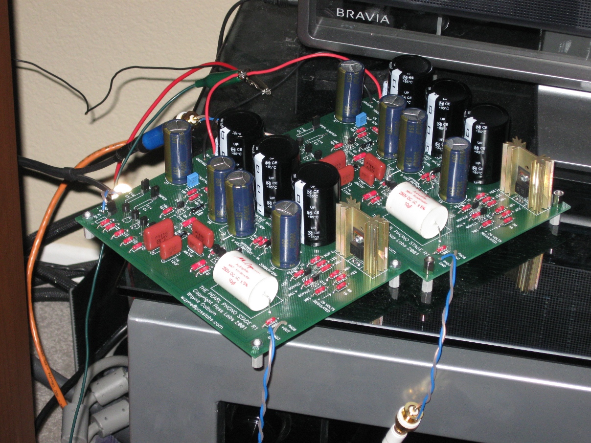

DigiPete Posted September 17, 2008 Report Posted September 17, 2008 The boards are WORKING!!! I'll post pics and readings later tonight Thanks to Marc for catching my error Quote

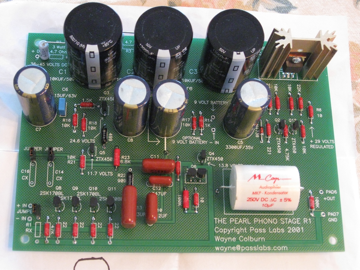

DigiPete Posted September 17, 2008 Report Posted September 17, 2008 I'm in "glad the boards aren't majorly f'ed up bliss" I did some more minor assembly on the boards, sent some measurements to Marc for his trannie matching. Everything looks good so far. One board has higher voltage coming out of the regulator and zener 29.36v at regulator output vs. 30.27v 9.17v at zener vs. 9.44v not sure if I need to mess with getting this tighter or not?? I don't think I will be able to listen to them before Friday though, just way too busy this week.... arghhh Quote

DigiPete Posted September 18, 2008 Report Posted September 18, 2008 Listening to the Pearl Phono right now Quote
DigiPete Posted September 18, 2008 Report Posted September 18, 2008 ..... lets get this out of the way, this thing kicks ass Compared to my Channel Islands Phono, from memory: Right off, deeper more authoritative and defined bass, but not bloated More resolving and faster, just more detail top to bottom. I can hear more details, even more groove noise, pops etc, recordings sound mo' different from one another, some duller, others just fantastic. The highs are accurate, extended, sweet, not overemphasized. The soundstage is wider and more depth as well. Sounded a bit congested the first hour or so but is improving rapidly, or was that a crappier album? Pup another newer album on and wow, everthing kicks! Still listening..... the voltage regs staying really cool Quote

DigiPete Posted September 18, 2008 Report Posted September 18, 2008 Currently running it uncased and running both channels with only one bridge rectifier and one big smoothing cap. I will let it break in for about 50 hours worth or record play, then do an A/B with the CIAudio then I will install the teflon bypass caps to see what I can hear. The gain seems a bit lower than the CIAudio which I think is set a 50 db. I would guess I'm getting around 40 db. Does this seem right Also this phono is dead quiet, turned up the receiver all the way.... no noise. Quote

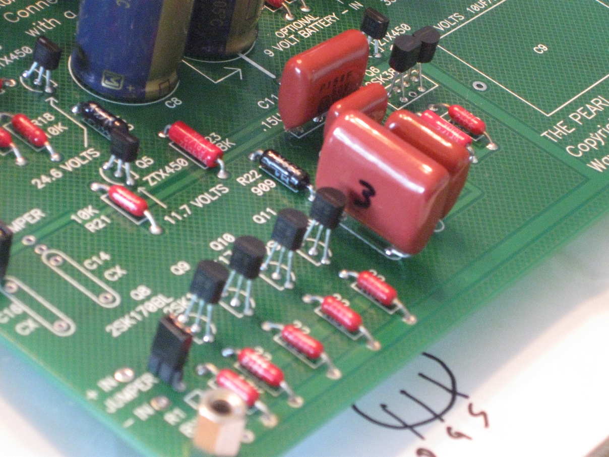

DigiPete Posted September 19, 2008 Report Posted September 19, 2008 Some more pics, now I need to get some enclosures... Quote
